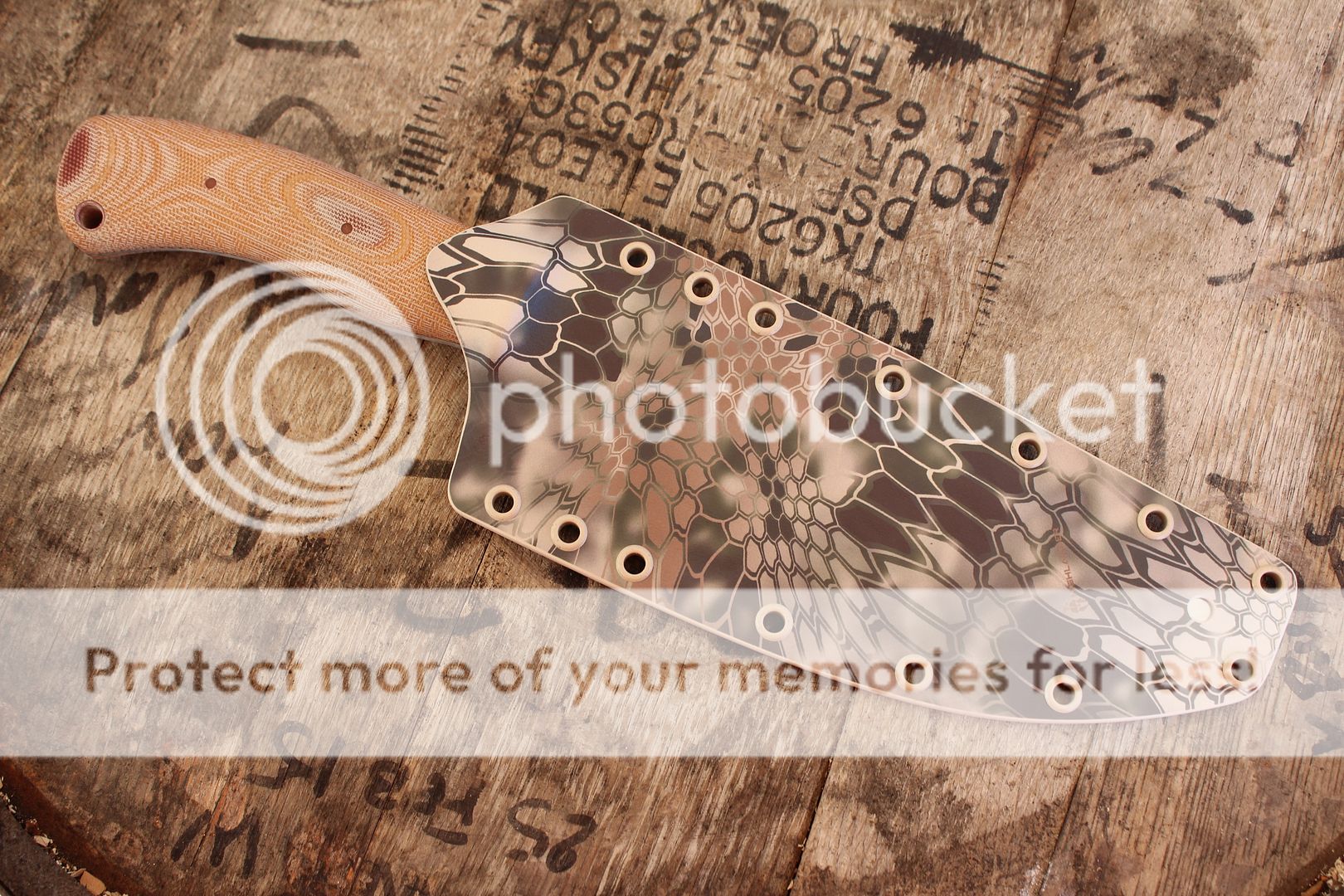

Specs:
.150" PSF 27
13.5" OAL
8.09" Blade
2.06 Tall at Plunge
High Flat Grind
Thin Blended Convex Edge
Heat Treat to 61 Rc with Sub-Zero Quench
Textured Flats
Tapered Tang
Natural Canvas Micarta SCales
Natural Paper Micarta Pins and Tube
Highlander Kryptek Camo Kydex
Large Tek-Lok Compatible
Asking $SOLD
Price includes shipping via USPS Priority Mail to all 50 states with delivery confirmation, others can contact for additional shipping charges
I accept Paypal, money order, or check. Paypal preferred to bigchriscustomknives@gmail.com.
First, "I'll take it," gets it.
Feel free to email any questions/comments to bigchriscustomknives@gmail.com.
Thanks for looking!

I like the height and room for the fingers, seems you can get a lot of use out of this thing. Cool sheath too, set that down in the wrong place and you'll loose it
