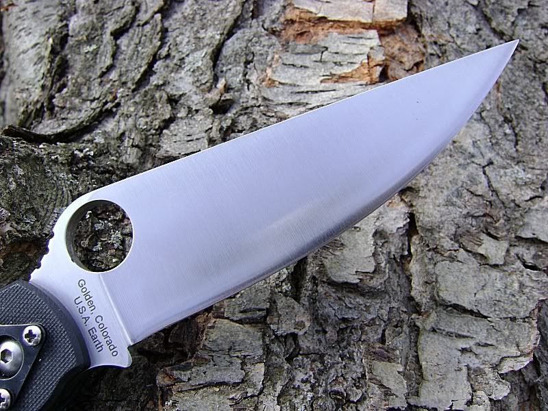

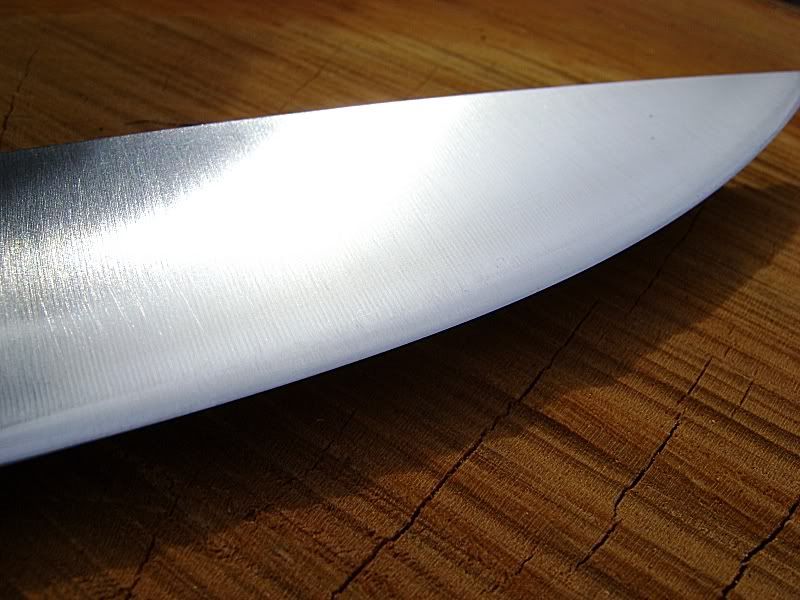

Nice polished edge. Nice point. Convexed edges seem to be the way to go. It would be nice for Spyderco to sell a convex sharpening system.

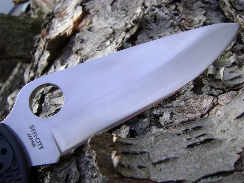

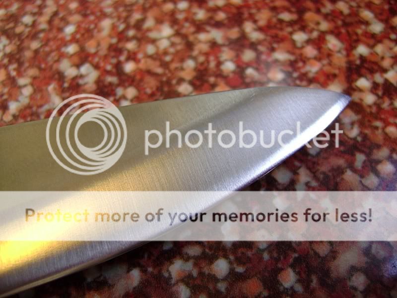

Here is the convexed Endura4 -

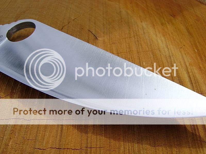

And the convexed Military -
I do sand down the flat grind a bit. It ensures a more smooth transition from the convex edge grind to the flat grind, thins out the edge a very tiny amount, and gives the whole knife a more even overall finish.
I start by knocking off the edge grind shoulders with a coarse diamond bench hone. Then I shape the convex edge with 200 grit adhesive backed SIC wet/dry paper, mounted to an old mouse pad. The Then I work myself up to 600 grit, 1200 grit, and then 2000 grit. Last, I use a leather strop mounted with either Herb's Yellowstone for less wear resistant steels, or Bark River black stropping compound for more wear resistant steels.
When I'm done with the Endura4, the blade should be completely convex from the edge to the secondary grind line. It will rock the house down. It will essentially be a full convex ground folder. I may even refinish the entire blade, as well as round the spine for more comfortable two-hand work.

That's a nice edge, Buzz. My Para looked like that the first time I worked it with my Harbor Freight belt sander. Then I decided I wanted to thin it more, and I made the mistake of doing it when I was tired and ended up with an uneven grind. The edge is definitely thinner - and a better cutter by far - but it will not win any beauty contests. That sander sure makes fast work of it - for better or for worse.
Nice pics of the convexing. That's how mine become after a while as well, start by knocking off the shoulder and then gradually convexing the edge every time it needs a touch up.
Edge seems just as durable and cuts better imho. Biggest difference is with the sabre ground spydies.
