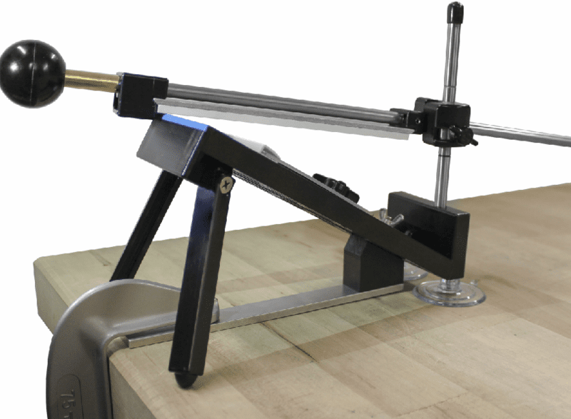

Who makes the best one?
I normally put an edge on my knife at something smaller than 40 degrees with my Edge Pro.
I then use my Spyderco Triangle Sharpmaker at the 40 degree setting to maintain and put a micro-bevel on the edge.
Doing this until I can't get a good edge with the Sharpmaker means it takes quite a while to again apex the edge past the micro-bevel with the Edge Pro.
I'd like to speed this up with a good/fast cutting diamond stone made for the Edge Pro.
Recommendations?
Thanks

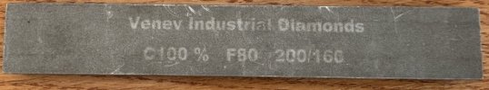

Ooh, that's an expensive stone.
Is there another type of stone that cuts faster than diamond?
Nothing cuts faster than diamond, however the type of stone or rather the construction can matter. The Venev stones listed above are resin bonded so the diamonds are embedded in a resin matrix, think like the chocolate chips in a cookie. Only a portion of the diamond is generally sticking out so may not cut quite as fast as an electroplated diamond for example, but they're still diamond so they don't exactly cut slow. Electroplated diamond stones cut faster (and are cheaper) because the diamonds are adhered to the top of the surface so they are more aggressive in cutting. However they don't last as long as a bonded stone. Once the diamonds wear out or get knocked off on an electroplated stone, that's it, whereas a bonded stone you can resurface them to expose more diamonds in the resin matrix. So depends on if you just want the fastest cutting or the longest lasting.

Like BMO already said, the diamond stones from EdgePro specific are a diamond matrix. They're nice. But if your primary goal is hogging off a lot of material quickly, you'll want a diamond plate where the diamonds adhere to the surface of the plate. I got a set of three cheap ones from ChefKnivesToGo. They're thin, so I glued them to some aluminum blanks. Don't be fooled just because the coarsest stone is 120 grit. These cut much faster than the EdgePro diamond matrix. I just checked, and now they come mounted to plastic blanks. They're still $27.50. It's a nice product at a nice price. You'll like them.
A lot of good suggestions here.
I've come to the conclusion that my method (using the Sharpmaker for frequent touchups)
results in having to remove more steel when I finally use the Edge Pro.
I now leave the Edge Pro set up so the exact angle is always assured.
The only minor hassle is that I have to tape the Sebenza's blade to prevent
scratching it every time I use the Edge Pro.
The upside is that it's a much faster process and I can get the edge screaming
sharp quickly, several times a week if need be.
