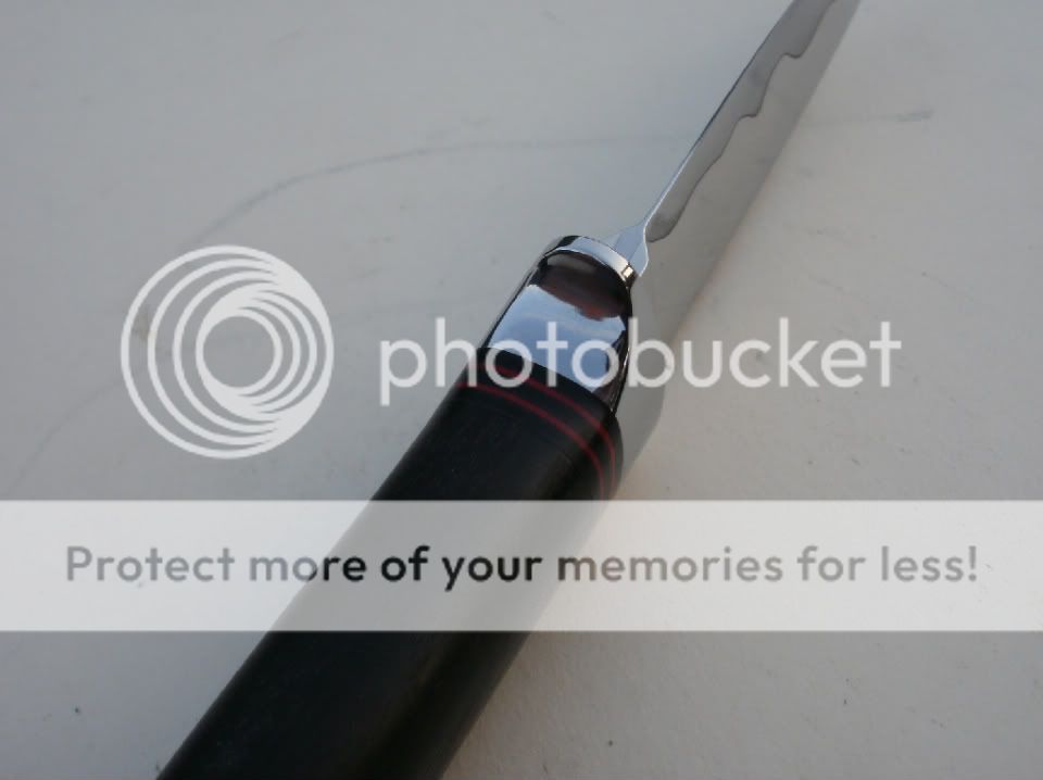

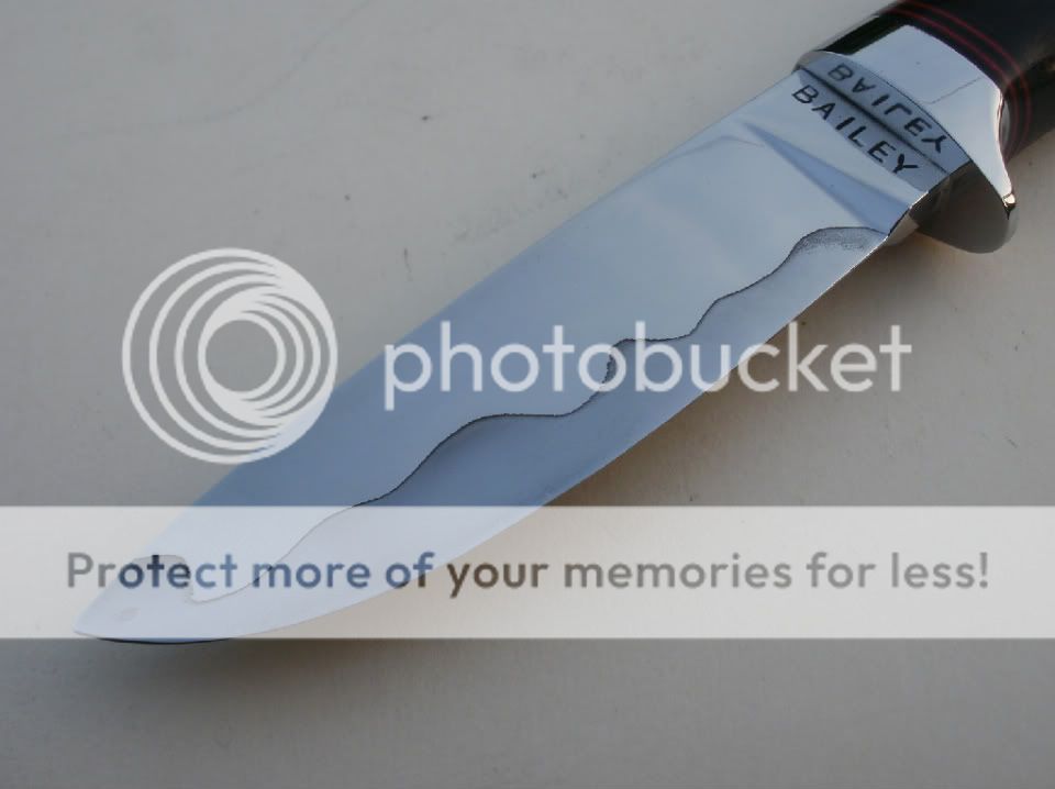

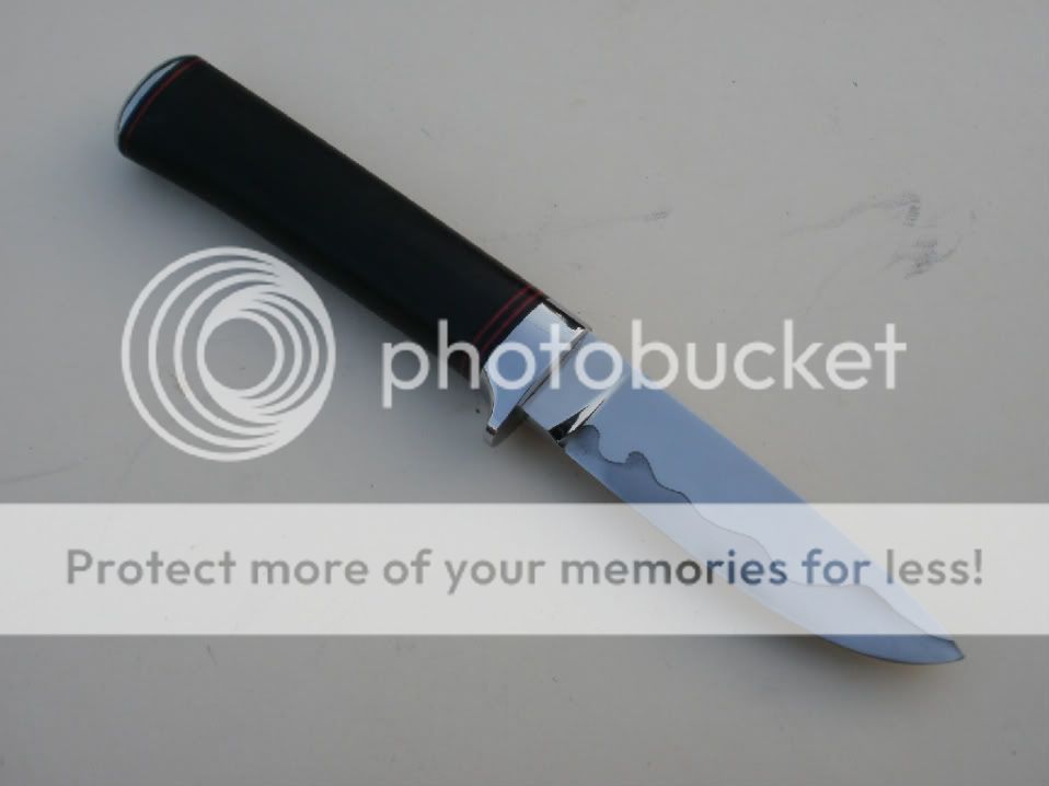

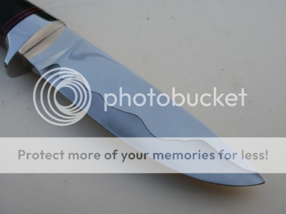

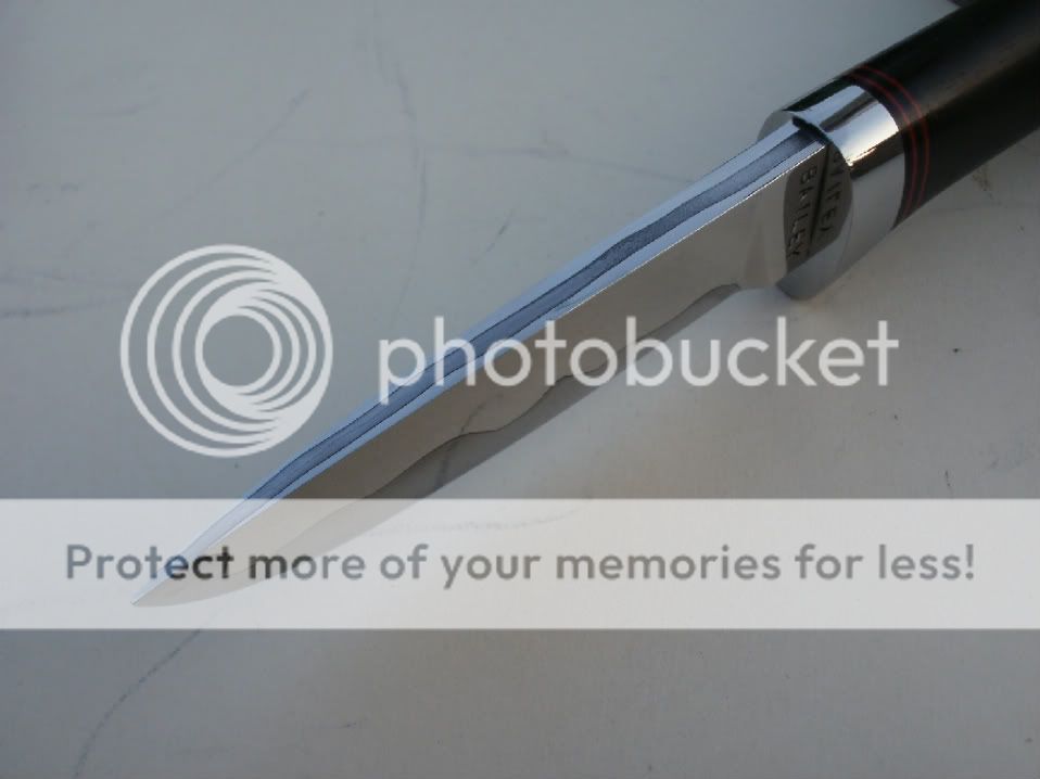

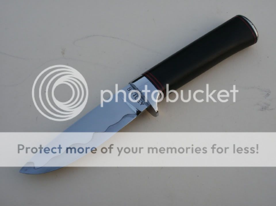

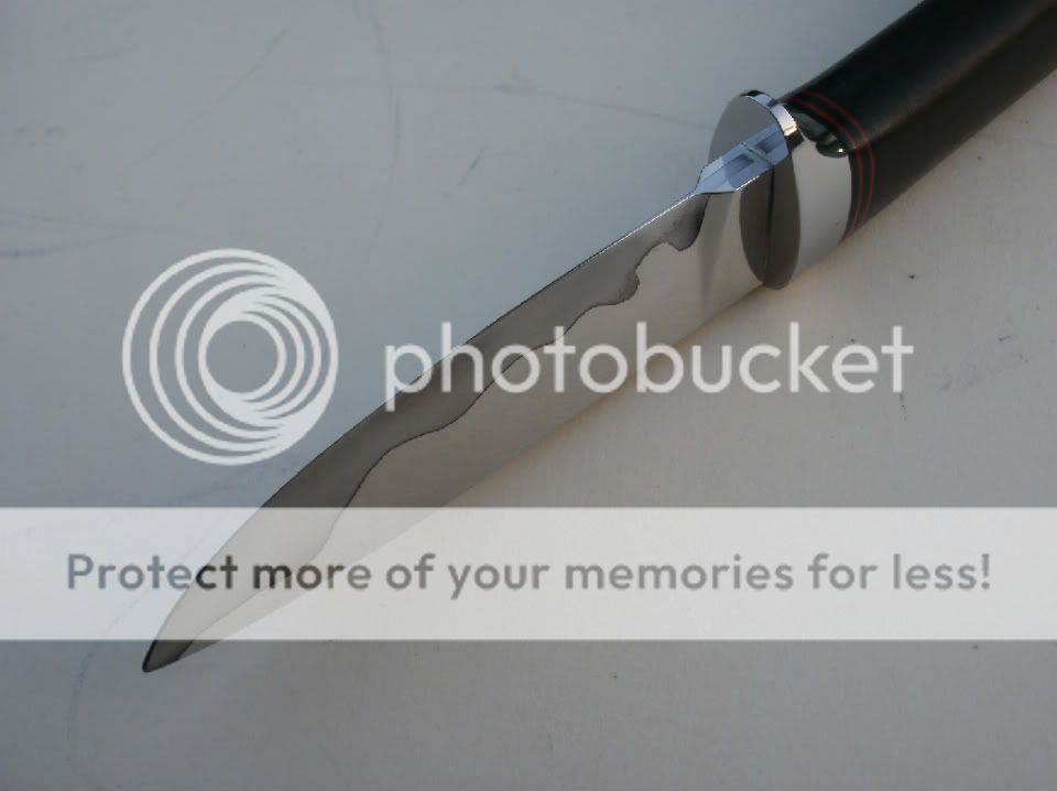

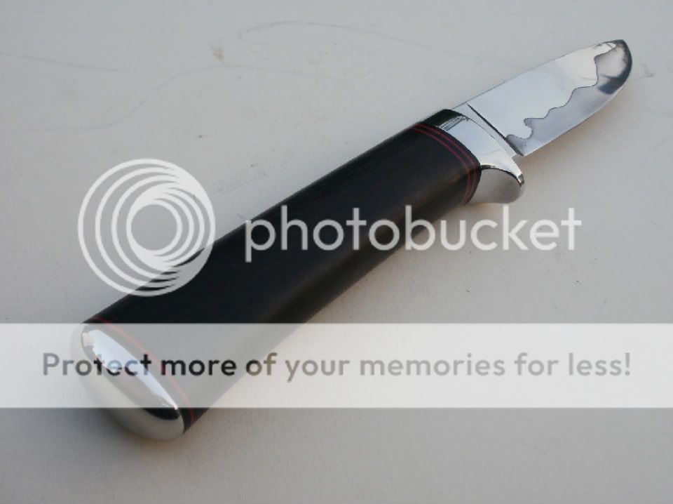

Thought I'd share this one with you.....
This is my first attempt at making a laminate blade after reading Burt Foster's excellent thread on here a few weeks ago.
As the title says, it's an 80CrV2 carbon steel core laminated with 304 stainless. The guard is 410 stainless (thanks Marcus;)), handle is ebony and it has black and red fibre spacers.
It still needs sharpening and a final polish, but I don't do this until the sheath is done, as it saves all those cuts and scuffs.;)
Blade length is 3 5/8" overall length is 7 3/4"
Big thank you to Burt for taking time to answer my emails and help an amateur. Very much appreciated.:thumbup:
Thanks for looking.:)
Ian
whew! A knife finally, and not a bad lookin one at that:thumbup:
Thank you Ian! This place needs some new interesting knives to talk about:rolleyes:
:D:thumbup:
GREAT job!
That's some fine looking steel and a real nice piece of work.....:cool:
Very cool. I particularly like the spine shot.
With all the interest in the blade I almost missed how nice the "whole" knife is.
Nice work! :thumbup:
