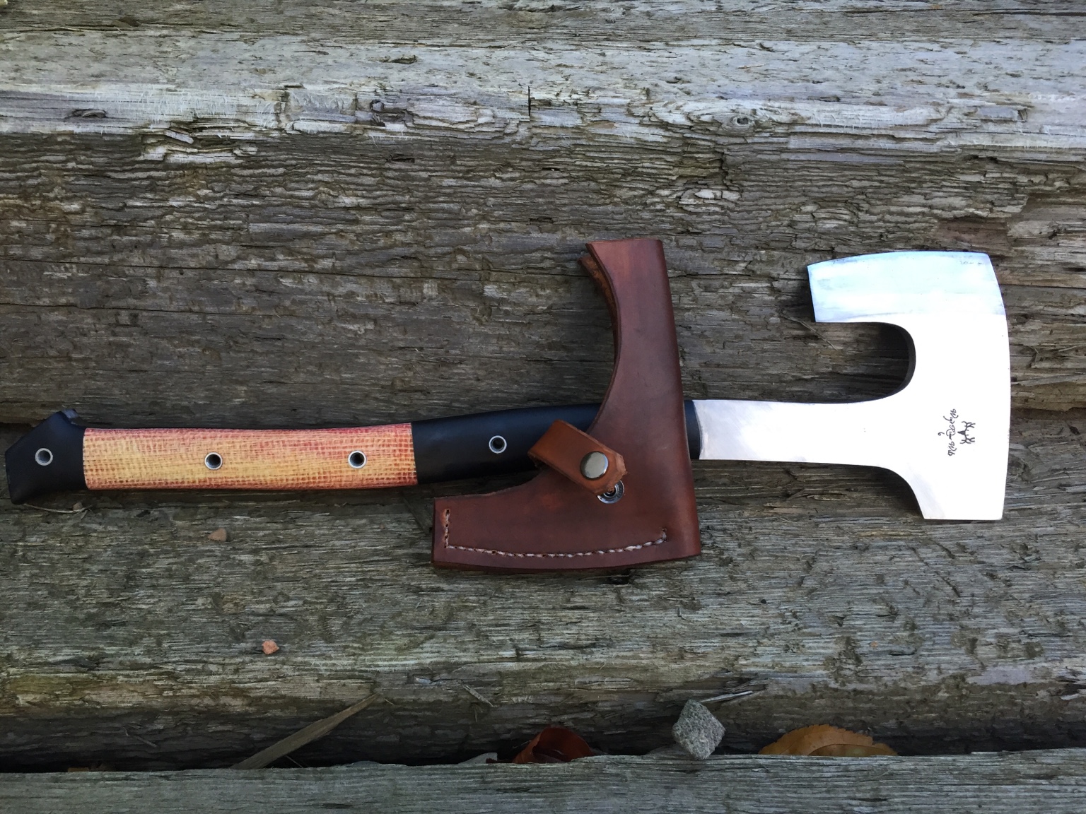

Love the stuff, I made this axe out of it and was super impressed. Gathered and split a car sized pile of firewood and could still shave with it after
