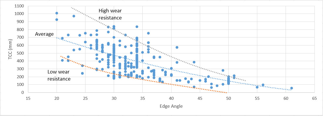

What might be most helpful is what aspects are you interested in comparing? Cruwear is pretty much better in every way except that it costs a lot more and cruwear won't win out massively in the toughness category.
The best place to find objective info is knifesteelnerds website.
17 pages of knowledge from the master…..
At 60HRC, 80CrV2 toughness is 30-35 ft/lbs
At 60HRC, CruWear toughness is 25-30 ft/lbs
This difference in toughness is very, very minute, practically the same.
But CruWear has much better edge retention, and is almost stainless. CruWear is also more expensive and requires proper heat treatment to get the most out of it.
