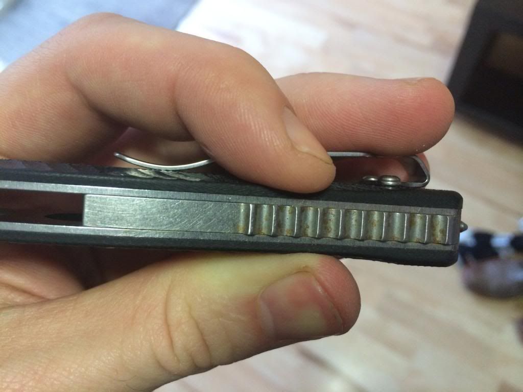

Due to the freezing weather we had here in Oregon, there were a lot of burst pipes around our valley. A business contact out out a call for help doing demolitions in water-damaged homes. Long-story short, I spent two days crawling around under houses in 3"-4" of standing water and mud removing soaked insulation and heating ducts.
I needed a hard-use knife for this, and decided to put my 810 Contego to the test.
Tasks involved cutting the fiberglass twine holding insulation strips up, cutting through the insulation around heating ducts, cutting those ducts into 3' strips, and then cutting through linoleum floors for removal.
The M4 held a working edge until the job was done, which was expected. At one point, the edge developed rust spots, but they rubbed off once the knife was used again.
The Axis mechanism was absolutely jammed full of mud and wet fiberglass, but never once failed to lock!
The smoothness of the blade deployment was seriously hampered and sounded pretty bad by the end of the first day. Once I got home, I scrubbed the mechanism out with dish soap, applied a few drops of lube to the pivot, Axis assembly, and the cutting edge making the knife right as rain.

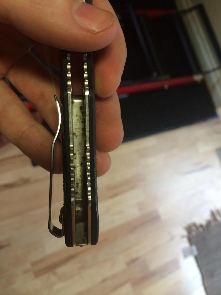

Permanent damage is in the form of the coating being scratched up, and missing from the tip (linoleum is more abrasive than I thought?). The backspacer is also covered in rust and pitting that I couldn't seem to get remove.
Overall, I'm seriously impressed with the M4 steel and the Axis mechanism, but bummed about the backspacer being so easily corrodible. I expected to coating to be compromised in some way, but not by flimsy vinyl...

Surprised the stainless steel backspacer got so many rust spots. Did you try Flitz Paste Metal Polish with a Q-Tip and leaving it on for a while before removing it?

The stainless steel backspacer on the Contego also has another problem related to the glass breaker in that use of the glass breaker has cracked many a backspacer. Of course, Benchmade promptly sends out repalcement backspacers. See the thread: 810 Contego backspacer fracture
I was hoping the issues with the backspacer would've been resolved through a design and/or material change for the upcoming 810-1401 Contego. Of course, in that model there's no glass breaker.

The 810 is a great knife. Unfortunately the cerakote scratches and pits very easily with normal use. Mine scratched just by cutting cardboard. Vinyl is a lot tougher than it looks. Flitz or a similar polish will remove the rust from the back spacer and probably protect it from further corrosion. You should be able to remove it without taking down the entire knife. I have not tried it yet but it appears that there are only two screws holding it in place. I really like the 810, so much that I got 2 of them. The action and feel is better than some of my customs. I would really like to see the 810 come out with an uncoated blade. Caring for carbon steels is really easy. It is coming out in M390 but it is out of my price range at this time.
