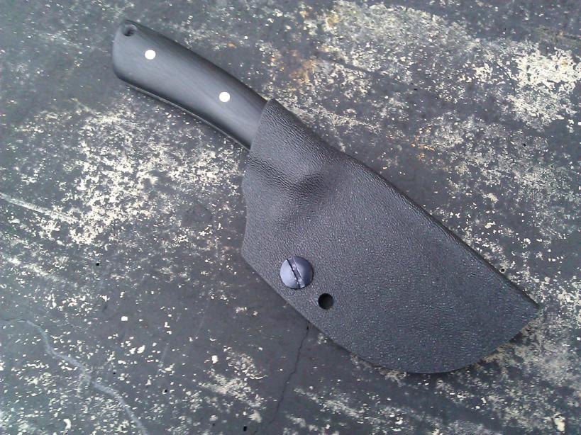

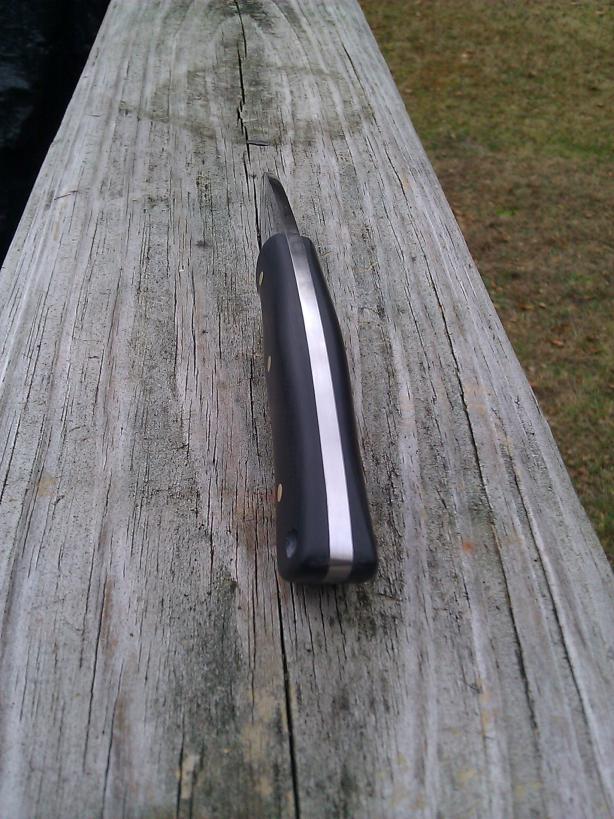

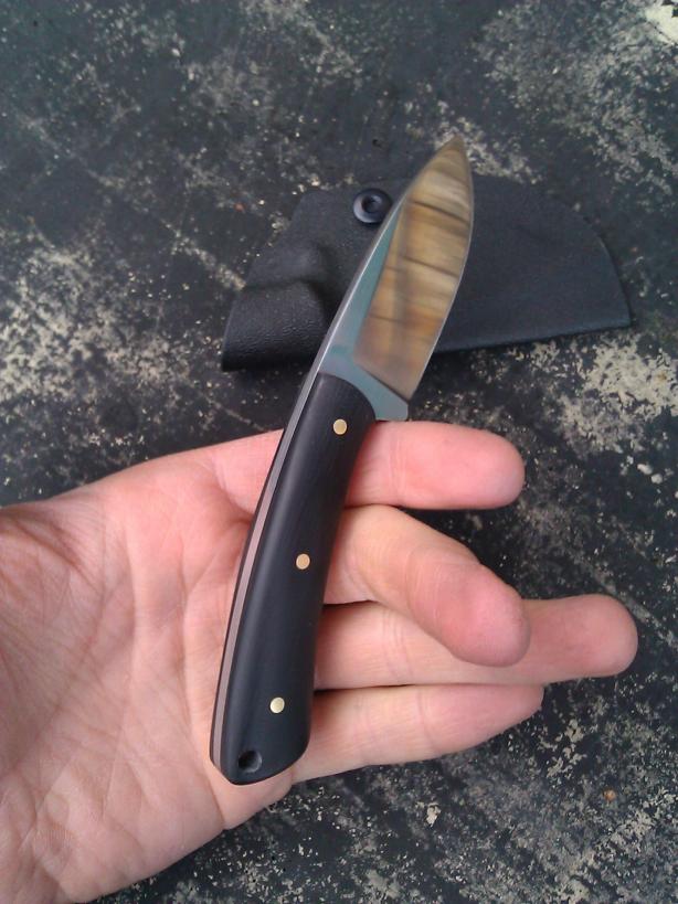

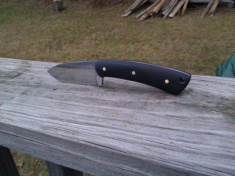

The first 85% (my new 'small' size) Hunter pattern in Aldo's 1084 and black G10.
Blade: 2.6", ~0.135 thick at the spine.
6.05" OAL
1/8" brass pins
Handle sanded to 360, blade to 1000.
This is a really nice EDC size. It is just the right dimensions to give exceptional control of the entire blade while still be compact and convenient to have around all the time.

The curve and reach are the great features of this knife - I spent months refining the drawing for this pattern before making the first one. The whole knife can be controlled securely in several dextrous grips while being neither cramped nor hyperextended. It's obviously a rather traditional style, but I've tuned it very specifically.
