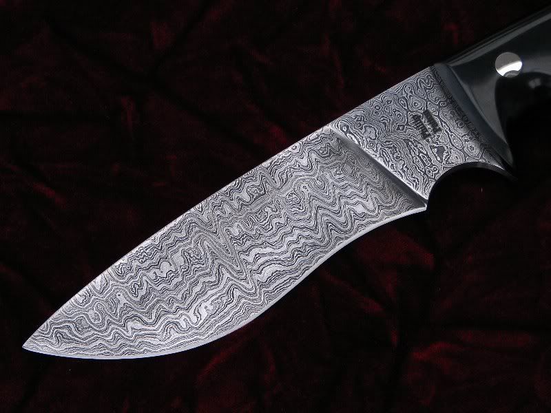

I have used it in damascus and it looked pretty bad. I passed my JS test with it though, treated like L6, 90 deg flex and came back almost straight with no edge crack.
I mixed it with 1084, 1095 and W2. Very little contast in my billets and a close look at the 8670 showed pits after a good etch, which made the finished blade look dirty, just nasty looking. Phillip, your's looks very nice :thumbup:
George, I use 15N20 from Kelly Couples and it looks and cuts very good. I also use a little 203E, it etches brighter and more silver than most anything, except pure nickel.
Thanks Don:thumbup:
I still have around 5# of 15N20 that I got from Kelly Cullpper (SP??) and about the same of L6. The last billet I made with L6, nickel and the 1084 from Aldo Bruno came out with very nice contrast. I'll be doing the next one with the 15N20 and Aldo's 1084.:D
I read somewhere that you should use muriatic acid when using chromium steels, and ferric chloride when using nickel steels. Did you use muriatic to etch it?
I remember using ferric on O1 and 1095. It wasn't pretty. :barf:
