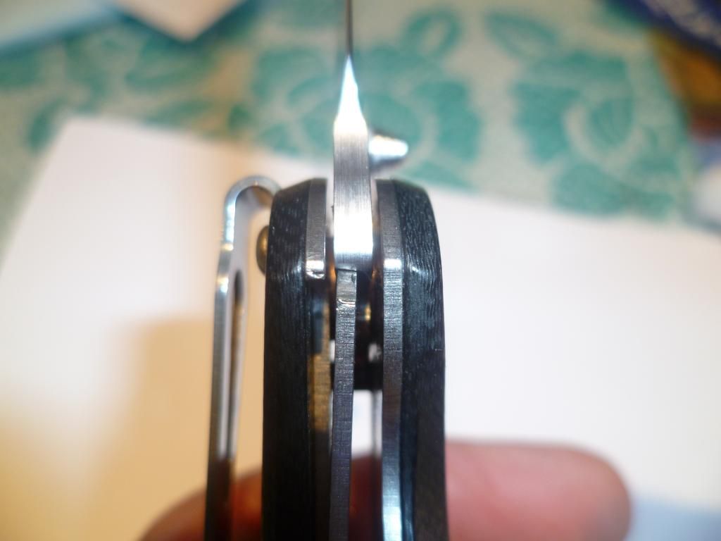

My new 890 came with the linerlock going all the way to the other side and touching the opposite liner, Now that I have made the adjustment the lock sits early at about 40% lock up. and with more adjustment as the lock wears.

....here we go,...This is what my 890 lockup looked like when it arrived new,...

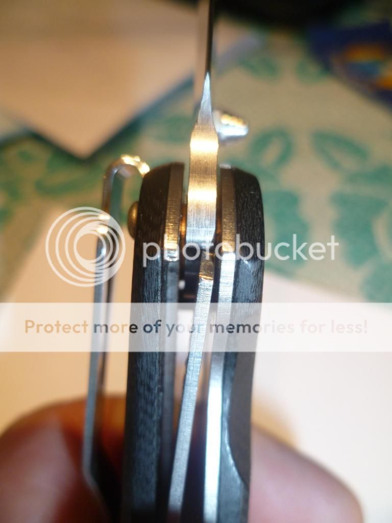

...on the 890 the blade stop is actually hexagonal,....

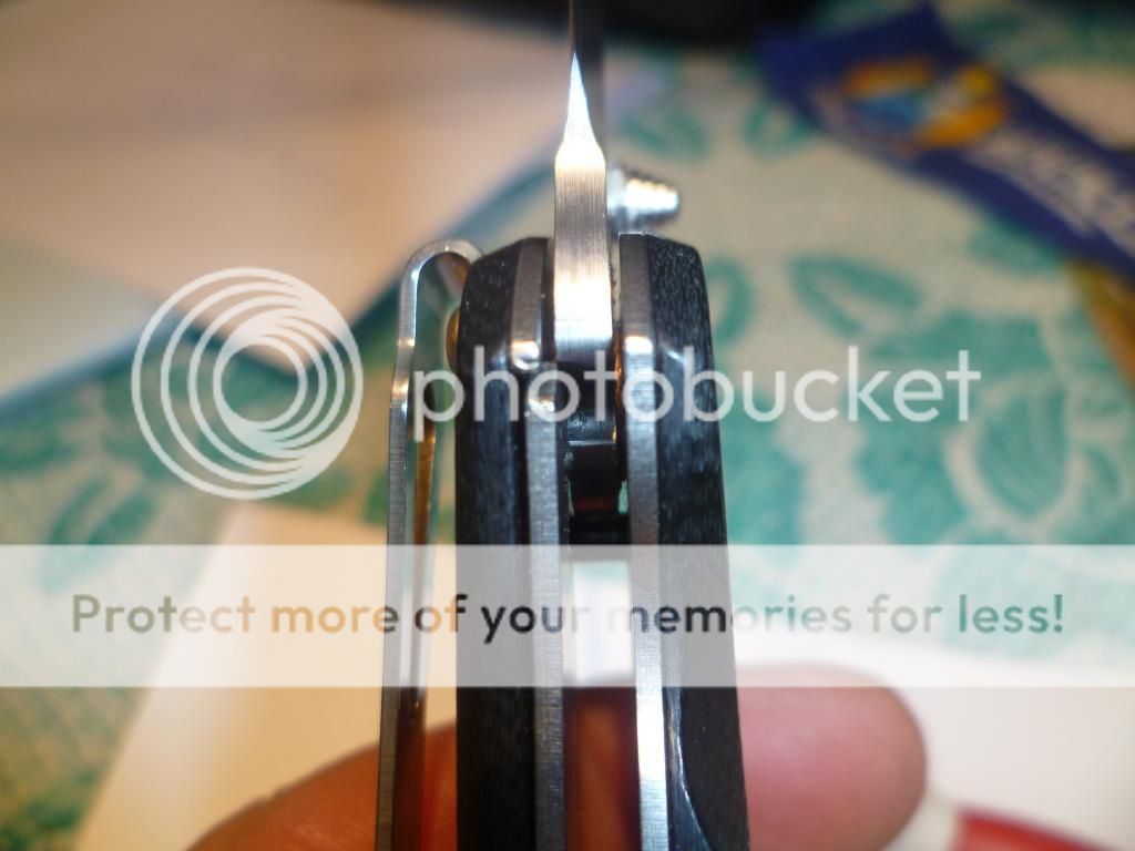

...and by backing off the set screw on the side of the G10 scale and disengaging the lock, it can be rotated, thus allowing for lock up to be adjusted, all the way from zero lockup,....

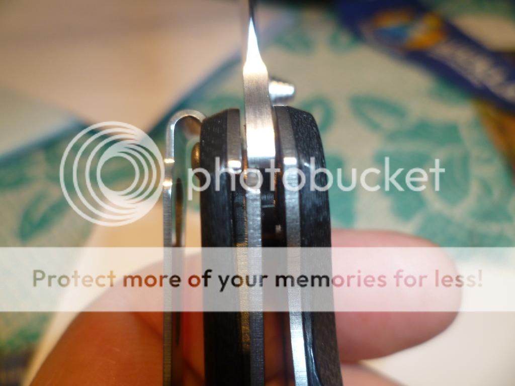

...to this....
...and on to this...

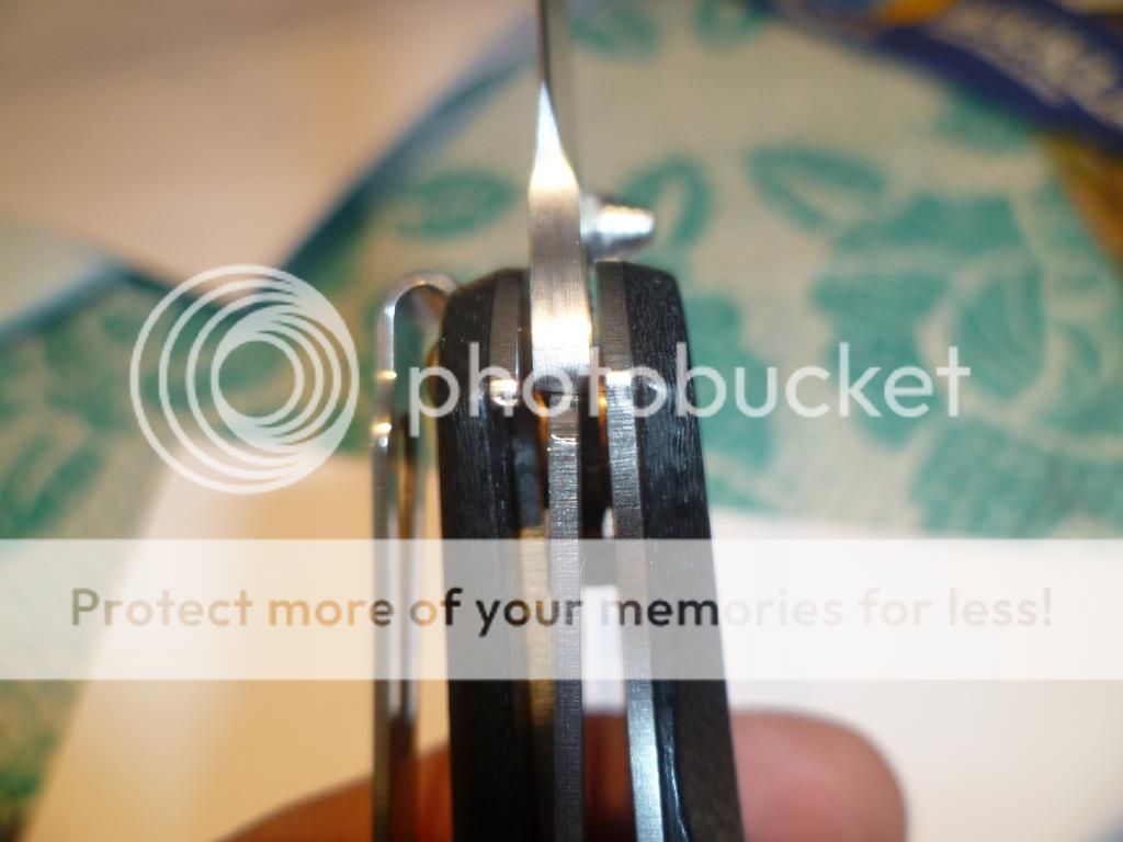

...and back to were it sits today....

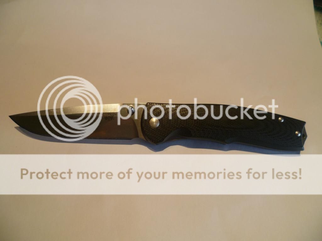

there we go, hope this helps,...
By the way I love the 890, classic look, great ergonomics, great blade for slicing, great all rounder for your everyday needs.
