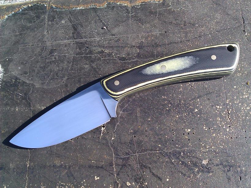

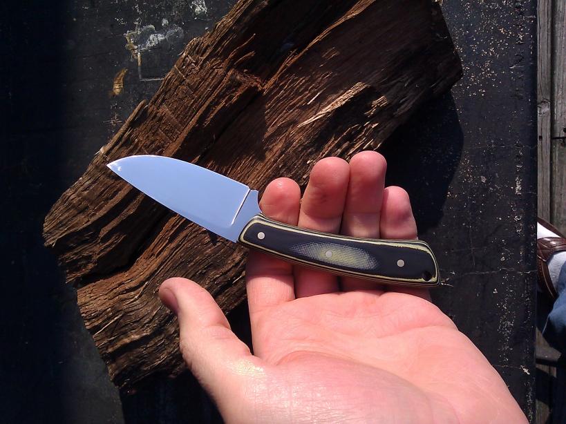

This little yellowjacket is a first prototype of a slight variation on my normal hunter profile.
I liked the 90% scale so much on Thrillbilly's knife that I had to have one at the same size.
Steel is 1/8" O1 with a high flat grind, reasonably thin before the edge. It notches REALLY well.
Blade is 2.8" long @ 1000grit
OAL is 6.4"
Scales are black/yellow G10.

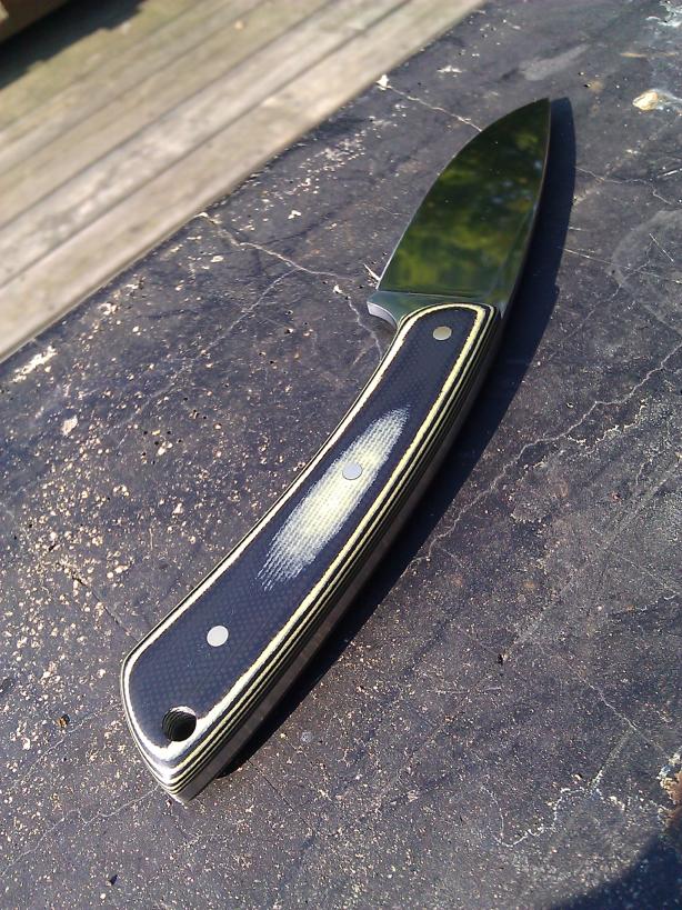

The scales came thinner than I'd expected, and as a result the handle profile is flatter than I wanted. However, it's still a handy little knife, and compact. I left the little matching yellow patches in the middle for kicks - maybe they'll get sanded off later.

I actually prefer thinner scales; they make the knife fit better in your pocket.
I like how the scales turned out. I think I would have a hard time not EDC'ing that one.
