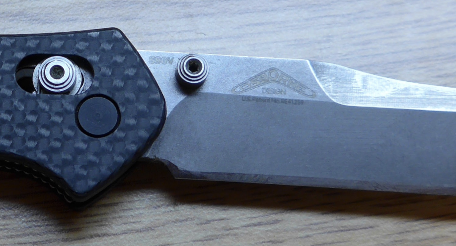

Its an ebay auction. I placed an impulse bid, but after looking closer I believe it could be a fake. What say you?
I'm no expert on Benchmades, but the markings on the blade don't match the ones pictured on either the Benchmade website, or Knifecenter. Pocket clips don't match either.
That, plus it's ebay, I wouldn't walk away, I'd run.

All my older 940s have the patent number below the grind. I don't see any with the Osborn logo also overlapping, though BM was sloppy about placement for a long time.
Edit: Found a pic of mine from 2014 (purchased straight from BM)
Here's a pic I found of a knife on one of the big Chinese sites that looks very close to the ebay knife (they blurred out the Axis lock).
Notice the marking, and how the patent number marking extends the full length of the Osborne boomarang.
Here's the ebay knife. The patent marking also extends the full length of the boomarang.
And here's the patent marking on kreole's older genuine 940 from the previous post. Notice how the patent marking is clearly shorter than the length of the Osborne boomarang.
Again, not a Benchmade expert, but perhaps the patent marking being the full length of the Osborne boomarang is a tell-tale sign that distinguishes a fake from the older, genuine 940's. I'm guessing there are other clear signs as well. Like perhaps the pocket clip. But those more familiar with the 940 line would know better than I.
Here is a pic of the pocket clip from the ebay knife. It's the same as the clip in the first pic taken from the Chinese site, although they blurred-out the "BENCHMADE" part in the Chinese listing.
Also look how shallow the choil on the eBay one is compared to the real ones.
Definitely fake. The carbon fiber stops being carbon fiber past the faux bolster engraving like it's a veneer or something.
I don't think logo placement is a reliable indicator (it appears the logos can wander around depending on who's doing the engraving that week) but that carbon fiber looks totally fake.
