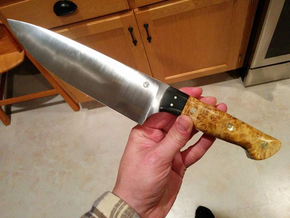

I am making a grinding jig. I want to make a kitchen knife. It calls for a 20 degree angle.
Should I cut the wooden jig angle at 10 degrees or 20 degrees.

Your question is not clear. Twenty degrees is indicative of a [sharpening angle] the cutting edge, when discussing kitchen knives. What are you grinding?

tell us the thickness of the stock, and how tall the grind line will be, it will be easier to give an angle estimate.
It is the grinding angle. I will end up with 20degree Sharping angle. What grinding angle should I start with?
Thanks Jay
Still no blade thickness and how wide is the blade?
That will help someone to help you. Have you read the stickies above? And why not complete your registration like where do you live? Be friendly.
Frank
Stating that you want to end up with a 20° inclusive(?) angle is fine.
But not letting us know what else you are doing makes it hard for us to help you. It would be similar to me stating that I would like help with climbing Mt. Everest and I know I am going to summit the peak, but I need help with the rest.
Answer a few questions,
-What tools do you have, will this be ground with a file, 2x72 belt sander or something in between?
-What material are you using (include dimensions)?
-Are you planning on having a "V" grind or a Chisel grind?
I am sorry about not answering the questions correctly. I updated my profile.
I am using AEB-L .125 2.5 wide.
I am using a 2 x 72 grinder with a v grind.
My blade for a kitchen paring knife is 8 inches long and 5/8 wide. The blade itself will be 4 inches long the rest is for the handle.
Again I will try to give more details in the future. Thanks for the advice
Jay
I am one who finds a new maker using a jig to grind a bevel as silly and useless. You have to LEARN how to grind a bevel. If you don't want to learn how to do it, and want a jig or machine to do it for you .... just buy a pre-made blade. It takes time and practice to di it right. Building filing and grinding jigs is sort of like learning to write by only typing on a keyboard. It may teach you spelling, punctuation, and grammar ... but it won't help a bit when you pick up a pencil and realize you have no idea how to write the alphabet. ( This is a real problem starting to happen today)
Fred's Bubble jig isn't a jig to grind an angle for you, it is a guide to keep a steady angle. It will greatly aid you in learning how to grind. It will help with sharpening, making clips, and shortening the learning curve on angular grinding tasks. I have heard from others that using a Bubble Jig took many months off the time to learn how to grind a clean and smooth bevel.
People who have learned how to make and shape a knife will come up with jigs and such to ease the grinding or make repeated grinds more consistent, but they spent years learning those skills. Some of those people still use a bubble jig to get clean grinds when doing things free-hand.
In answer to you angle question - The actual bevel angle is insignificant. It is whatever angle forms when you grind/file the bevel from spine to edge. It will be in the 3° range for most kitchen knives. For a 2" tall blade in .125" steel, the total angle at the edge is 3.582°. To calculate it and set a jig, you will need accuracy of a hundredth of a degree or more. Even that angle will change as you approach the tip. Solution - just grind/file the edge to get a full flat grind from spine to edge.
