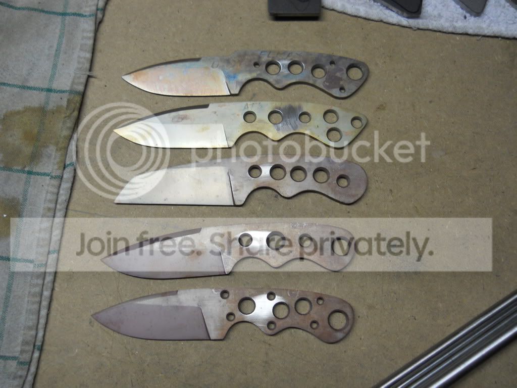

A batch of small fixed ready for heat treat

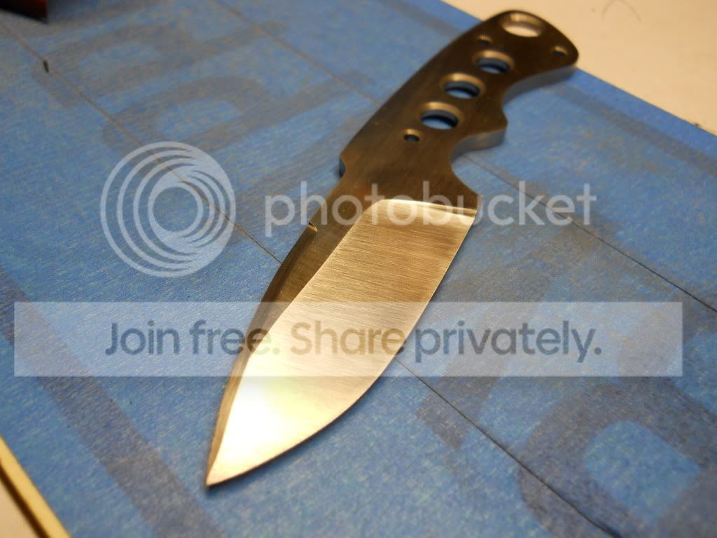

Well, the more I thought about it, the more I realized I should swedge the Mini Drop top as well. The stock is .156"' thick and since it wasn't a full flat grind, the spine was just about full thickness except for very close to the tip. I like the way that a swedge looks on a knife but I kept thinking about the practical reasons for the thinning of the tip, like aiding penetration and slicing, so I went ahead and did that one too.
I'll get pics up in a bit.
EDIT: Here are a couple pics.....
Your skills are evident and your blades keep getting better. Jump in headfirst and start fully tapering your blades and tangs, bro. First time you try it, it may make you say bad words... but you won't regret it. Your designs are clean and crisp and deserve to also be light and well-balanced, without sacrificing strength. :thumbup:

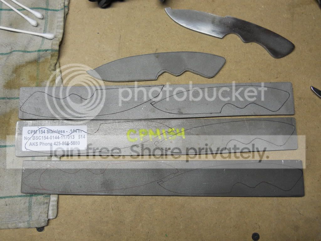

Well, with all of the knives from the first part of this thread currently at Peters, I had time to get started on some more. Largely due to the feedback from the members and makers here, I decided to put some emphasis on the Mini Drop Point XL, and these next ones will be done up in CPM-154.:thumbup: A couple will be done up in N680 Nitrogen stainless as well thanks to Chuck Bybee from AKS. I'm excited about trying it out.

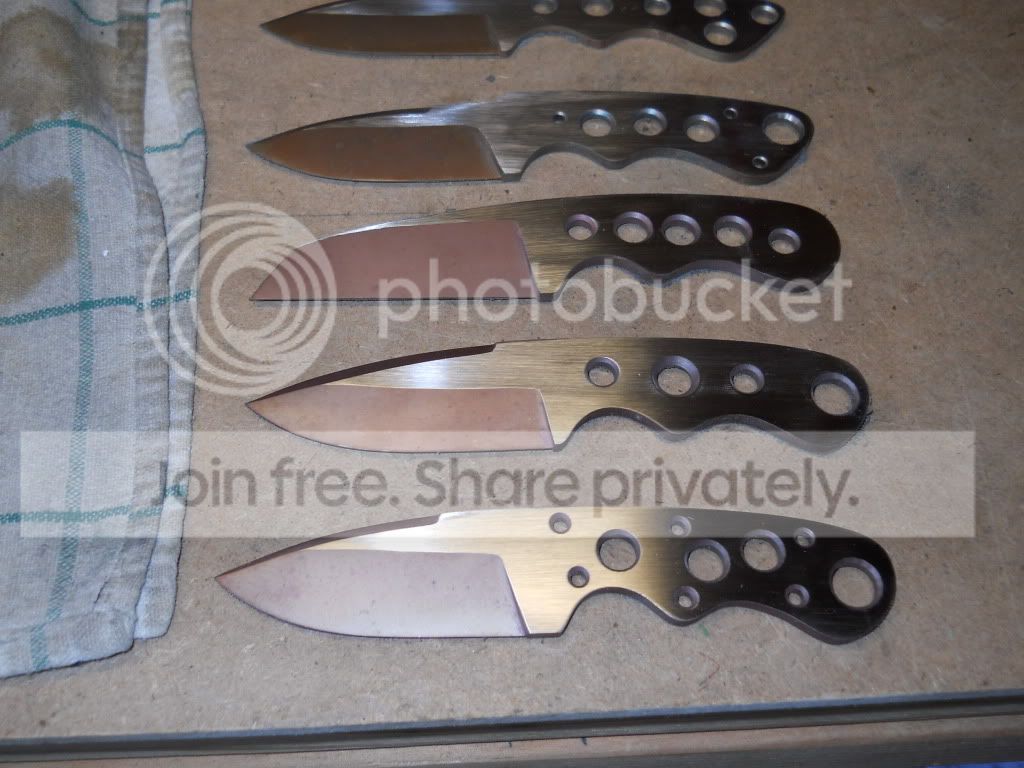

Well, they just showed up from Pennsylvania this afternoon, so I'll be getting to work finishing up these "Minis" asap! Friday is normally a shop day but I have a big test for a job tomorrow and so it looks like I'll be getting started on these Sunday. I'm kicking around some ideas for handles. Look for at least one to be done up in a black and yellow combo.

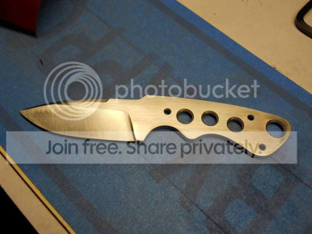

I started some finishing today and took some pics after beginning the finishing of the flats. I have seen a couple other makers do it, and I personally own a Snody Bailout with a combo finish, but never considered doing one. But when I started to grind on the flats today I thought it was a pretty cool contrast. I think I'll still be finishing these all the way, but I won't rule out leaving the heat treat finish on something in the future.
