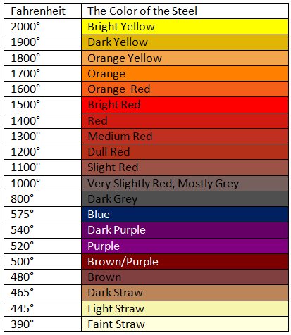

Eventually, the blade turned (what I thought was) red and after a few minutes I pulled it out and dunked/stirred it in my (heated) canola oil. Remember the part about “distraction”?, in my rush to not burn myself, get the blade in the oil, not spill or start a fire, make sure my son was doing his homework, and make sure the dog didn’t get out of the backyard I managed to skip the magnet test, and I pulled it out too early (…I’ve never had that problem before….). A file test later and I realized my mistake. For those of you who are asking yourself why I’m quenching instead of aircooling for an anneal, I’ll refer you back to the "eager beginner" concept; I had mixed my steps, but I didn’t realize that until later.
Wet but undaunted (did I mention it had started to drizzle?), I lit the torch again and placed the blank back inside the forge-ish contraption. This time, for experimentation, I added one of the circular saw blade blanks to see how it would fare and prep it for a post-harden file test. I heated both to orange and kept going unsure how far I could/should go, eventually I reached an equilibrium point where things weren’t progressing any further but weren’t regressing either. I dunk/stirred the blanks, got a little smoke this time and a satisfying crackle when the steel hit the oil, however rushing to get two blanks in the oil quickly was a challenge, and I inadvertently managed to melt a small hole in the side of my plastic quenching bucket…which I discovered much later…after half the oil was on my driveway….
Regardless, after cleaning everything up, the saw blank was strapped into a vice and after a few good whacks with a hammer a bend was visible; also, I was able to easily mark it with a file. Disappointed? A little. Intrigued/entertained? Definitely. I wanted to use the saw blades as a platform to experiment, and practice tool skills, for that, things worked pretty well.
The 1080 blank was a different story; this one I wanted to succeed. I tried a file test on the flat and didn’t get much marking, but when I filed the profile material started coming off (though not as readily as the saw blade blanks). I cleaned up the edges a bit with the file and decided to call it a night…besides I needed to walk the dog. Giving my mind time to process things, I reviewed my steps and kept getting tripped-up at a few points; I needed to check a few things. You can probably guess most of what I read when I got home.

Do this at dusk or night, and get a steel color chart like these
Move the blade in/out of the opening to heat it evenly. Get a magnet as a guide but know you'll need to go a little hotter.

According to the heat colour charts linked by Ashwinearl I had the 1080 up to 1600-1700F (it was past deep red well into orange), if so, using the 1080 information on Cashen's page I may have actually normalized and quenched? If the heat was lower it would have fallen into the annealing category but with a quench instead of a gradual decrease in temp., and lower still would have been in the hardening zone ("no higher than 1500F")? Since I can still easily file the 1080, is it more likely that I ended up normalizing it?

Color is very subjective. A magnet stops sticking at 1413F.

Understood, I mentioned upfront that I forgot to use the magnet, so I'm left with colour I saw (it was approximately the colour of the Orange-Orange Red bars in the pic below). Taking the subjectivity of colour into account, where might I have landed in the spectrum of options? And what effect could my completely inappropriately timed quench have produced?
You know, I was never able to really use the color chart to know where I was. The important thing I did learn was to look for subtle color changes. Then I tried to see where the color was when the magnet started to stick and go a shade hotter.

Color is not a good way to judge temperature. It depends on the ambient lighting and the adjustment of your eyes. An example of how easy to misjudge the temperature by color is here: https://www.bladeforums.com/threads/heat-treating-and-temering-1084.980622/#post-11159318
This is not to say it's impossible, but I bet it requires a lot of experience and only in your own workshop under the same lighting conditions each time. I always do my HT at night to help minimize the effect of ambient light, then I use a magnet and heat just a shade hotter than what the steel looked like when gone non-magnetic since steel goes non-magnetic around 1415F but I want to heat around 1475F to 1500F for the steel to reach austenitizing temperature.

I find that chart very off unless you have some experience and are in a darkened indoor smithy. It also isn't the same as some other charts.
In any case, what your eyes see is not necessarily what the chart says.

I agree with you guys about probably not getting hot enough, and the colour identifying; I'll make some adjustments and give it another try this time with a magnet and a more compact brick arrangement (unless I get some soft bricks first)....and a METAL BUCKET this time! :rolleyes:
