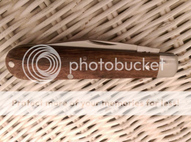

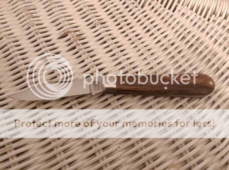

I received this in yesterday's mail. A nice 3 1/2" Jack put together by our very own Esnyx (Evan). It came with a nice note of thanks for keeping an eye on the Traditional Forum.
A great little knife, Evan! It'll find its way into my pocket for sure. Thanks so much for your generosity and support. It means a lot to me to be part of this great little corner of the world.
It's been fun watching your progress. You've got a lot of talent and I wish you the best in your venture.

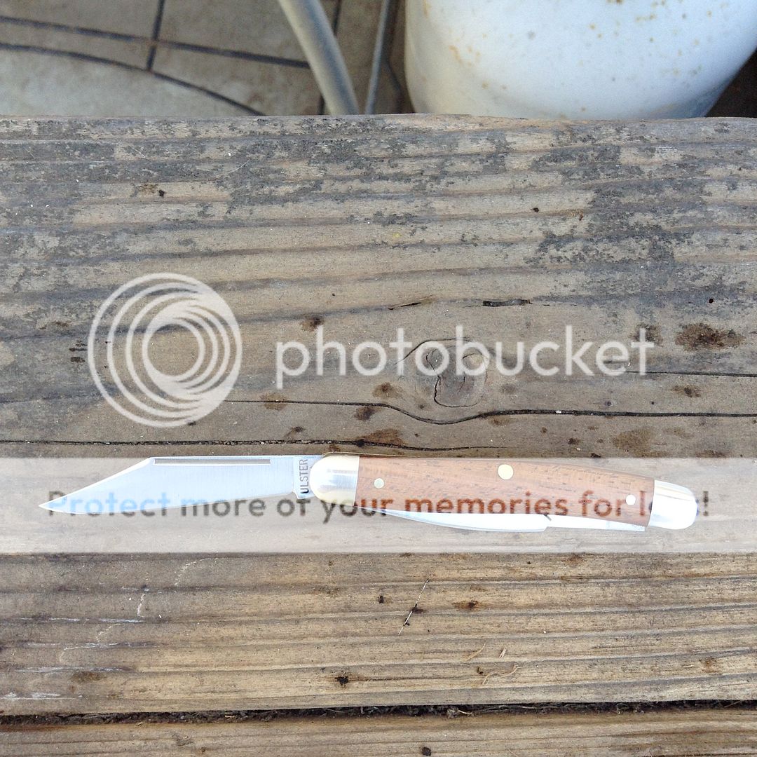

Evan gave me this pretty little 3 1/4" Ulster stockman that he re-built. Beautiful covers, everything just right. Lovely job on the pins. The heads are curved, exactly matching the curve of the cover material. Has a pen blade, spey, and clip, which is a configuration I've never tried. It's been in my pocket since yesterday.
Evan gave each of us a knife of the style we are most likely to carry, a single blade for Gary and a stockman for me. The thought he put into each gift was not lost on us. Likewise the note he sent each of us.

Gary, yours has stabilized spalted sycamore scales. The original knife has a pen behind the main, but I decided to remove it to make it a single blade, which I feel was more to your tastes. I reground the blade, to remove all of the pitting, and chips in the edge. The linkers and bolsters are original to the knife, and it previously had black delrin scales.
Frank, yours also had black delrin scales on it, and I kept the original liners and bolsters. I also reground the blades on yours, and added the cut swedge to the main clip blade. This knife was tricky, but fun, because it had a swindon key construction, that I managed to replicate. I love working on old stockmans that have the swindon key, its is always a fun challenge! the scales on yours are jatoba, aka Brazilian cherry.

Thanks for the details, Evan. I was wondering what kind of wood it was. I've never seen anything quite like it and this is coming from someone whose father imported exotic woods for a living. So warm and so nicely patterned.

I was wondering what wood you used, Evan. The spalted sycamore makes some nice covers. Thanks for the other details and again for the knife.
