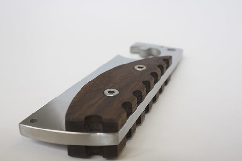

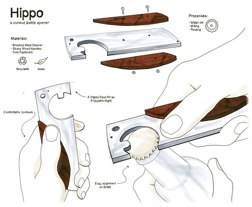

Here's a few prototypes of a bottle opener I designed over a 3 week project in school. It's a fun little doo-dad and opens bottles in four orientations for a high ease of use factor.

that is definitely one sweet opener! now you just need to put an O2 tank wrench or shackle wrench on the other end! good job, you better get an A on that project, and then start selling 'em! :thumbup:

I would buy that
It would also be awesome in keychain size, with a flathead and phillips head screwdriver built into it.

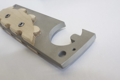

If you increase the radii at the inside tang, they can be more easily CNC milled, and the cost could go down. There are a lot of hungry machinists out there looking for work. It can be waterjet cut or lasered as is. As for the patent, in my opinion, you would do better just having a licensing agreement with a manufacturer. Just make up a proposal on how they can make money, what costs would be, etc, and it's down hill from there. Patents cost thousands of dollars, and unless you are willing to spend major bucks fighting for them in court, they do you no good.

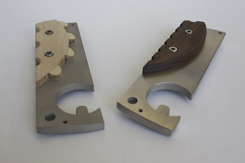

I can get the parts fabricated for around $12 a unit now with about 2 hours of finishing time by hand for each one.
I imagine the cost can be brought under $10 per unit if done in large quantity by a manufacturer.
What you see here is water jet cut stainless steel and laser cut wood. Both are hand finished and fitted. All my design.

I'd do a design patent on that. Not very strong protection, but the option requires little write up and you won't have to deal with claim language. Just my opinion. That, and the figures you have will suffice (no lawyers needed).
