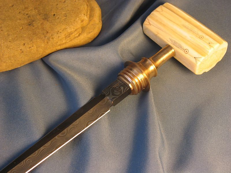

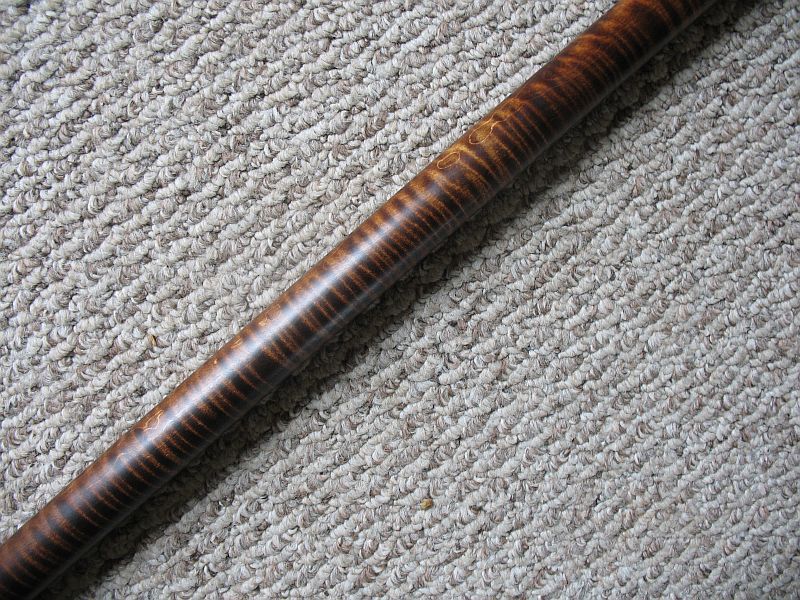

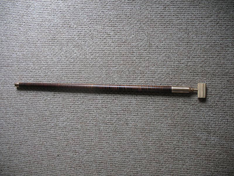

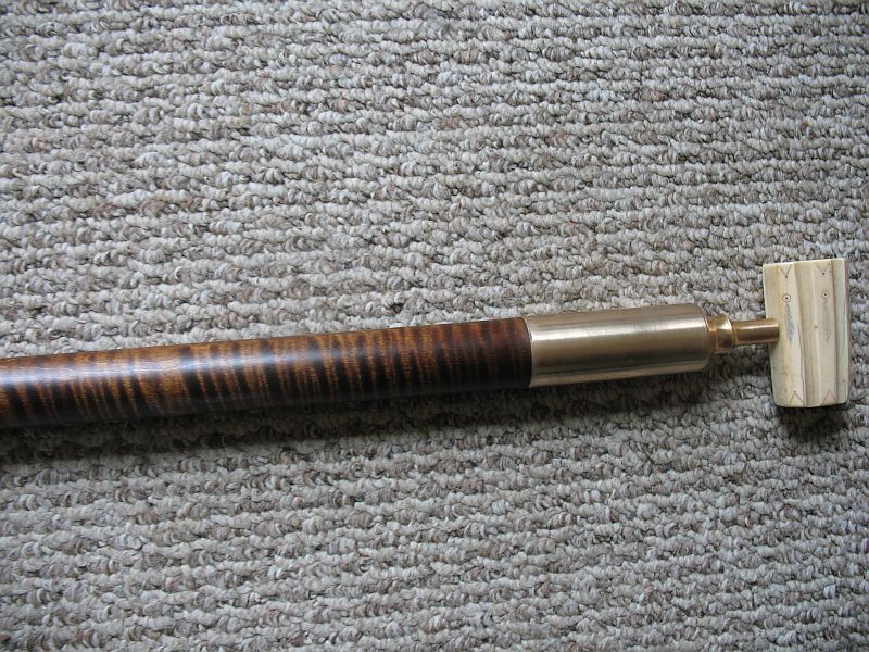

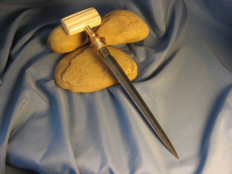

I had a client bring me a piece of Pre-ban ivory he got over 50 yrs ago from his father. He asked me to make a special walking cane for him and here it is. I used bronze for the fittings as I wanted it to get a patina and look like an antique with the tiger maple. Every piece I hand made and the Damascus is ladder pattern (sorry for the bad pictures as he showed up and I had to do a fast photo as he wanted to take it). The blade is 8 5/8 inches long with forged tang that I turned and then threaded. The top of the ivory has a locking nut that is recessed and and sanded flush. The dagger is .300 thick at riccasso with a taper to tip. Here it is and I hope you like it.

Beautiful and elegant push dagger/cane.

Nice to see a cane dagger for once and a push dagger to boot.
Wow! It came together beautifully Dan. Nice to finally see the whole thing assembled.
So you got some more practice on your screw-cutting Southbend. Nice choice of pitch and scale - just three full turns to release?
Scary fine Danmascus dagger grind and that Maple - oh man to have a giant pile of that stuff...

It has been fun to learn cutting threads on the Southbend lathe.And yes I wish I had a bunch of maple like this one. Thanks guy's.
I did one years ago and forgot just how long they take to build. I stained the maple 2 times and sanded off and finally used Potassium permanganate to achieve the color that I wanted. Was a gripe to sand off 2 stains. Bruce, would love to see you do one. Thanks all.
Very nice looking piece! That will be somebodies family heirloom for sure. Nice work.
I've often considered purchasing a sword cane, especially now that I will probably soon NEED some sort of cane. Unfortunately, California treats possession of such a piece as a felony. The only swordcane I've ever liked has, to this point, been a Berger. However, this is a really beautiful piece you've put together, Dan, and it has changed my perspective on what I would want in a swordcane, were I able to legally own one. A really great piece!
