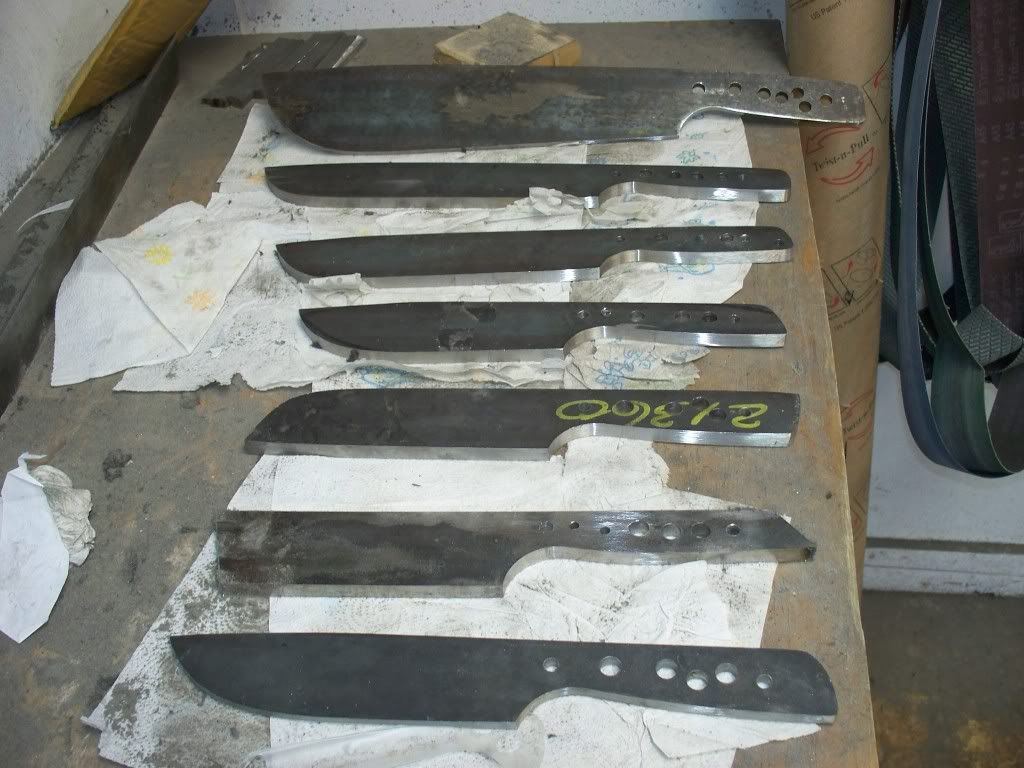

This is going to be epic! These range from .250" to .360" thick, I'm going to use a lot of belts... after making these my KMG grinder is going to be scared when I enter the shop! :eek:
Here's How it all starts. Lots of 5160 steel!
Then I bust out the chop saw. It is important that I use these "Disco Abrasivo" blades to make the knives. :cool:
Cutting the stock so I have a little less grinding to profile to do later
Here they are, vaguely resembling knives at this point. Some are semi profiled and some are still blocky from my saw work.

Ok,the third from the bottom....
Grind an edge on it,give it your new style cord wrap & call it done.(ok,round the edges on the handle a bit too.)
I love that blade profile in a chopper.
I'm liking that idea! I already profiled it but I really like that, the straight lines would really look nice. I like cord wraps on choppers too, they are so grippy and have a bit of give.

Four are for orders and 3 will be available. The two on the bottom and the top one will be for sale, I'll get some profile photos, they look way different now. Pointy!
The top one is just outta control and makes the rest look small, the smallest one is just over a foot long. That big one is about the size of a Cricket Bat! You may able to use the knife itself for shelter after a hike.
Awesome!!!!!! I know my Sioux Warrior Survival Knife is coming from this batch. I can not even come close to telling you how pumped I am about it!!!!
You know it! It is huge too! It's the third one down and looking really nice now... ignore the profile it is practically still a bar in the pic.
I was thinking it doesn't look as big as it is because the next two are almost in the sword category. It's big!

I'm in the middle of heat treat at the moment, 4 are hardened and three are in the oven!
Alright all 7 are quenched and straight! I'm going to let the kiln cool down and put them in for the first temper cycle.
that one is interesting, cleaver like with skull crusher :D ... these are all 5160, yes???
