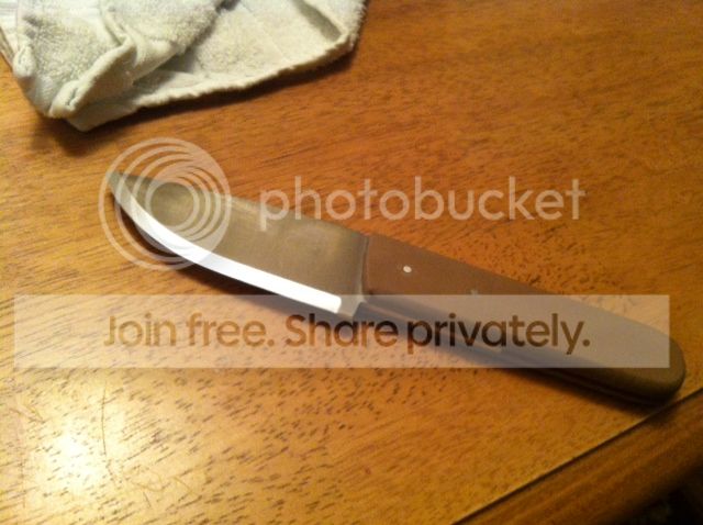

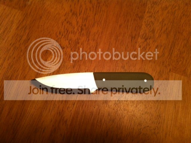

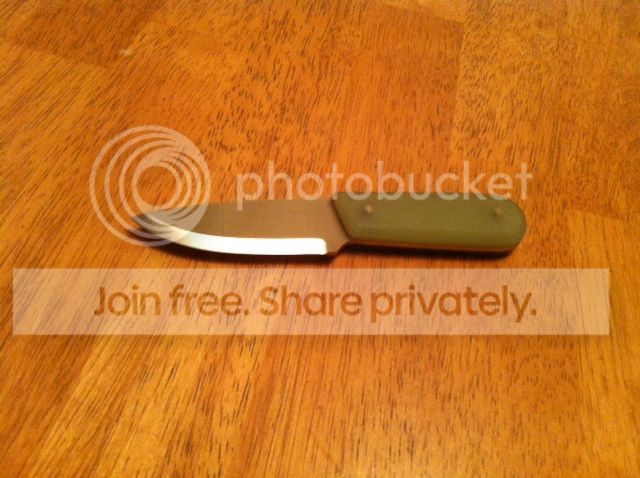

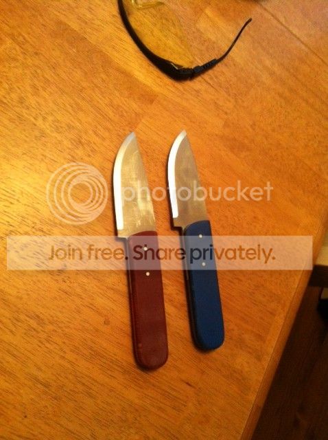

Well I finally have a few to show =)
Slowly getting there. Love any feedback from you fine gents, just be gentle ha.
Precursor, all these are Elmax @ 61-62, ht by peters, .098 thickness, g flex epoxy, stainless steel bolts for pins.

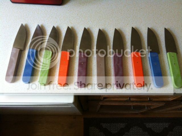

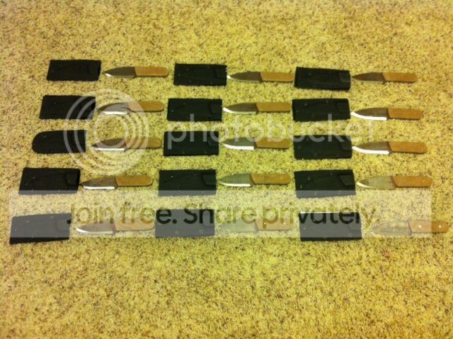

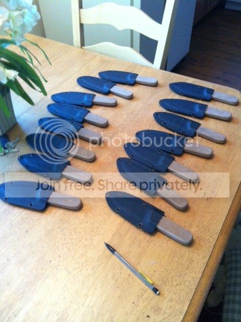

Then a friend asked me to make him 15 knives for his groomsmen.

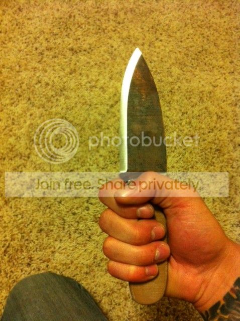

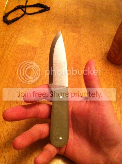

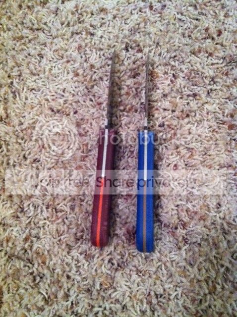

Is there only one bevel on each blade? I'm suggesting two would work better for most of us. I also think that rounding the edges on the scales would make for an easier to use knife. They do look handy to use. Frank
As did Frank, I noticed that they seem to be single bevel, and the handles appear a bit blocky. It must be a big wedding with 15 groomsmen, and really unusual that they are all left handed :)
15 degrees a side scandis gentleman ;). The pic with all the colors was before edges, all left handed would be VERY slim odds indeed ha.
Handles are a little blocky still but by no means square, just flat with the corners routed
