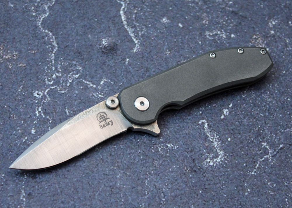

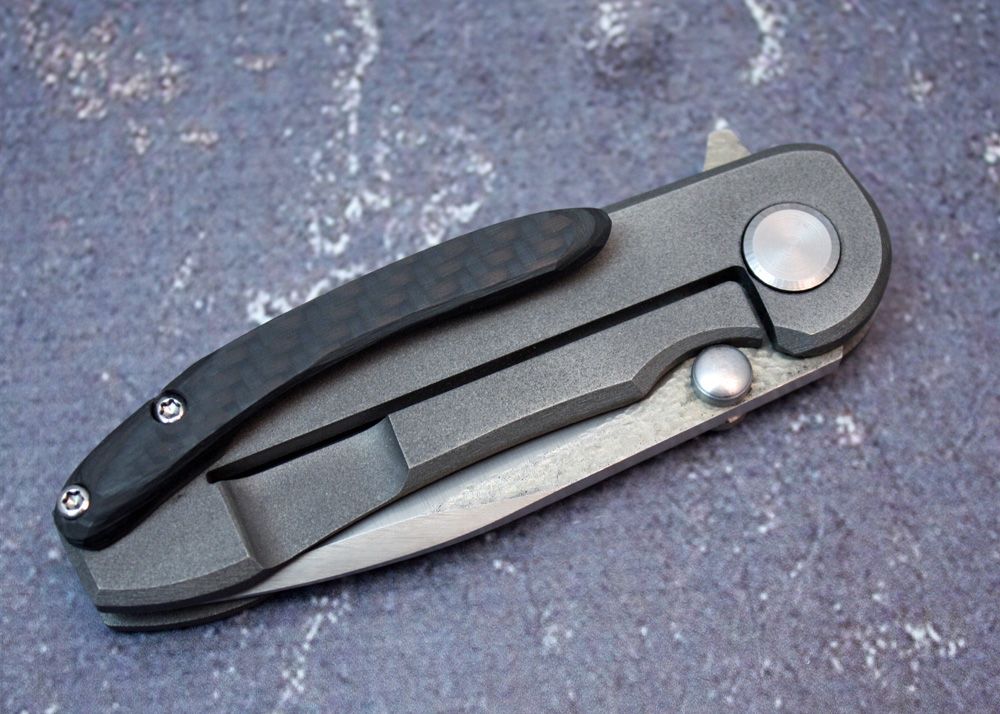

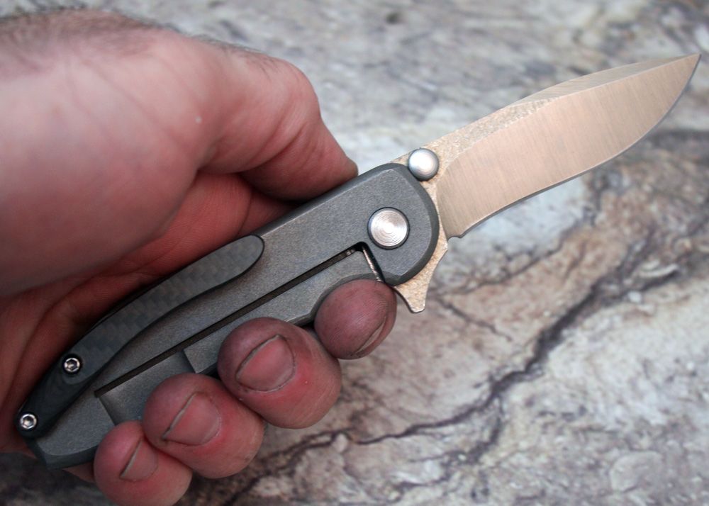

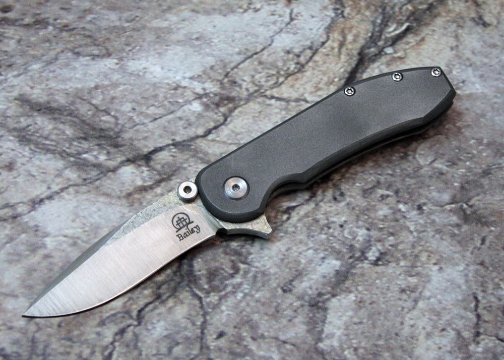

A couple Model 1 Folders.
Bailey Knives
Oct 18, 2004
3,836
I just started on folders. I have made a few of them and these are the first that I have offered up for sale. They are .150 6AL-4v titanium and cpm154cm steel, heat treated by Peter's to 61rc.
Let me know what you think.
I love it. It's a step in a different direction but the blade has you all over it (hopefully only figuratively ). I would personally like to see a lanyard hole because it allows for a small amount of personalisation without actual modification.
Do the stops on the blade double as thumb studs?

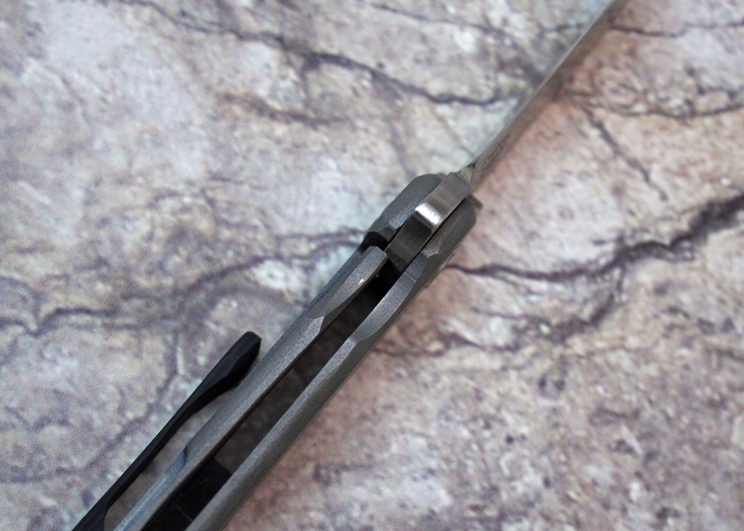

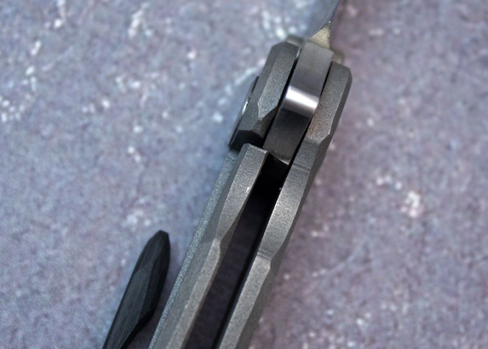

What is the pivot? Washers or bearings?
Now that we can import flippers I am giving this serious consideration!
The thumb studs are the stops and I have phospher bronze washers in it.
Thanks for the comments.
I think it looks great. Nice blade shape and not overdone as far as looks go. Looks like a great tool that will be put to work.
