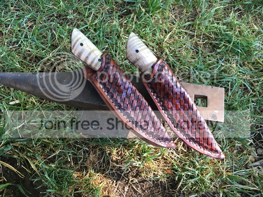

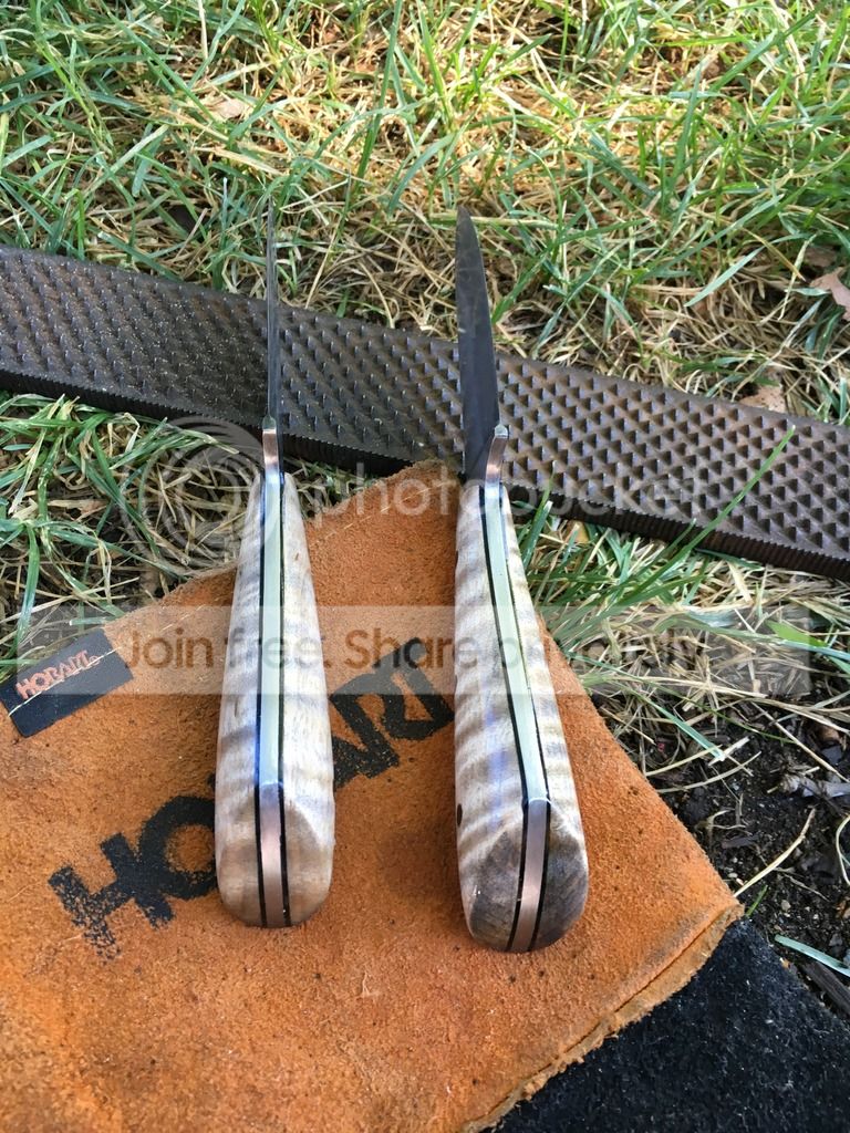

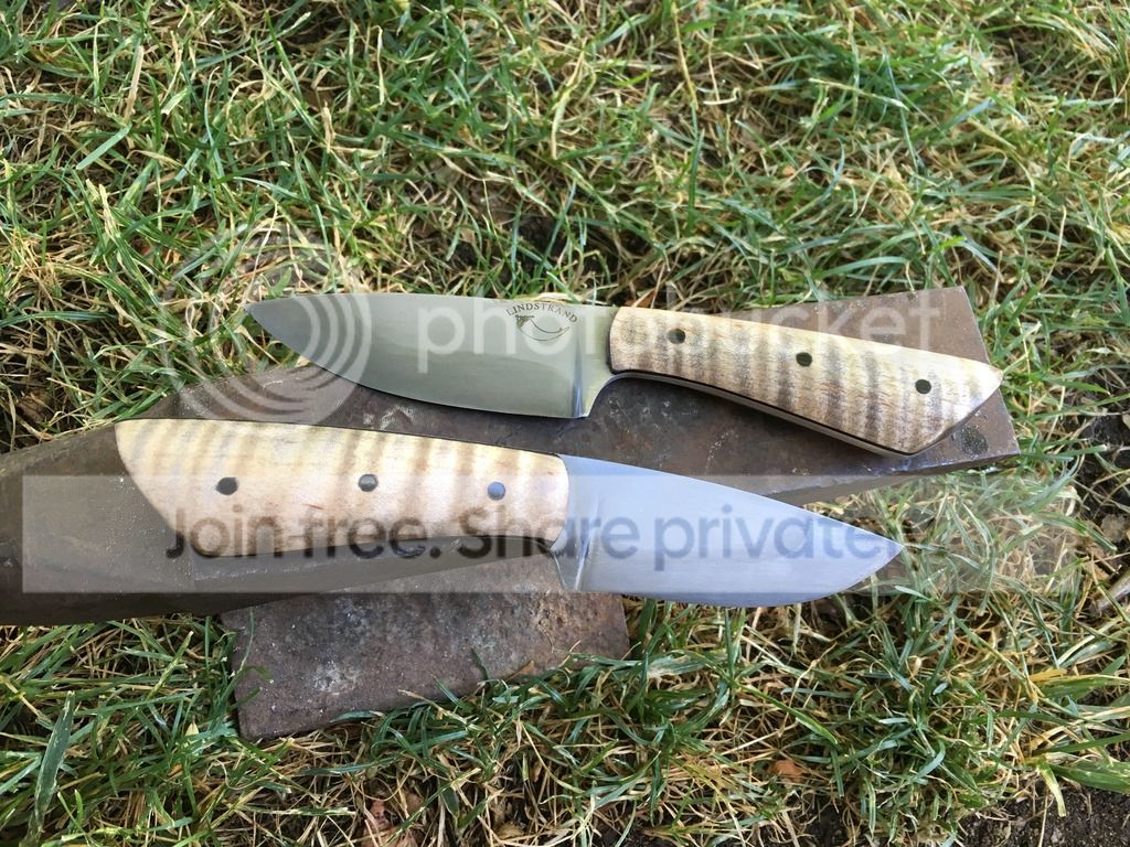

Here's a matching pair I wrapped up last week. these pictures were taken before sharpening. These were from 1095, differentially heat treated with clay, with figured maple handles and G-10 liners. The overall length was just under 7 inches. Basket weave tooled sheaths are wet formed and fit the knives very snugly. I'm learning a lot about knife making and still have a lot of learning left to do, but am really enjoying it.

Funk Coaster- the pins are carbon fiber, available at hobby shops. I personally like them more than metal pins.
Ya got pics of the back of the sheaths too? You're welcome.
I don't, and the customer already has the knives, otherwise I'd take one and post it. They are tooled on both sides, and belt loop is stitched on in a simple box pattern. I'll take pictures of the back on the next on I do!
By the way, your tip on overlaying the prongs of the basket weave stamp has made a huge difference, thank you for that!
You bet. Good deal. I'd like to see a bit of a space between the camo and the stitch line, a border.
