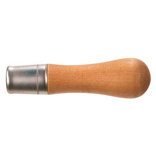

And dont Forget this...
http://www.lowes.com/lowes/lkn?action=productDetail&productId=90599-273-21524&lpage=none
You might discover the file is faster than the 1x30
