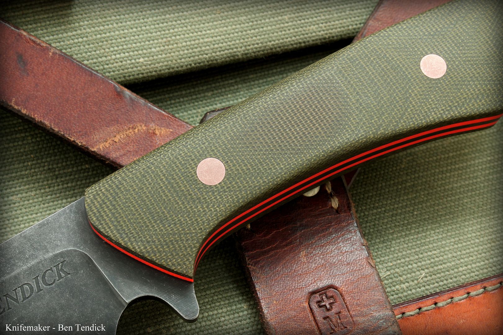

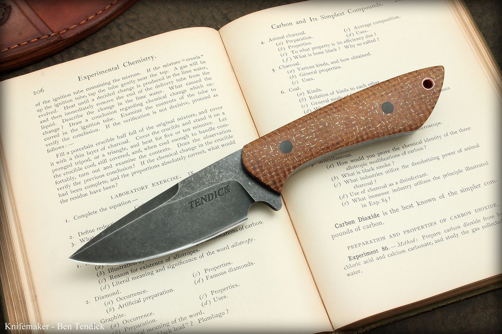

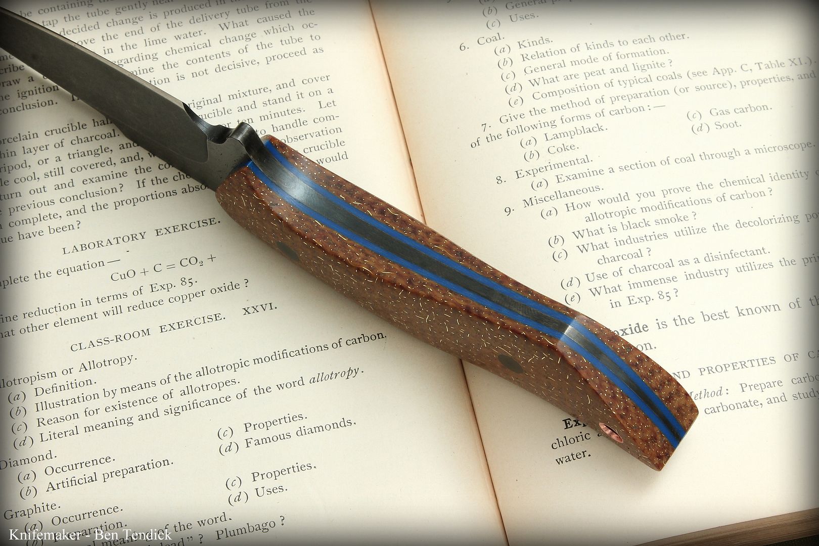

Just finished these two up, nothing fancy, just nice users. The steel on both is 80crv2 at 60rc. The tangs are thinly tapered and I gave them bright liners for a splash of color.

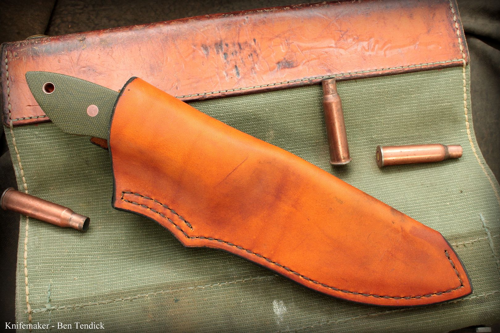

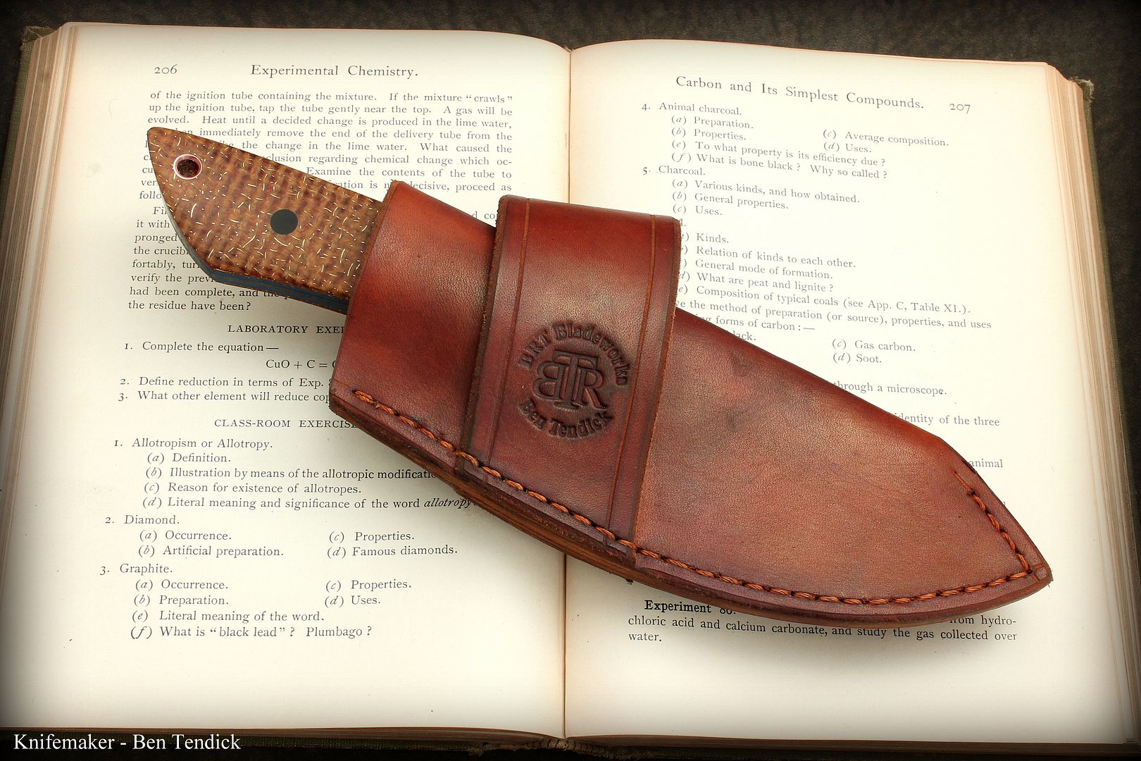

Both sheaths are hand stitched, the horizontal one I used kevlar thread just for the heck of it. : )
As always, any and all comments welcome. Thanks for looking!!

To the experienced craftsman these might seem like "nothing fancy", however to me, the inexperienced newbie, these look like perfection! I pour over photos like these, dissecting the nuances that i need to work on. I love the blue liners, Bravo!

Really nice knives, Ben. I'm really liking 80crv2. How did you do the forced patina and what is your experience with durability and maintenance of the finish?
Thanks Ben. I actually use different types of cold blue on my carbon steel blades, on these I used caswell black. Its not DLC or ceracoat, so it will show wear. The nice thing is it is easily touched up or refinished if desired.
