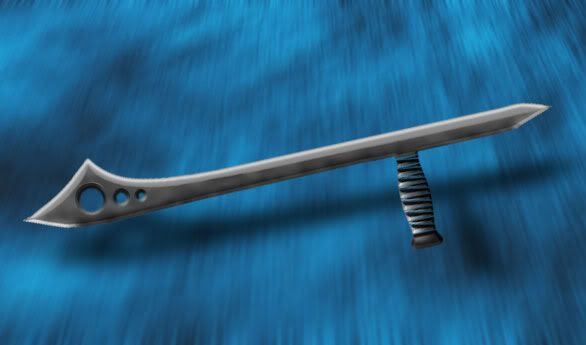

Is this kind of like the tonfa you are imagining?
A few small differences, but that does look pretty close. Did you make that picture or did you find it?
I made it. I thought some speed holes might help for whipping it around, and to lighten the wide end.
Holes are something I have considered. :)
I've been debating whether where they should go, however.
The tradeoffs for holes in the tail are more speed and less wrist fatigue VS. pure power in spinning and chopping strokes.
On the other hand, the swells I've added to the tail have already changed the balance in favour of those strokes, so returning the balance to normal might not be a bad idea.
I was thinking the simplest solution for a prototype might be to place a line of holes aligned with the centroid (center of mass) so that the balance wouldn't be affected, and then see how things are. This is why I was thinking of fullers or hollows. I expect to be pretty busy in the next few days, but I'll try to crank out a more complex drawing showing the geometry ideas a bit better.

On another note, here is a somewhat more detailed image which I've done up in vectors this time, so changing and adding things will be simple as time goes on. There are some notes included as well.
It is always better to use the right tool for the job. If you are looking for a matching pair, and you want them to look like this photo, then they would be better done if made in a modern workshop. Notice that most of the form appears to be ground from a single sheet of flat bar (about 3/16-inch 5160 would seem a good fit). You do not need forging to bring it to shape, and you do not need someone who would be forced to start with a block of metal the size of a leafspring.
Two suggested changes:
1) Make the handles rounded flats (oval rather then round), so you can index the proper position of the blade by feel.
2) Add plenty of radius to the handle extension to remove the stress point.
(The bowie with a 9" handle comes to mind)
That turned out to be an interesting knife; it looks and feels like a Kutti knife. I wonder if that is how someone came up with the original. :rolleyes: :rolleyes: :rolleyes: :cool:
1)Yes, the ovals were something I was planning on. You want to know where your weapons are without taking your eyes away from what's in front of you!
Also, I think an oval grip will make it easier to hold the tonfas overall.
2) Do you have any thoughts on the shape of the handle 'tang'? Could I get away with something like a oval chiruwa handle? (oval through the thickness, meaning I would need concave wood slabs)
Kaz your design just isn't my cup of tea but I can see why it might be desirable. At one time I probably would've thought it pretty cool myself.;)
Three quarters of an inch would make the devices prohibitively heavy and you wouldn't be able to manipulate them.
A 1/4" would probably be just fine and 5/16" at the most!!!!:eek:
The replica Bowies from Imperial Weapons are just a tad less than 1/4" thick and they are plenty dayumed strong as would be these devices.
N2S has given you some good points as have some of the other guys.
I agree that they don't need to be forged. What little extra strength you may gain from packing the steel would be moot for the design itself.
I'm assuming the part hanging down from the main pointy part is the handle that is going to permit you to swing the device from one end to the other.
If so I'd suggest like N2S that there be a nice radius where it meets the straight part. I'd also suggest that really good well seasoned and preferably stabilized wood be riveted on in the oval shape that N2S suggested.
That's a helluva good idea he has about orienting the piece to where you want it.

I decided to let this thread sleep for a little while I got through my exams, but now I'm bringing it back up to the top.
I was wondering if someone might have some ideas on how to make a sheath/scabbard for these things. I was thinking of something like a tip sheath and 'skate guard' arrangement, but that seems sort of clumsy since it requires a snap of some kind to keep the blade from falling out. It would also be almost impossible to sheath these things on your back if there's a snap involved. Anyway, here's a sketch of my not-so-great idea:
The tonfas would be sheathed tip-downwards, with the handles being somewhere near waist-level.
Also, here's the sketch I posted of the blade a while back -- It's since been decided that the handle will be oval along the long axis of the blade for indexing-by-feel. Just thought I'd stick this here so you wouldn't have to scroll around to refresh your memory.
