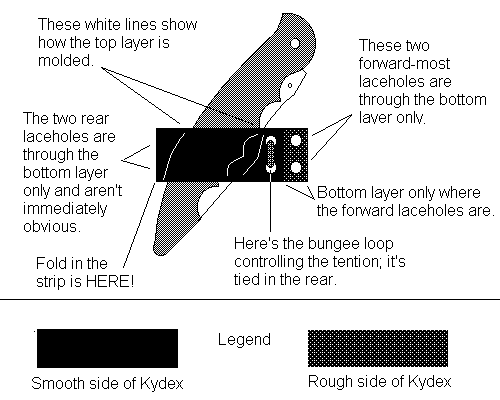

A crude picture:
Guys, no joke here, this is a FAST rig. You pinch it just behind the pivot with your thumb between you and the grip and you just snap it upwards...you never need touch the thumbstud or even the slidebar. The pic above is how I did it for strongside right carry but you can reverse for southpaw easily enough. Once built, you tie it onto your belt with leather lace, paracord or whatever and then slide the belt on and off.

Maybe this pic will help:
Instead of a "cutaway view", this is much closer to how it actually looks. You'll need to refer to both this pic and the other because in this second view, the rearmost laceholes are shown covered by the upper Kydex layer.
The reason this works is the extreme finger grooves of the Sifu. I've never seen any other knife sheath of this design.

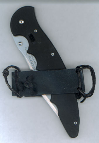

I got pics:!
These are of my personal "Mark1" proof-of-concept version. Later ones will be cosmetically improved (no wrinkles on the outer face caused by glove seams, fr'instance) but this shows how it works.
Front view: this is how it looks on the outside face away from the belt:
This is the "inside face". Note the knot at the bungee cord; future versions will lack bungee, I'm doing something else. You can see the leather laces all set up as belt loops...
