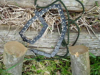

My current saw is a pocket chainsaw. It cut extremely fast and is very small when stowed.

+1 for the pocket chainsaw. They really are as fast as you see in the videos. I take that to cut long logs into more manageable chunks, and then use a fixed blade to baton them into pieces that burn better. I used to take a hatchet, but after several hours of backpacking, I'd rather be swinging a baton than a hatchet in case I miss because of exhaustion. :)
I usually carry a Kershaw/Bahco Laplander saw along with my other gear. On camping trips, especially getting to fall, where larger pieces of wood get left by others, I have used a pocket chainsaw. With two people, when they hit their rhythm, it's awesome.

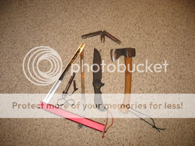

I bring them all.
The knife, multi-tool, and P60 stay with me and the saw and hatchet go in a side pocket on my pack.
I could use my RW for splitting and have many times but I like the hatchet to much to leave it behind plus it makes a better hammer if I need one.
