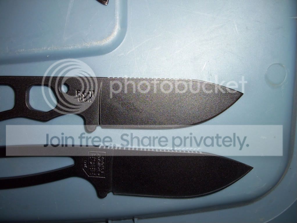

There was a thread back a while ago that brought up the strength of narrow tangs like the Mora, USMC MkII, etc. It was pointed out that with a stick/hidden tang, you never really know what's in there unless you take the knife apart or (as some industrious individuals did) have it x-rayed. After reading and seeing some of the skeletonized "full" tangs on knives, I think this problem also exists for them as well. Heavily drilled/skeletonized tangs would not offer an overall strength advantage over a hidden tang, and might actually be weaker due to the inherent issues with making holes (radius, stress concentration, etc.). Now, I would not know about this if the makers did not show it, just as many makers will show a cross section of their hidden tangs. In general, I think its worth it to do some research before buying if strength is a concern in the use of a knife, and seeing steel with slabs on the sides doesn't always represent what is really under the slab.

I simply prefer full width, full tang knives. I have broken at least 3 M7 bayonet's, chopping wood, while on active duty. Thats what brought me to BK&T. Full width, full tang. There is holes/spaces under the handles on them, but until i break one, i am satisfied with thier rugged construction. I have even batoned wood with the little BK11 & BK14. IMHO, the OKC M7 bayonet is not even close to being HD enough for a soldier. I would not even trust it to not break doing what it was designed for---dispatching the enemy. They break pretty easy IMHO.
I don't think BK&T have the kind of tang I'm talking about. Once the scales are removed, are there a lot of holes drilled there? Their handle scales are hollow, from my understanding, but that's easy enough to fix if you break one, which you probably won't unless somehow need to hit the handle with a baton, or throw the knife a lot.
It's very doubtful that a knife will break inside the handle before something else happens first.
The strength of the tang has more to do with how wide it is when compared to the rest of the blade so the holes wouldn't really matter all that much.
We see this problem with some knives that have been snapped in half, they usually have pretty thin tangs compared to the rest of the blade.
Drilled---NO, but there are factory spaces with no metal. They are kinda like the Remoras & BK11 & BK14 only a little different.

Those BK&T blades are relatively small, and likely not subject to the level of stress that would cause a break there. Also, they are fully exposed. There is no guessing about what you're dealing with on those.
According to Ethan Becker, the skeletonized handles on Becker knives do not reduce the strength of the handle. The do however create the appropriate balance.
