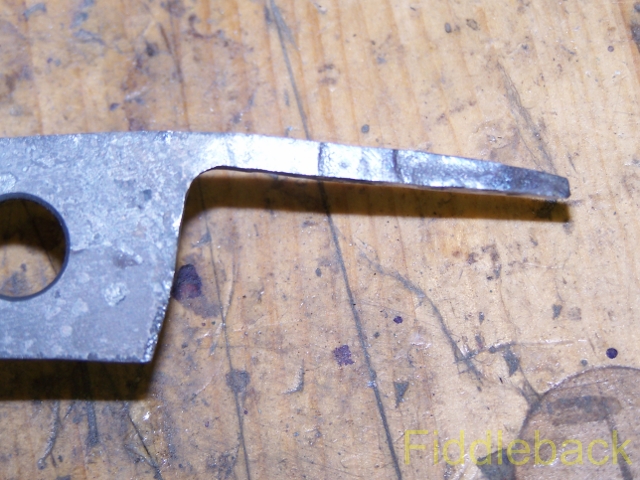

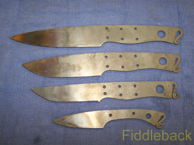

Hey guys, I forged a few more of these things this week. Whatcha think?

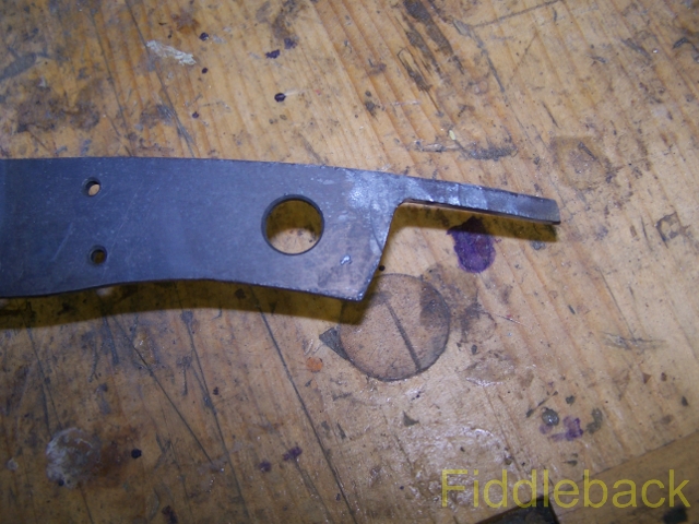

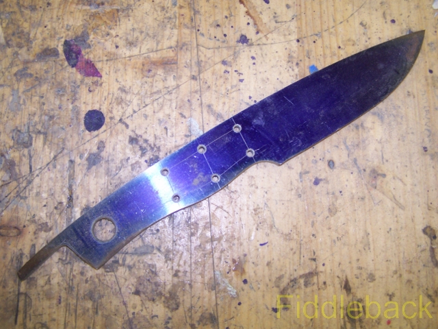

So the first step was to grind the blank to shape and drill it.

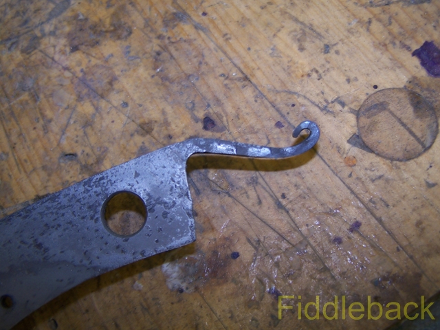

Then I start forging the curley cue from that extra 'tail' that was left at the butt of the knife.

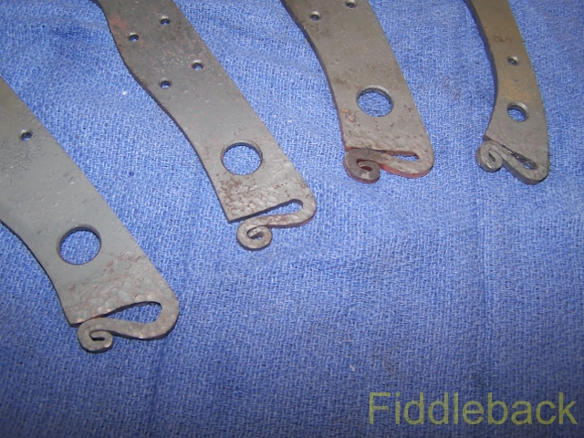

Once its all forged to shape, I go at it with a tiny ball peen hammer to texture it some. I did 4 on that morning.

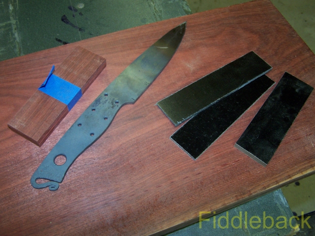

The Woodsman is the top blank.
This is the plank of Bloodwood.
This is all the pieces necessary to make the handle scales.
Thats as far as I've gotten. I'll post more pics as I get further along. Any tips or suggestions welcome!

What purpose (if any, not that it needs one, looks great) does the curly cue serve? Flint and steel striker? Lanyard attachment? Curious. . .
And, yes, I want one - the Woodsman, please.
I love this new direction Andy! I think I need to start saving because I definitely want one like this! Looking forward to the progress!!
Man, thanks guys. IMO, the curley cue is purely decorative. Its not sharp enough to strike a firesteel. You could use it for a lanyard, but I'm still putting in the bullseye tube. I'm going to add it in as a feature. I can do it on knives with square-ish back ends.
I just can't see forging taking over much of my business. I'm kinda shocked its as popular an activity as it is really. I like that the forge makes the shop nice and toasty though.
