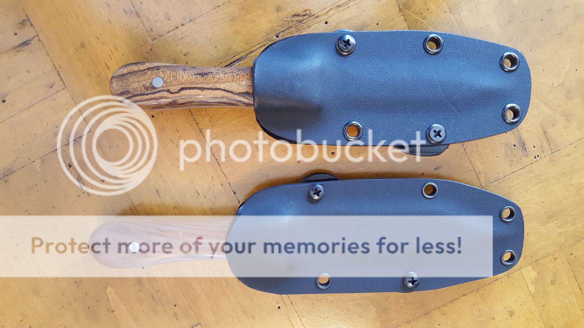

About the knives the dagger is 7.75 inches long and sports a 4 inch double edge blade. The Bowie is 8.5 inches long and sports a 4.75 inch blade. Both are made from Aldo's 1/8 inch thick AEB-L and as I stated right around a Rockwell 61 both are about an inch in height and are mirror finished. The top one has scales made from Chechen the bottom one from Bacote both handles are about 4 inches long and 3/4 inch thick at their widest. They both come with custom Kydex behind the back sheath (modified scout carry) that fit between the belt and the pants in the small of your back. Drop your T shirt over it and the disappear. They are also set up so they can be drawn weak or strong arm. Just change the loop on the back.
