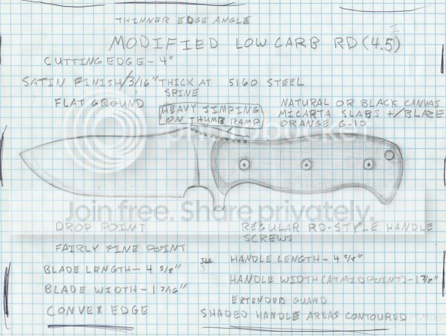

I would especially Like to see #4 i could really see that as a handy camp knife
I would also love to see your AUK 4 with some slightly longer blades like a 5-6 inch area
Anyway the point is you design some really nice practical knives and you would have a market here.

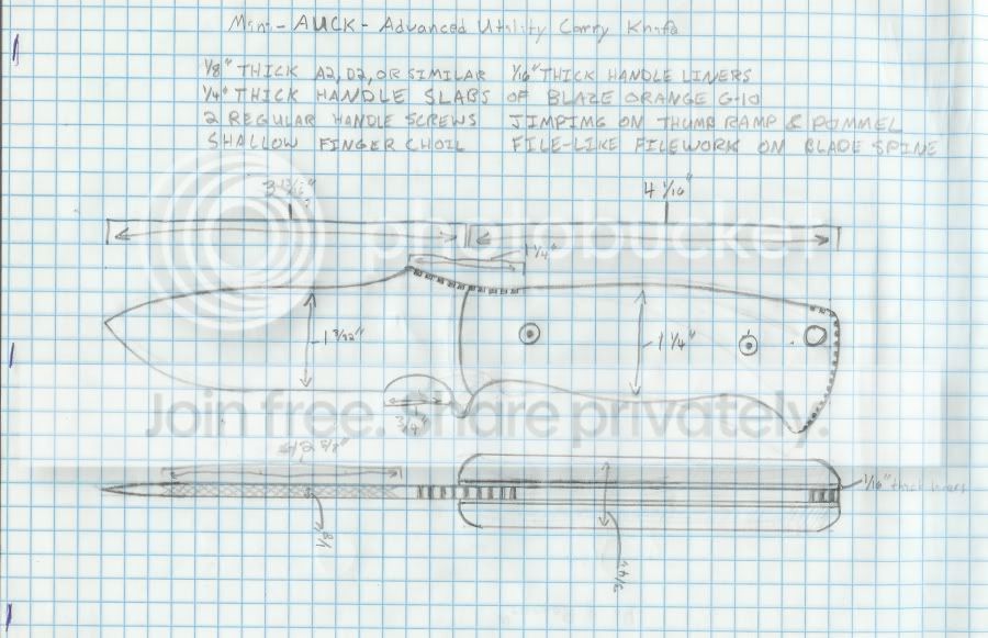

Thanks, RescueGuy, I really appreciate it. I drew up another similar to #4 too, I'll post it farther down. I'll see what I can do working on some larger AUCK designs. The only worry as I get into the larger sizes of that particular design is it becomes much more similar to Justin's RD series. I really respect him as a knifemaker and wouldn't want to infringe on anything there.

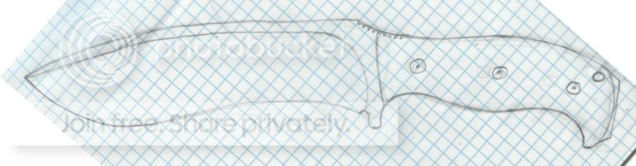

Here are a few more designs I drew up, a couple due to suggestions here. I am working on a smaller Wharncliffe, another larger blade similar to #3, and a fixed blade translation of the Spyderco Native shape, as well.
#8.) This one is due in large part to skammer mentioning a chopper. Recurve, 1/4" 5160, no choil, I still need to draw up a version with a choil. Hammer poll at the butt of the handle, hollow or saber ground. Dimensions: 7" blade, 1/4" thick, 12" overall.
#9.) This is the design for the Mini-AUCK that someone asked about, seems like it was tholiver. Just the AUCK shrunk down a bit, with blaze orange G-10 handles. It would have liners of some sort, jimping on the thumb ramp and pommel, and a file-cut spine. Dimensions: 3 3/4" blade, 1/8" thick, 7 7/8" overall.

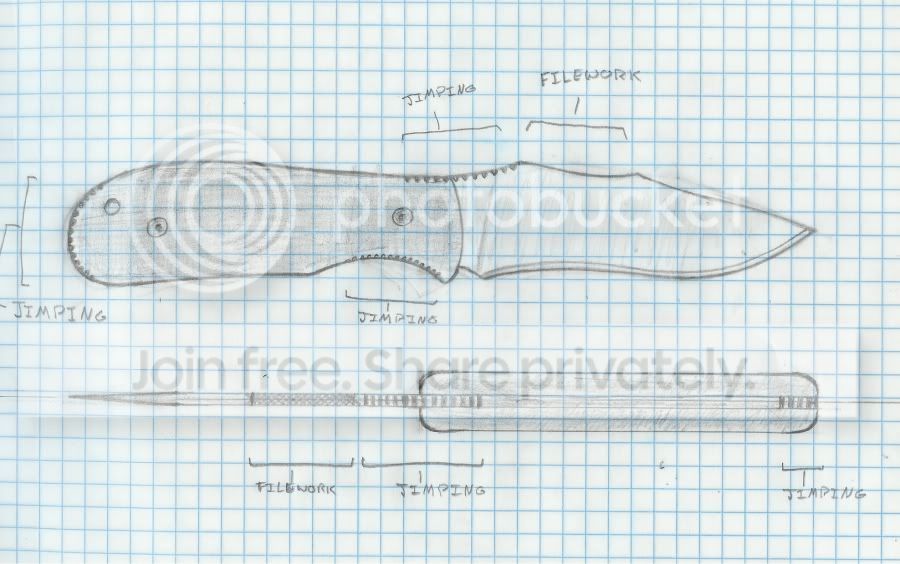

#10.) This one is a touch odd. It's based on a Benchmade Vex folder, though now that's a tad hard to tell. It would have a recurved blade, jimping on both the thumb ramp and pommel, as well as having the scallop of the spine file-cut. Dimensions: 3 7/8" blade, 1/8" thick, 8 1/4" overall.
