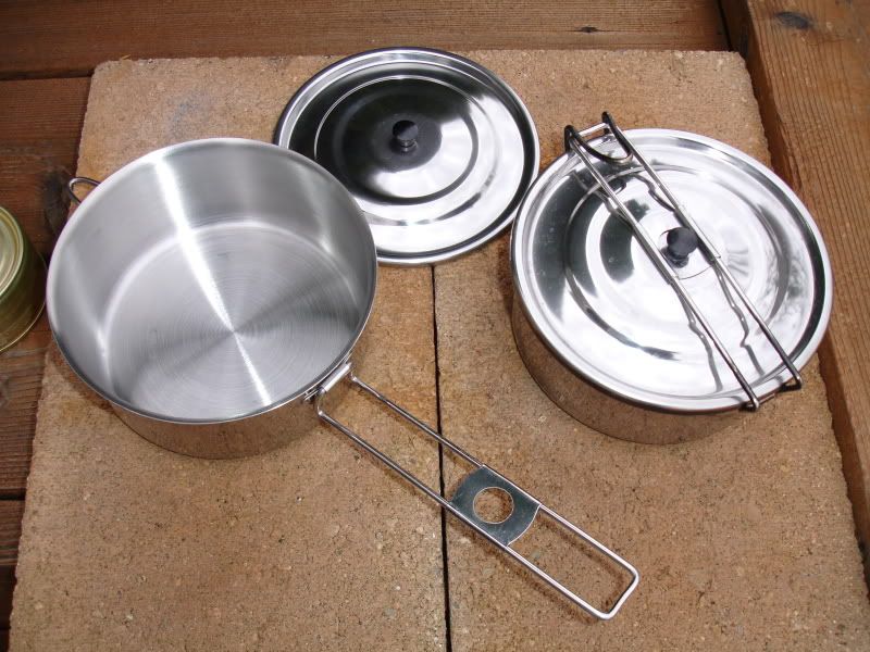

I used these 1 liter stainless steel pots for all my initial tests, in an attempt to level the playing field:

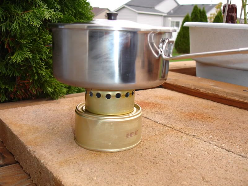

First up was my Super Cat alcohol stove variation. This stove is made from a Fancy Feast cat food can, and is on a larger cat food can that serves as a stand.
Stove: Super Cat Alcohol Stove variation
Fuel: 1.5oz of denatured alcohol
Wind: Calm
Air Temp: 45°
Pot: 1 liter stainless steel with lid
Water amount: 16 oz
Boil time: ~12 minutes

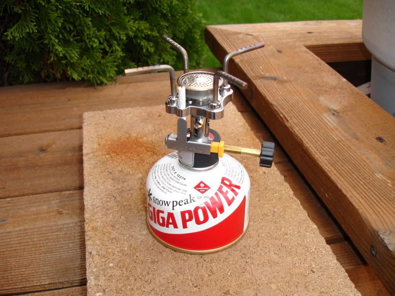

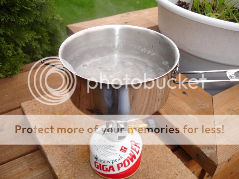

Stove: Markill Hot Shot canister stove
Fuel: Snow Peak Gigapower
Wind: Calm
Air temp: 46°
Water amount: 16 oz
Boil time: 2 minutes 40 seconds

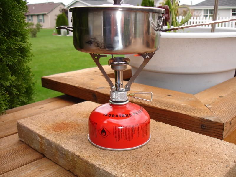

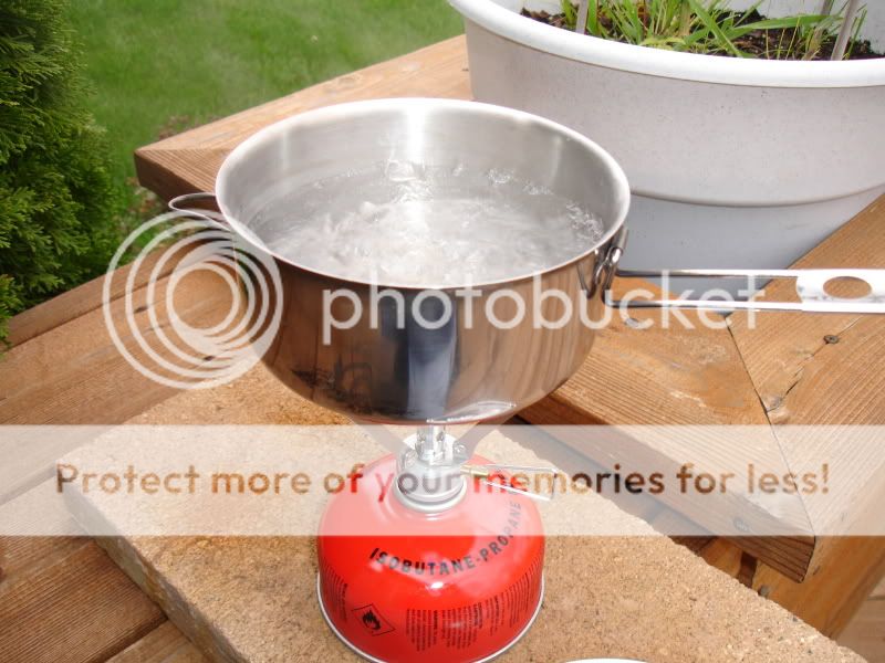

Stove: MSR Pocket Rocket canister stove
Fuel: MSR
Wind: Calm
Air Temp: 47°
Water amount: 16 oz
Boil time: 2 minutes 20 seconds
Here are the Hot Shot and Pocket Rocket, with the different fuel canisters, for comparison:

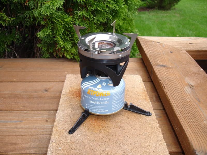

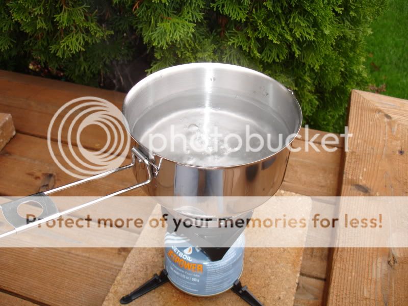

Stove: Jetboil equipped with pot stand
Wind: Light breezes
Air temp: 48°
Water amount: 16 oz
Boil time: 4 minutes, 15 seconds
Comments: I was surprised at the poor performance of the Jetboil with pot stand. Typically, canister stoves tend to lag performance-wise as the ambient temp drops, but the other two canister stoves easily out performed the Jetboil. Was it the light winds that affected its performance? Was it the fuel? I do not know. Because this intrigued me, I let the stove cool for a while, and then I conducted a test with the Jetboil pot. I’ll post that up later.

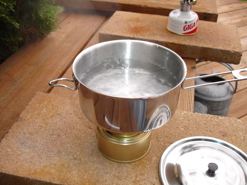

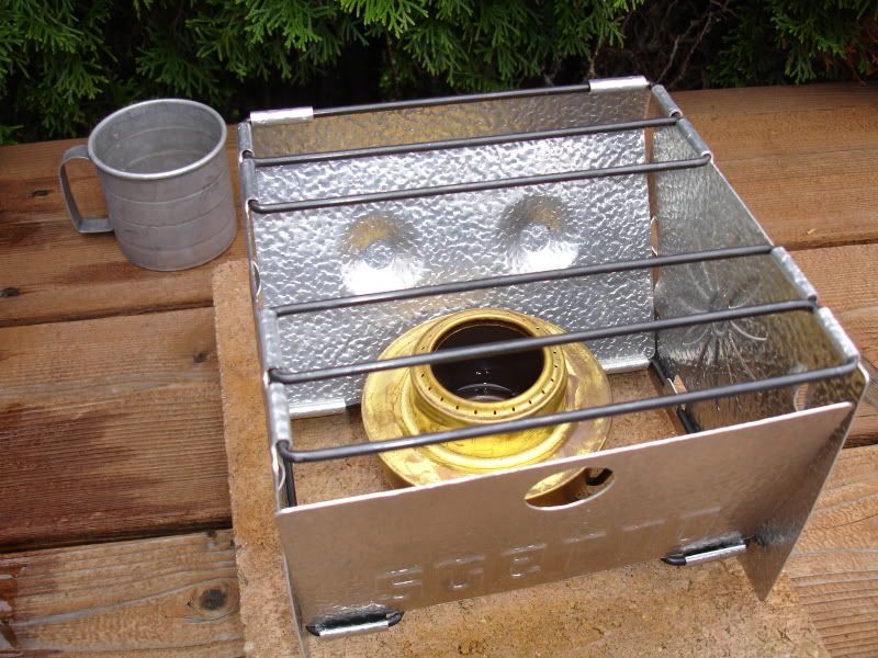

Stove: Trangia Spirit burner from Swedish mess kit in a Sterno stand thingie
Fuel: 2 oz denatured alcohol
Wind: Steady light breeze
Air temp: 48°
Water amount: 16 oz
Boil time: 13 minutes 10 seconds
Notes: I don’t have a proper universal pot stand for use with the Trangia burner. I decided to try the Spirit burner in this Sterno stove stand that I found at a rummage sale this past summer. The Sterno stand seemed to work OK, but would have probably worked better if I could have positioned the Trangia burner a little closer to the pot.

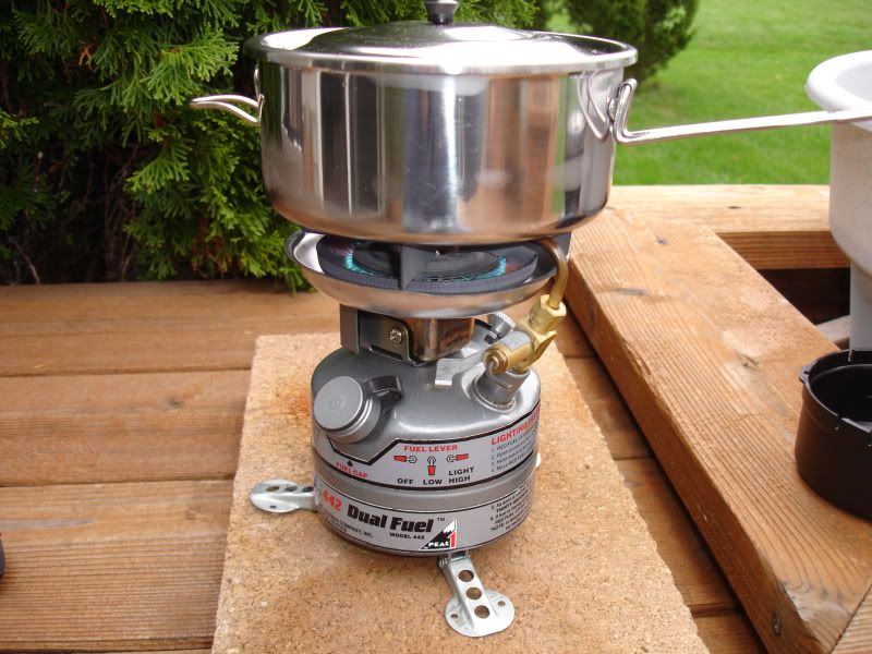

Stove: Coleman Peak 1 Feather 442
Fuel: Coleman white gas
Wind: light breezes
Air temp: 49°
Water amount: 16 oz
Boil time: 2 minutes 15 seconds

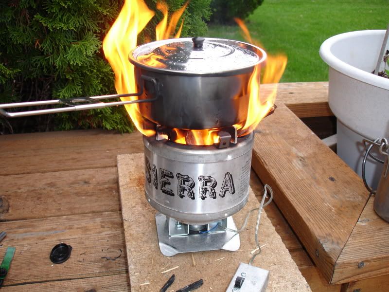

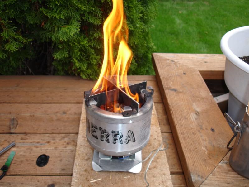

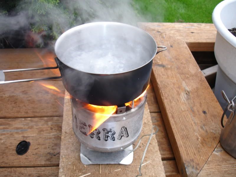

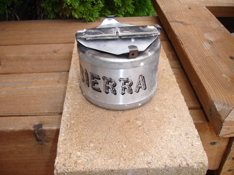

Stove: Sierra Stove with homemade pot stand
Fuel: Cedar
Weather: Light breezes with light rain
Air temp: 51°
Water amount: 16 oz
Notes:

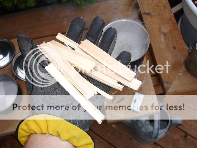

For those that aren’t familiar with this stove, it is a wood/other solid fuel burner, with a battery powered fan assist. The battery pack I have takes a AA battery, and has a switch allowing lo/off/hi for the fan.
I haven’t used this stove for a while. I used cedar as fuel because it was handy at the time. If memory serves me correctly, boil times with mixed found downed fuels have been longer, but not by much. The key to quick boil times with the Sierra stove is to get the fire really going first, and then put the pot on.
I made a pot stand out of aluminum angle iron to allow feeding of the fire while a pot was on. A few cedar pieces were fed into the stove during this test.
Pic of cedar pieces used in Sierra stove:
The Sierra stove is great, but it really blackens the pots. I did not used the dish soap trick to reduce pot blackening for this test.

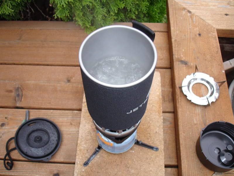

Jetboil PCS for comparison
Stove: Jetboil (with its own pot)
Fuel: Jetboil
Wind: Light breezes
Air temp: 50°
Water amount: 16 oz
Notes:
I have used the Jetboil setup in summer/ warm temps, and I have achieved fast (less than 2 minutes) boil times for 16 oz of water. The fancy heat exchanger on the proprietary Jetboil pot seems to have made a marginal difference in today’s temps/conditions. Really though, I can’t help but blame the nature of the fuel as the main contributing factor of the Jetboil. I have used canister stoves in ambient temps such as those experienced today before, and I have found that if I wrap my hands around the fuel canister in an attempt to warm the canister while the stove is going, output is increased, and water boils faster.

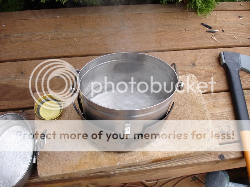

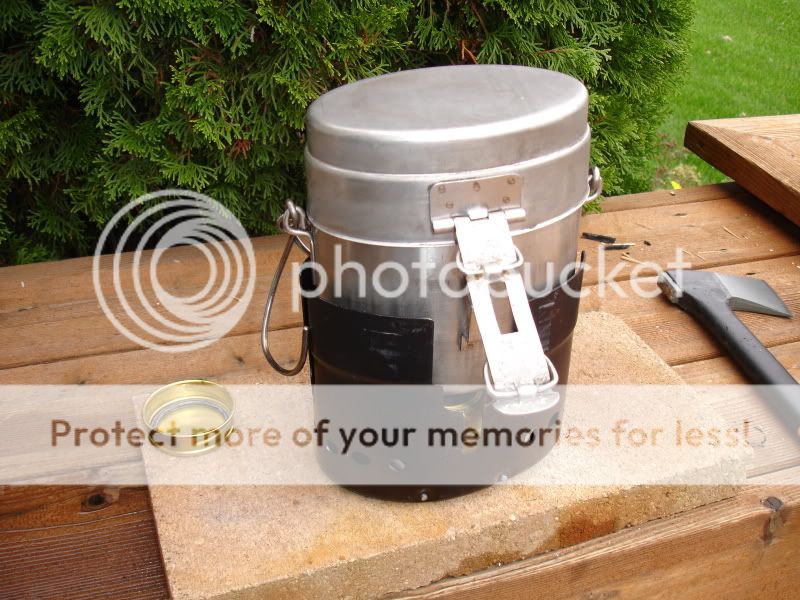

Stove: Trangia in Swedish mess kit pot stand
Winds: light breezes
Temp: 51°
Pot: Swedish Mess Kit stainless steel pot with lid
Water amount: 16 oz
Boil time: ~9 minutes

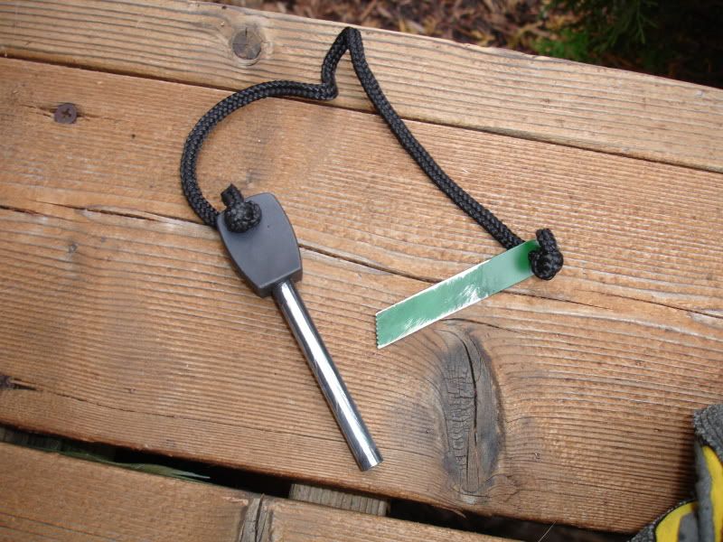

All stoves were ignited using a Mil-Spec Plus fire steel, procured through The Sportsman’s Guide. These have always worked very well for me (after some minor adjustments to the scraper):

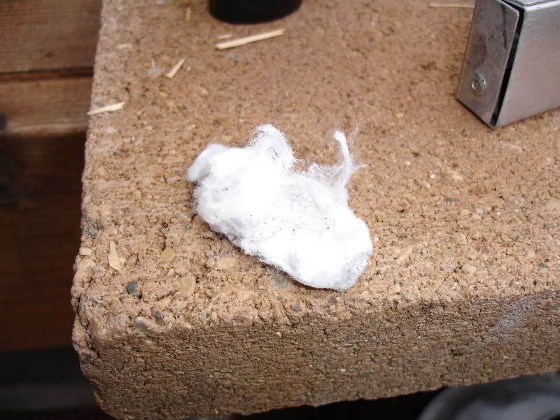

The Sierra stove was started with a cotton ball I had partially saturated with melted candle wax and stuff in a plastic film canister several years ago. The wax made for a hard cotton ball thingie, but since the entire cotton ball wasn’t full of wax, it did put apart nicely to expose lots of little fibers which took the first spark off the steel.
It burned plenty long, and I did not need any other tinder to ignite the cedar pieces.

Great review! I love my Sierra Stove. Soot is a problem, but I overlook it because I really like being able just use whatever fuel is laying around. Works really well with charcoal, too; a few pieces are pretty easy to tote just in case dry stuff would be hard to find. Cinders from old fires work as well. That Coleman has been on my list for a while too.
