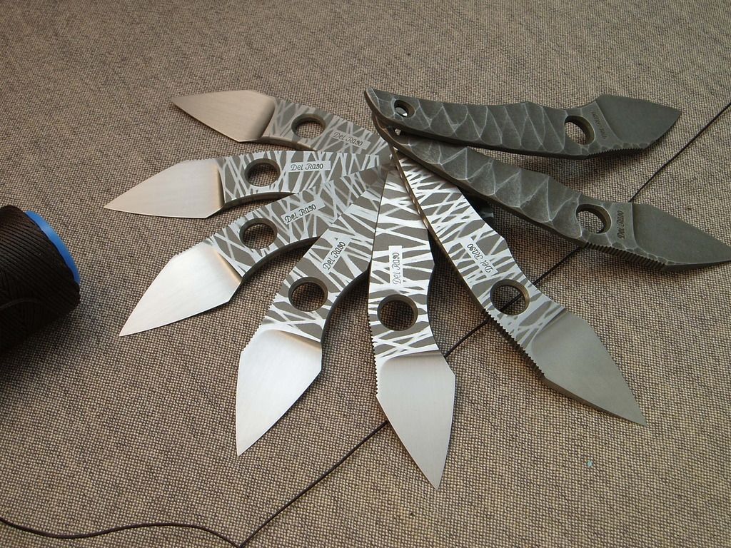

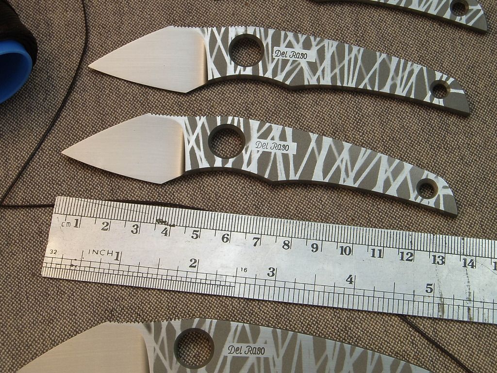

A bunch of integral "Beastie" EDC's that I think would work well as neckers. Blade steel is ATS34, bevels are hollow ground.

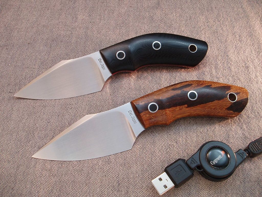

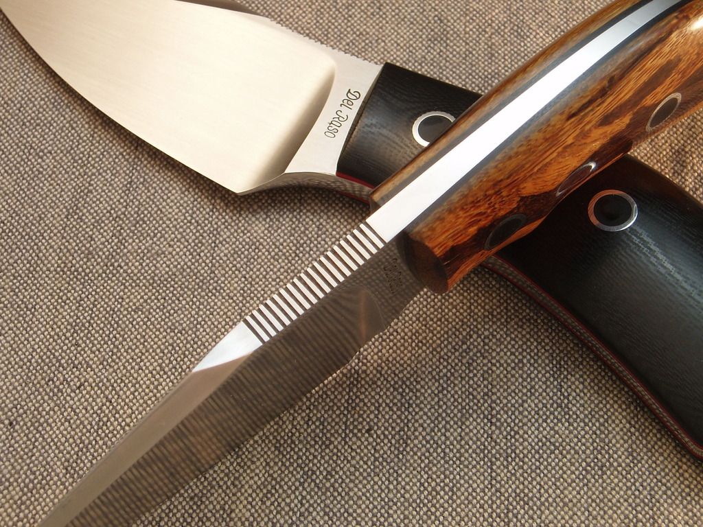

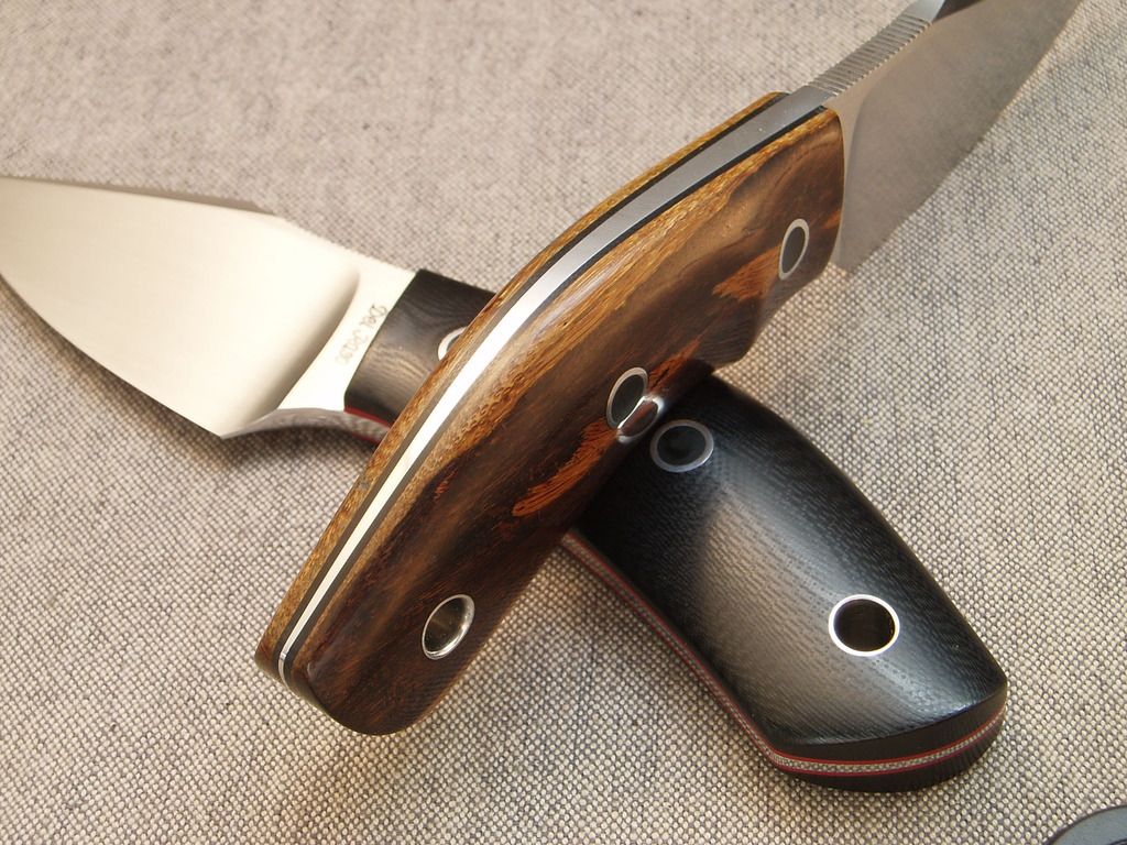

Also a couple of "Grunts". Hollow ground ATS34 with full tapered tangs. One with black G10 scales and the other with stabilised bamboo scales. 600 grit hand satin, clips are ground to zero. OAL 7 1/4" with a 3" cutting edge. Hope you find them interesting and thanks for looking. Peter.
