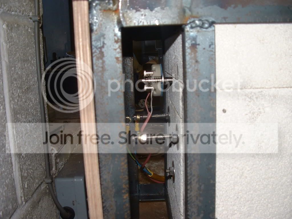

This is how I handled my control box, when I build something the first word I think of is "free" and then "better", I ran my fan off from a 12 volt power supply/adapter, I'm sure everyone has a box full of those laying around ;0) The second thing I did was to use rigid wire for the element connections, I'm so afraid of wires rubbing against stuff and causing a short, and the third thing I did was to move the element connectors around to the side so there is nothing sticking out the back that will give you a shock, and no wires that can get caught on something when you move it around, more photos here http://www.bladeforums.com/forums/s...-bit-about-your-work!?p=12725618#post12725618
I used longer stainless allthread through the walls for the element connections on my first 2 or 3 HT ovens. The idea being that the extra length allows the use of normal cable because the cold end is reasonably cold. It seems to work.

Thanks for the pictures guys.
John:I like the idea of having the elements come out right in the control box I had already been thinking that but know that I know someone has done I think I will for sure. but why use bolts why not just stick the lose ends of the element right through?
If you stick the kanthal wires inside the box you will have flaming hot wires inside the control box, the stainless steel bolts have far less resistance then the wire and only get slightly warm

This wiring looks good at first. But if on notices, the TC wires are paced between two hot high voltage metal studs. It should be apparent that the TC wires should be routed another direction. From an electronics POV, pacing a DC millivolt line through a AC loop is also not good.
Good spot Stacy. It was the only photo I could find of the long studs.
It was very much a Work In Progress when the photo was taken.
The themocouple cable actually comes out of the top and the AC cable comes out of the bottom in the finished article. The power cable is now also glanded for strain relief.
