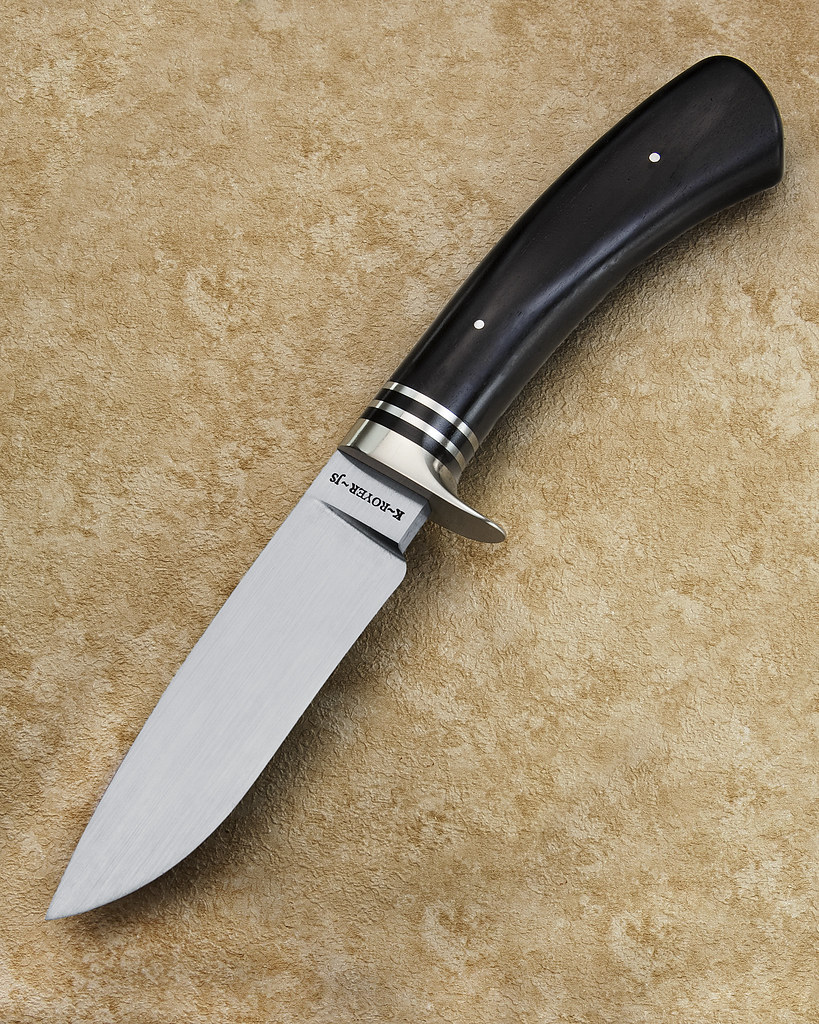

First up is a simple hunter with a 4" 5160 blade and a little re-curve. The handle is Ebony. The fittings are German Silver and there are Micarta spacers near the guard.

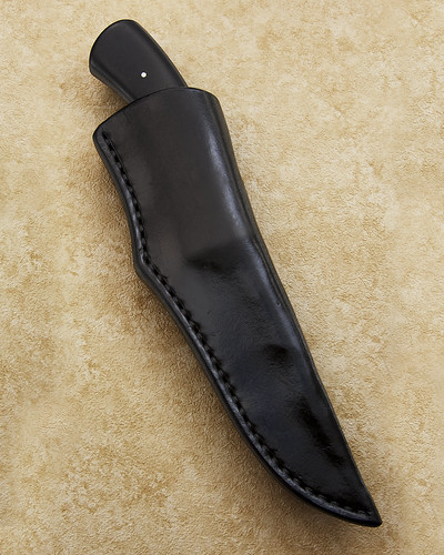

Here is a simple sheath for the hunter. The fellow who ordered this knife breaks in new horses so he wanted an extra deep sheath so the knife wouldn't come flying out and get lost somewhere.

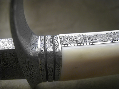

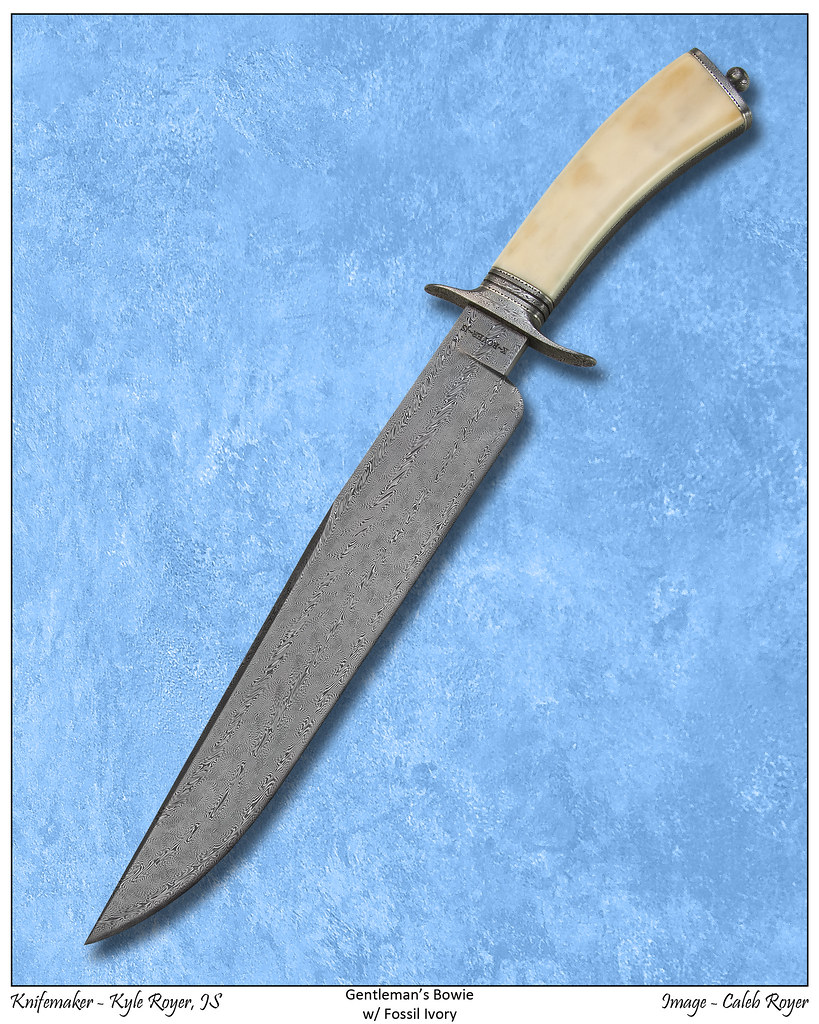

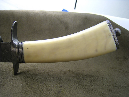

Here is a Bowie with Four bar "W" Twist Damascus 10" blade. The handle is fossil walrus ivory. The fittings are "W" twist damascus also. The liners are of German silver with "Explosion" pattern file-work. The overall length is 15"
Here are some detail shots of the bowie.

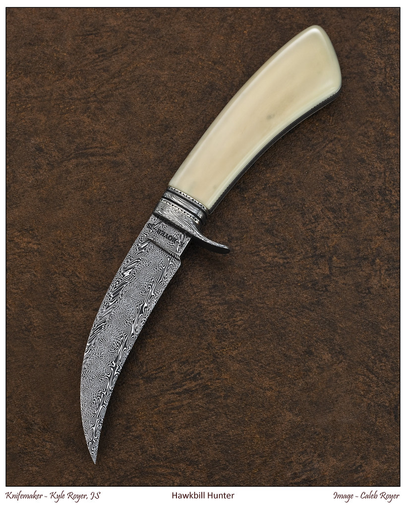

Here is one of the most unique knives I've made. It's a Hawkbill with 3 1/2 "W" twist damascus. Fossil walrus ivory handle. The fittings are "W" twist damascus and it has German silver liners with "Explosion" pattern file-work. This knife and the above bowie are a set. This is the first Hawkbill knife I've made and it's the first set I've done. The blade was a little tricky to grind due to the aggressive drop to the edge.

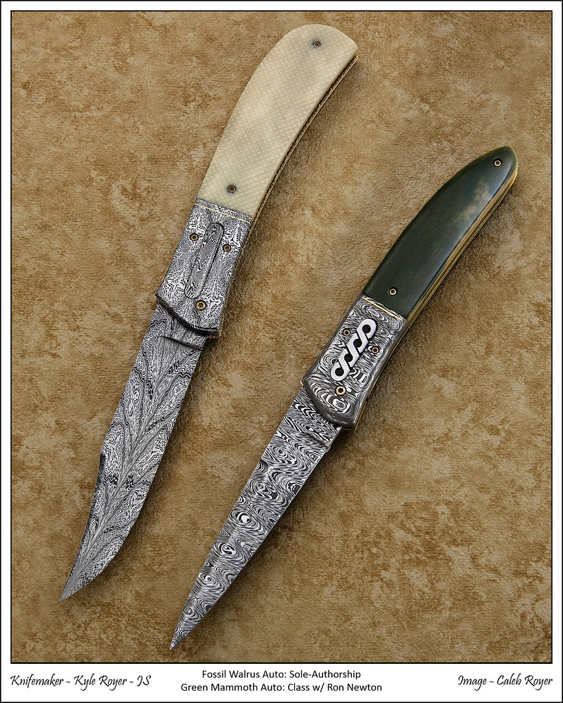

Last October I took a class with Ron Newton at his shop and he worked step by step on a folder and after each step I would do the same to my folder. Mr. Newton worked with me like this until the last two days of the class when he took over and worked on finishing my folder (I was not going fast enough to finish it in time). By the way the folder I am talking about is the one in the picture with green mammoth ivory. I'll describe the class auto here and then I'll give the story of the other auto with the next picture.
The Class Auto I made under the tutelage of Mastersmith Ron Newton has some of my premium Green Mammoth Ivory. I made the damascus in a Laddered "W" pattern. The blade is 3" long and the overall length is 6 7/8". The trigger is 416 stainless steel with a little Ron Newton classic file-work. The pattern for this knife is one of Ron's. There are also titanium liners that have been anodized to a gold color. The damascus bolsters have 24K Gold inlays. The spring on the inside of the knife is plated with 24K gold and the screws have been heat colored. The pattern on this knife is mostly of my own design with a little influence off of Ron's pattern. I had a great time with Ron and I am looking forward to taking another class with him at the end of this year. Ron's class was wonderful!

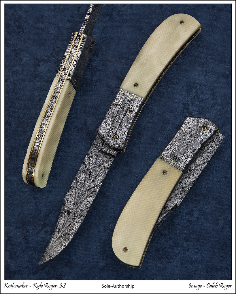

This is a knife I just finished three days ago. It is my first sole authorship auto folder. The bolsters are of "Modified Star Burst" pattern damascus and feature 24K gold inlays. The 3 1/8" blade is a new pattern I've never done before and it's name is a little long so here it goes, it's "Modified Star Burst, Feathered Mosaic" pattern. Basically it's the pattern on the bolsters that's been feathered. The handle scales are fossil walrus ivory that's been checkered. The titanium liners are anodized a golden bronze color and have "Explosion" pattern file-work all around. The spring on the inside is heat colored to a golden bronze color as are the screws. My makers mark is on the damascus backbar down inside the handle. This is the first knife I've done checkering on. I will have both of these autos at the Blade show on display so you can see them in person.

Those autos are WOW! Love 'em both. The shapes, materials and details are real eye catchers. Especially like the bolsters and checkered scales on the Walrus knife. Can't wait to see them at Blade.

The "sole authorship" auto is absolutely fantastic! The "green mammoth" auto is very nice as well. Too bad autos are prohibited in Belgium...:(

Fantastic knives Kyle! Fro the looks of your folders, I'd say you paid pretty close attention to Ron's teaching:thumbup::thumbup:!Caleb's doing some fine work with his photography as well!

The feathered mosaic damascus pattern on that checkered ivory auto is just fantastic. And do I ever love that carbon steel hunter - super clean lines and flawless finish can really make an otherwise simple piece really stand out.

I'm making a sheath for the hawkbill today. I will try to post pictures on a regular basis like I have done in the past.

The Auto Folder is beautiful and I know from examining your green mammoth auto that its lock & fire is as impressive as the rest of the knife. Perhaps, most amazing is your ability to master new processes as the checkering looks flawless.

I knew something was up after not seeing you on the forum except for buying ivory over in the materials for sale threads. Outstanding work Kyle. The folders are a big step forward.
