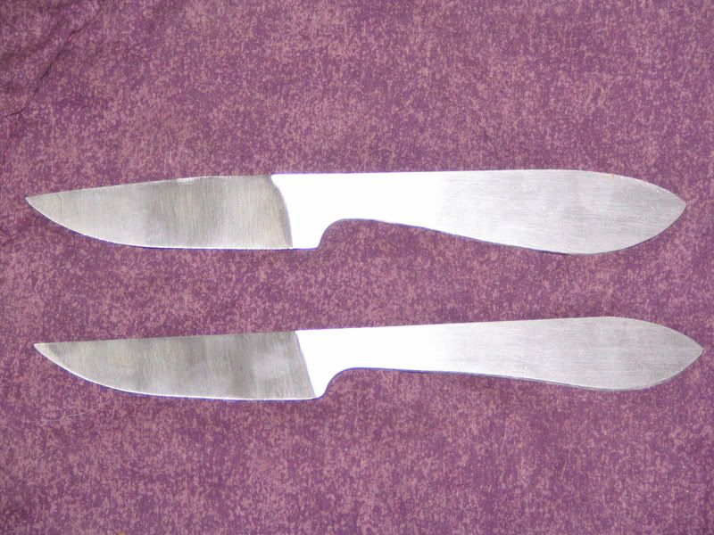

After realizing that I got the wrong paint stirrers, small ones cupped too bad to be of any use, (Sorry Will I should've re-read that post) I decided to go for it with with my O1. What great time I was having working with this steel
! Of course I did make all of the rookie mistakes but took everyones advice and ditched the tool rest and went totally freehand after profiling. Tool rest just seemed to be in the way anyhow. This first grinding session was a great learning experience for me and I damn near got a pretty decent blade blank on the first attempt. Aside from getting the edge too thin, running the grind a bit deep on the spine, putting several nice gouges in the side and top of the blade, and running my plunges too far towards the handle for the profile of the blade shes about perfect.
( I really don't mind if someone wants to use that statment for their sig line, LOL) I did however start my first blade with a design large enough to re-profile into a paring knife just in case this sort thing happened so all is not lost and I think tonight I'll end up with usable blade. Now for the questions-
1. For stock removal method should I be grinding the distal taper before the bevels or develop it while grinding the bevels? I ground it first and ended up very thin on the belly of the blade.
2. My O1 turned some pretty colors and seemed to surface rust right out of the quench bucket. Is this normal? and I dont need to worry about how hot I get it before HT right?
3. I've used three different belts and they all seem to very slightly wobble side to side maybe 1/16" . Hoping this is normal, Klingspor SC belts.
