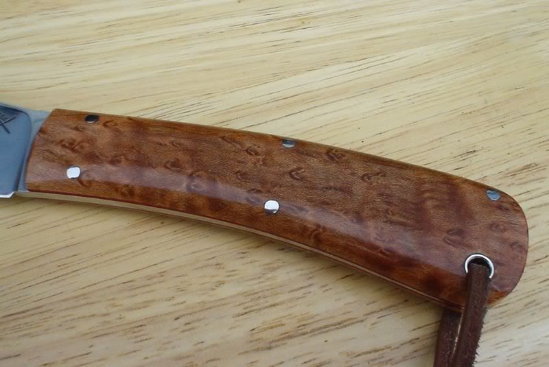

David, that hunter is beautiful, I love that wood.
Thank you very much Ralph :) The wood ???

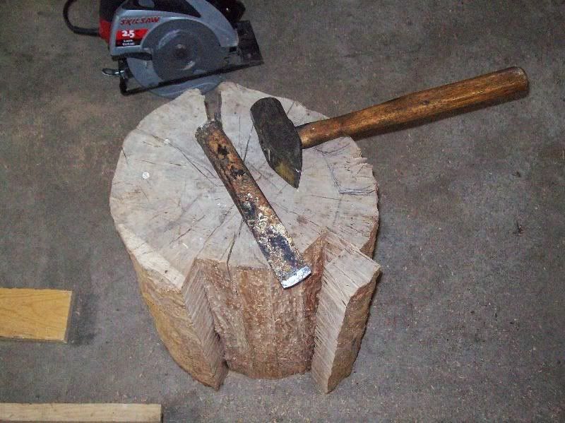

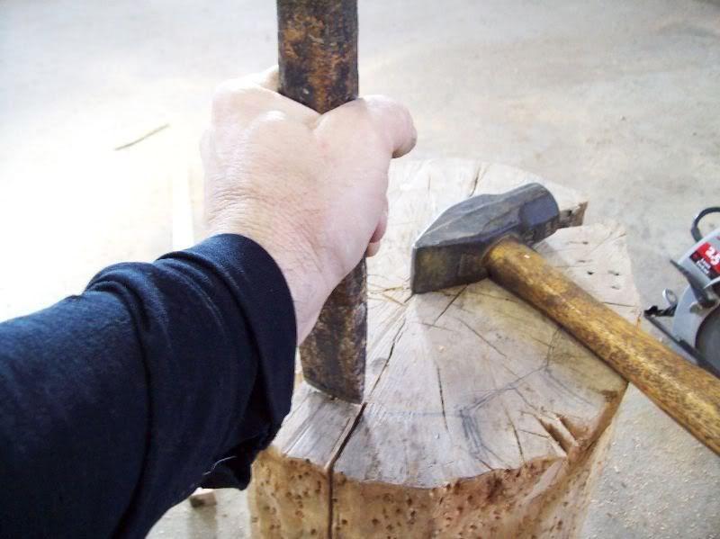

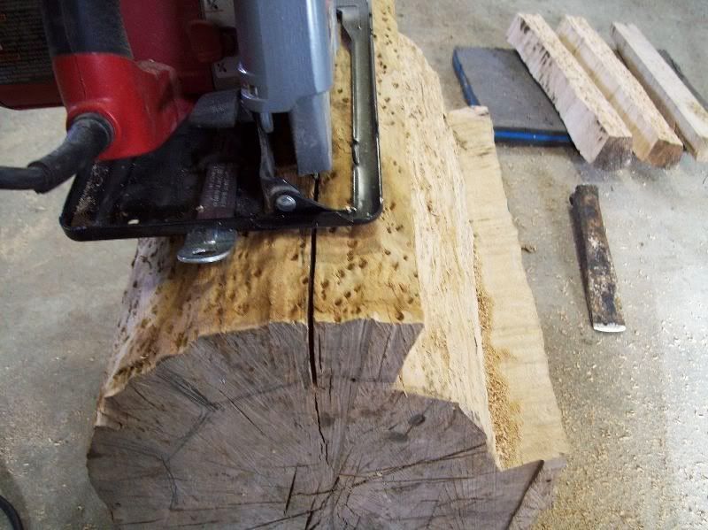

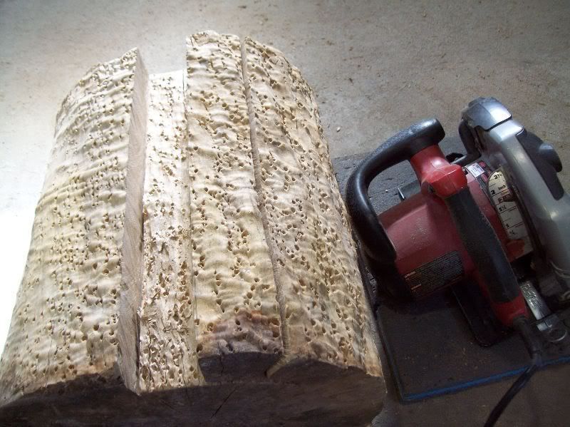

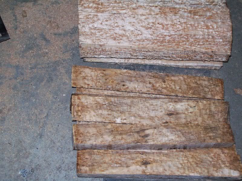

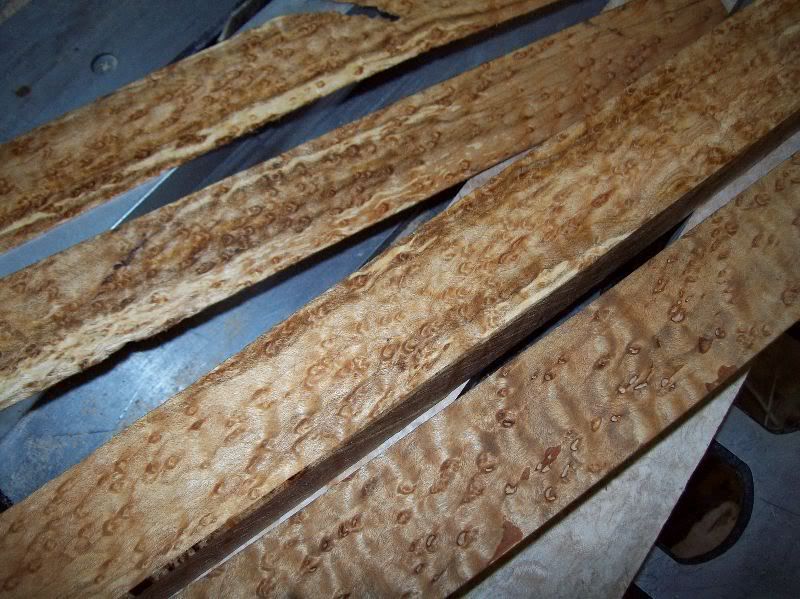

Here's the story, as told to a friend/customer, about the wood scales on the attached pic of a nessmuk I recently made using the same wood as is on the drop point hunter you like.
The wood is a piece of old twisted Birdseye Maple. I sent it out to wssi for stabilizing and also a staining process called chroma-brown. Here's the pretty cool story behind the knife handle(s). When we bought our farm (about 15 yrs ago)(its been here for about 128 years now ) there was a really old anvil in one of the barns. It was sitting on an old log about 2' long. The anvil sat in the barn, on that block of wood for years...... until I started making knives : ) I made a new stand for the anvil (one of which I forge knives on today) and tossed the old log in the corner. It sat there for several more years, until this last winter when I started using it as a splitting block for kindling in my shop. Finally, when I was getting low on firewood this past winter, I decided I was going to burn the block in my shop wood stove. Before splitting her up I knocked some of the bark off. Thank Goodness ! Underneath that bark was the most beautiful Birdseye log I've ever seen : ) Just full of eyes, some spalting and burly twists too ! I promptly cut it into knife handle size blocks and have been sending out small batches to get dyed & stabilized. The chroma-brown process really brings out the beauty. I have some stabilized as "clear" too, which are also really nice, but not quite as nice as the chroma-brown ones, imho : ) I attached a couple of pics showing the log being cut up. What a joyous find it was : ) No telling how many decades the anvil had been sitting on that block. The bottom of the log was in pretty bad shape from sitting on the dirt floor of the barn for so long, but, for the most part the rest was perfect.
