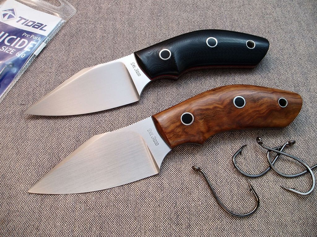

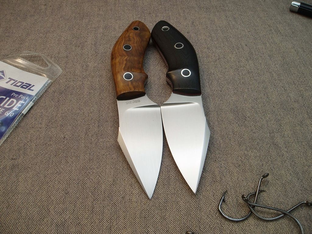

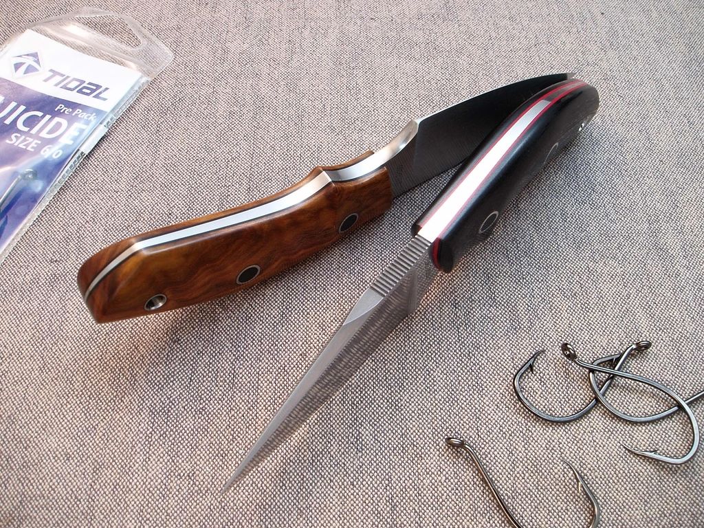

First up are a couple of "Stubby Boot" knives. An old pattern with a revamped blade shape. Black G10 and Australian Belah scales. Steel is ATS34 with a hollow grind. 7" OAL with 3" cutting edges.

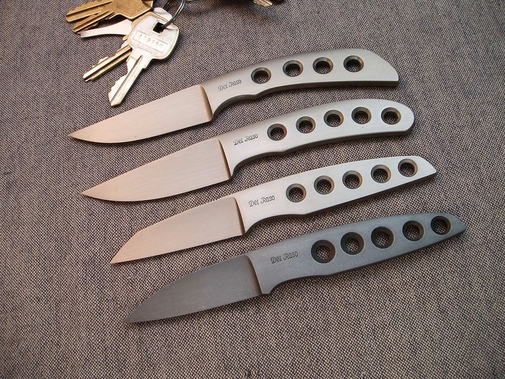

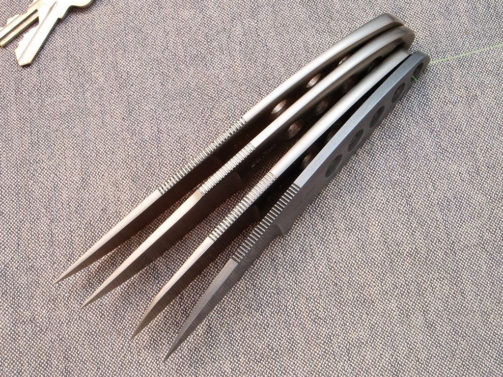

Second lot is a group of small integral utilities/neck knives. Top two are CPM154, other two are ATS34. Bottom one has had a short etch in ferric. Blades are between 2 1/2" and 2 3/4" and all hollow ground. Hope you see something you like and thanks a bunch for looking.
Great job....those Integrals are superb. [emoji106][emoji41]

Dawkins, the second one from the top is the pattern I have carried every day for the last 3 years. Set up in a horizontal carry sheath, it is a very handy bit of kit.

Those Stubby Boot are really awesome - the design looks really good and the distal taper on the tang is a lovely (and practical) touch.
