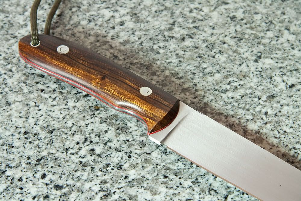

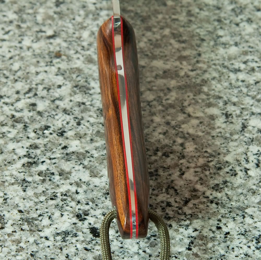

This one is ATS34 - Paul Bos HT , flat ground with a nice distal taper , tapered tang , desert ironwood with red liners. Hand satin to 400 grit. 10 1/4" OAL , blade 5 1/4". For me , this is a large knife , I tend to make more of the 3 - 4" knives.

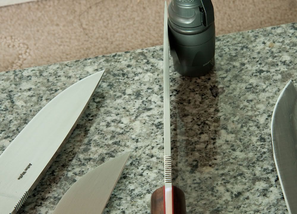

tapered tang
distal taper

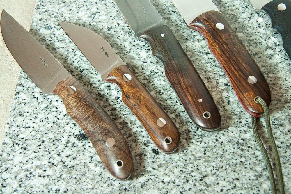

Next is a a wharnny in D2 with Paul Bos HT, with tapered tang , ironwood scales with red liner. The wharnny is 6 7/8" overall , with a just under 3" blade. This one is going to a JD member who was been patiently waiting.
This model was inspired by Trace Rinaldi's Matrix model , which is my favorite EDC wharrny I have ever handled , been carrying mine for 3+ years. Trace did give me his blessing since it is different enuff to stand alone , and is no competition for the Matrix.

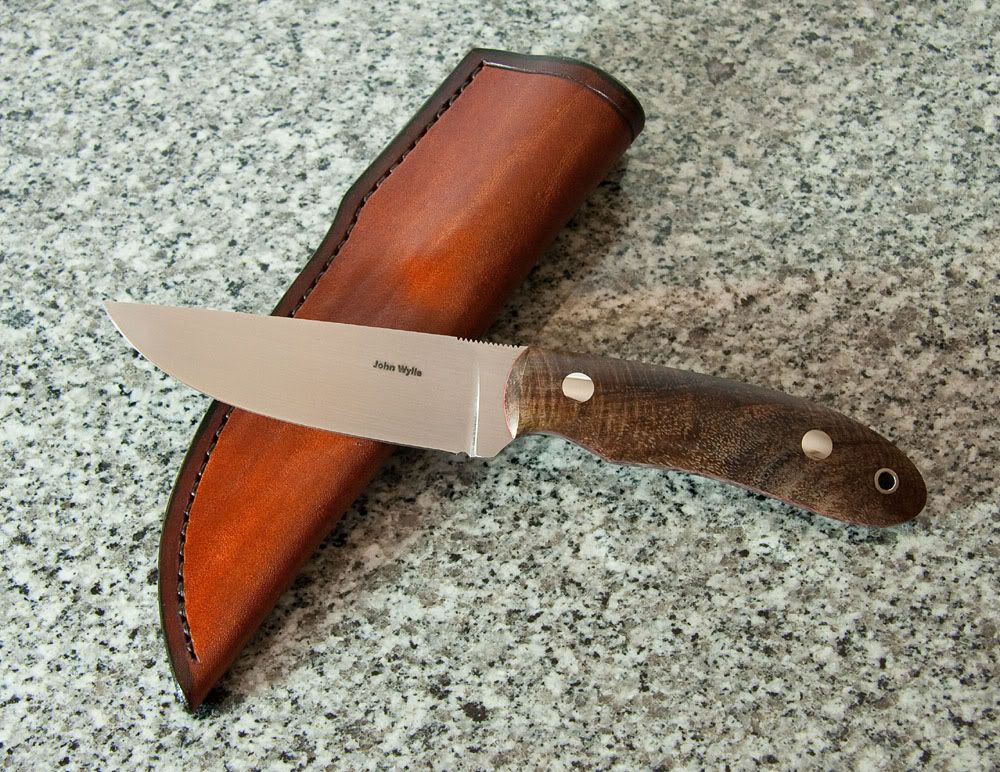

Drop point in ATS34 with Paul Bos HT, tapered tang , stabilized Koa scales with red liner , this one got a leather sheath and is headed off to France to fill an order. The Koa drop point is 8 3/8" with a 3 7/8" blade.
I love KOA
Some dislike the tapered tangs , I think it really give the knife a nice balance , and a distinct look. This one is both tapered and heavily drilled under the scales. Customer wanted a knife that was very light in the handle. Hopefully I succeeded and he will be pleased.

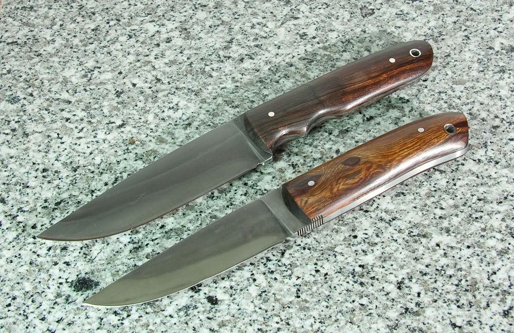

No name for this model , semi-fighter'ish style , certainly NOT tactical , ats-34 with Paul Bos HT , black G10 scales , tapered tang , flat ground. 9 1/2" oal length , 4 1/4" blade. Kydex sheath.
same knife , in 1095 , tapered tang , edge quenched , etched to bring out the temper line. Ironwood scales ( no red liners ). Leather sheath.
