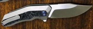

Could this knife be slippery at hand? I had this issue with similar design frame lock knives, the handles were slippery (not much texturing and machinning there). Another issue for me when the flipper tab does not have jumping, so after 10-15 flips the finger would start to slip on the flipper tab. Any flipper tabs that has over 90 degrees rightward leaning (usually at 110 or 120 degrees) design and no jimping is an issue for my fingers as I need to keep flipping open and close and open without any hesitation or issue as on my Hinderer knives...
A bit bigger choil and close to 4 inches long m390 would make this knife perfect.
Back of the knife has a curvy design, I wonder how would it feel at hand...
Overall looks great just judging from the looks.

CTS- XHP is another great option if you change steel type if it makes business sense.
Are the inlays imbedded? How are they attached?
Blade looks pretty thin too; another plus.
I'll definitely consider that steel option.
The inlays are held in without glue by the screw that holds the clip in and the pivot.
I actually bumped up the blade stock to 5/32" from my previous models which were 1/8"
Nice. All titanium body, including lock face?
Are the inlays potentially interchangeable?
Are you involved with the grinding process? It’s always good to know if you are confident in the edge and heat treat. Not my business but worth consideration.
Good luck with your sales! It’s a good looking flipper.
Thank you!
It's all ti including hardware but has a steel lock bar insert.
The inlays are designed to be easily interchangeable hence the choice of not using glue.
I design and sell my products. Production is outsourced.
Roger that. I like the interchangeable option. Lock bar inserts need to be very precise. Might be worth considering a static interface directly on the titanium.

Any idea if thread locker is being used?
I have to say, you have your own style, but your designs seem to be getting more towards usability rather than just looks. Similar overall to your past designs, but that blade shape (clip point) is on point! Lots or useful cutting edge, I like that. However it's still a chunky design, I'd like to see it slimmed down a little bit, and maybe keep the blade stock thinner? Although the grind itself is the important part, and how thin it gets behind the edge.
Still, a very nice evolution! I did like the basilisk (I believe that's right, with the drop point? Yokai was tanto I think...) I just though it was too chunky and busy design wise.
