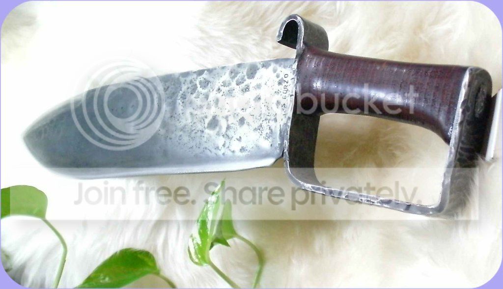

You can soak a leather handle with tung oil 3 - 4 times over a period of a couple of days and it will dry rock hard. I made one like that and it is hard enough that a finger nail won't leave a mark in it. I believe I soaked it 4 times, you could experiment with 1, 2 or 3 soakings and see if it gives you the look/feel you are after... it should definitely increase the longevity of the handle, mine hasn't changed one bit in 5 years.
Here's a pic of it, it needed a bit more sanding and polishing at that point.
