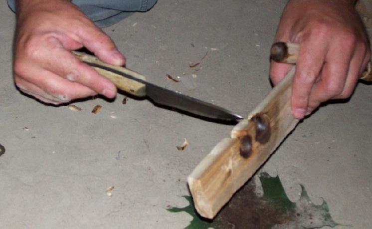

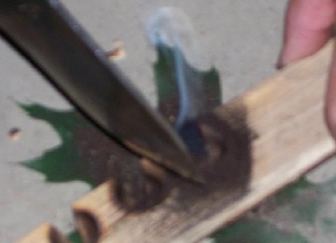

Here Rick is cutting down the shoulder on his spindle so it doesn’t hang up in
the fireboard socket

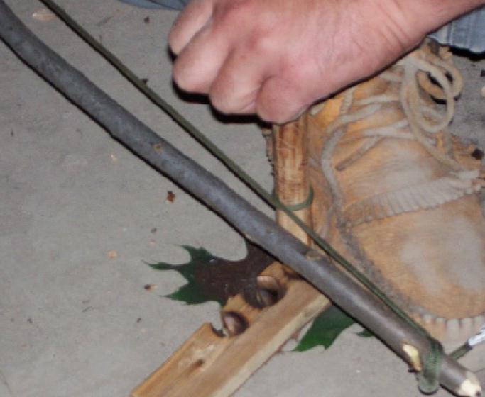

Beginning to make the fire-board socket
Fire-board socket is being burned and dust is collecting around
the spindle (dust will be saved and used as a coal extender)
Checking to see that the spindle and board are mating up properly
Socket is now burned the spindle and board are mated properly.
Cutting and the checking the notch

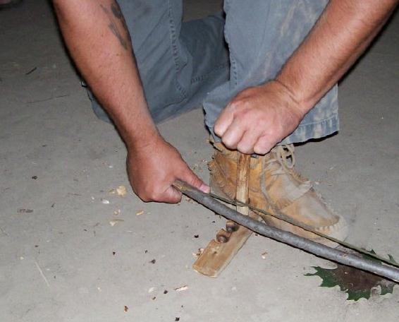

Beginning to work on a coal

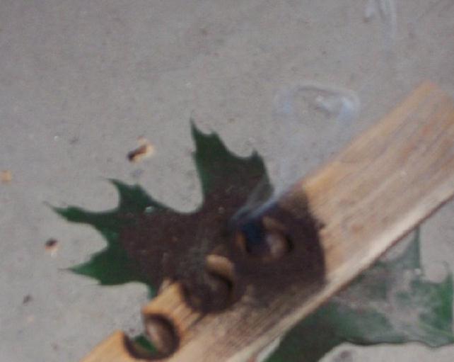

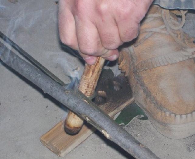

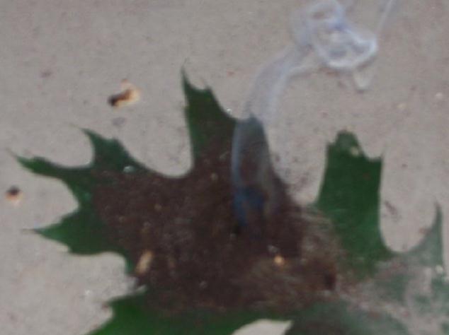

Spindle is building up major heat and a coal is forming.
Rick is pumping the bow at full speed
Checking for a coal
Coal has formed, however isn’t visible with the camera flash, you
can see a clear indication from the light wisps of smoke coming
from the dust.

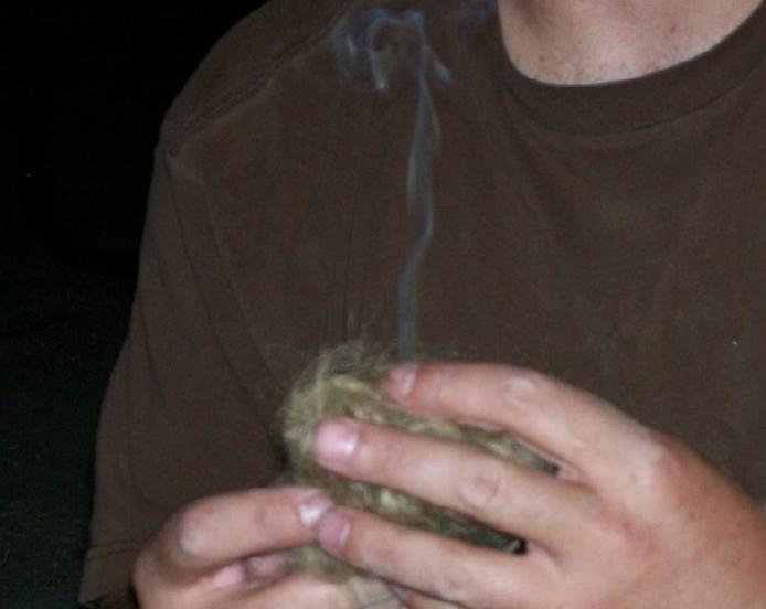

Coal is nestled in the small tinder bed and is getting larger
Coal and tinder bed are transferred to a larger bundle.
The coal at this point is larger than a cigarette heater.
Watching his coal grow

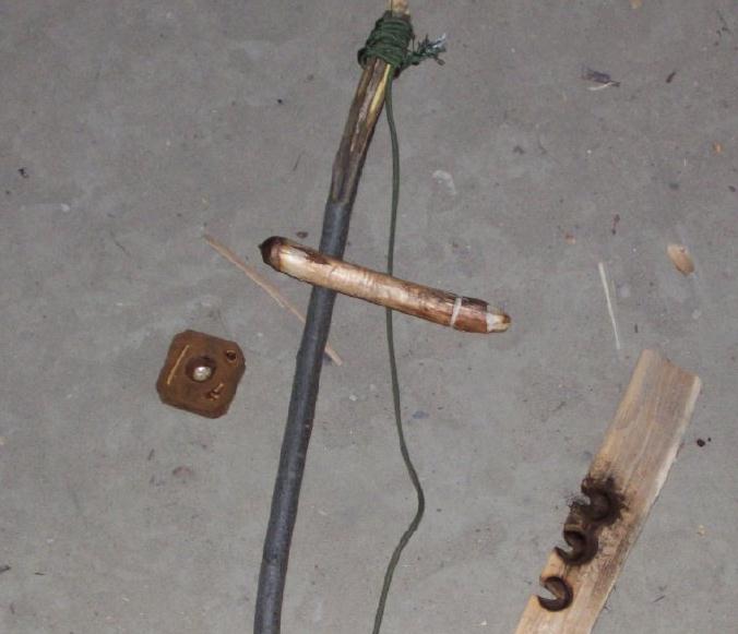

Rick’s fire-bow kit including fire-board, bow, spindle and
handmade stacked leather socket.

Thanks for sharing, what is the birds nest made from, looks like shredded jute? I also noticed that you really don't need much of a curve in the bow...interesting because it makes finding just the right bow a lot easier.

Yes that is Jute that has been pulled apart into individual fibers..
Works awesome and is a mainstay of Any firekit.
As for the curve in the bow.
According to Rick he prefers a straighter bow that is fairly stiff..

I think Rick meant by the way he made the bow, (straight)

What I meant by the bow comment was that every TBj student I've come across makes the set the same way... thumb width spindle(hand span long) and thumb width fireboard thickness(approx two thumbs wide.) And the other teachers I've had do it a bit differently. Maybe it was a silly comment.:rolleyes:
