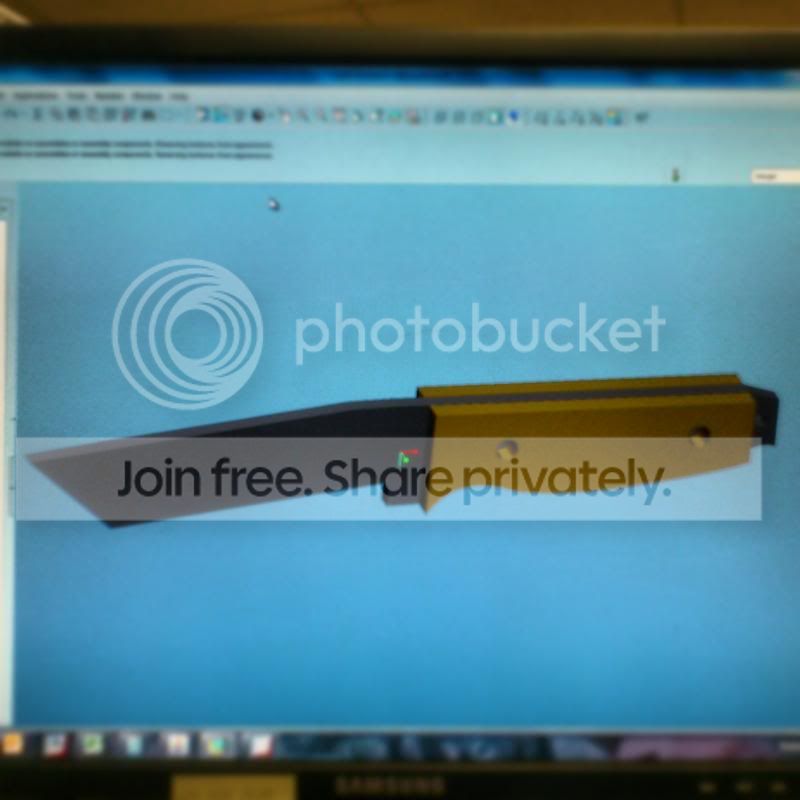

Designed as a fighting knife
9" OAL, .200" thickness
compound and saber grinds
High quality European origin D2 tool steel
Design based on simple geometry to keep piercing point in line with grip, and pull into slashes therefore increasing the angle of attack for the blade
I will be using cryo for heat treatment. As a former tool and die maker, heat treating was everyday work. Nothing scary about D2 to me...
This will serve as a build thread, enjoy the process.

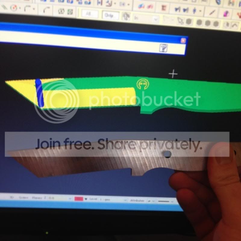

Ideas become CAD sketches:

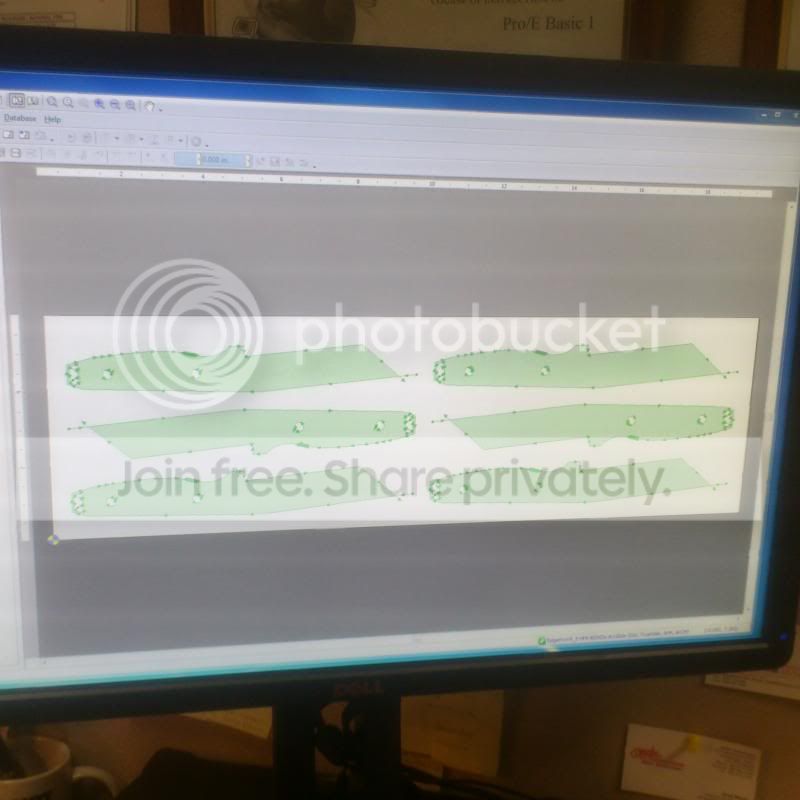

More CAD work for creating scale designs to move over to waterjet. The Micarta and G10 scales will be WJ cut, the wood will be cut by hand... time consuming.
Nesting. Can pull this together to save more material.

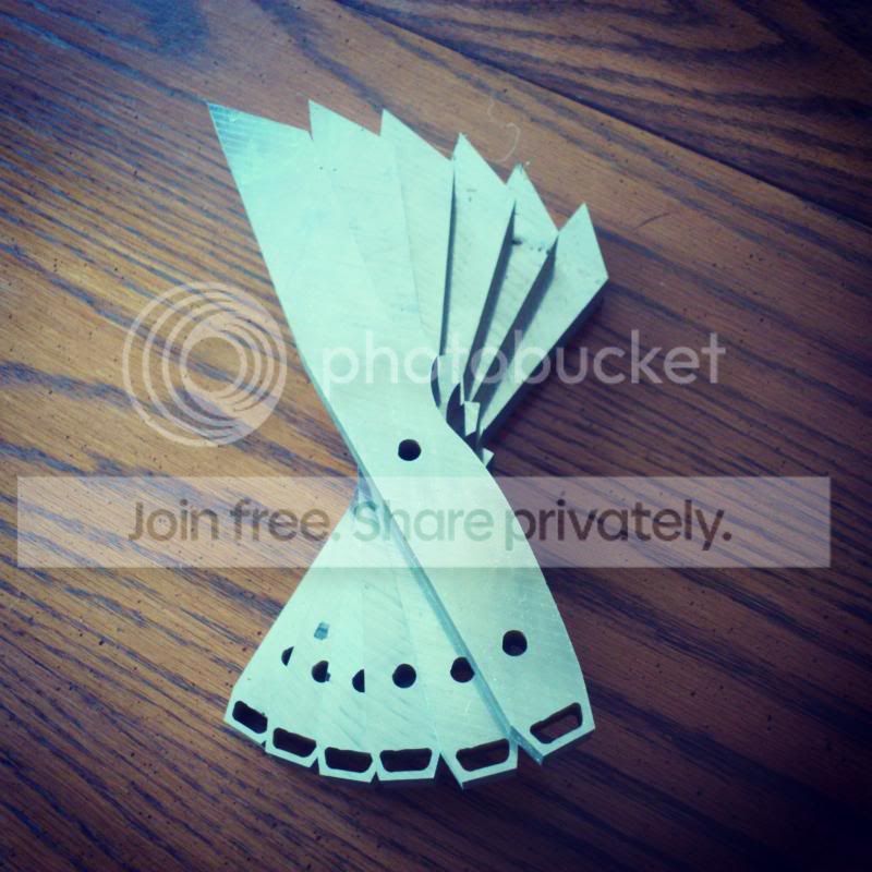

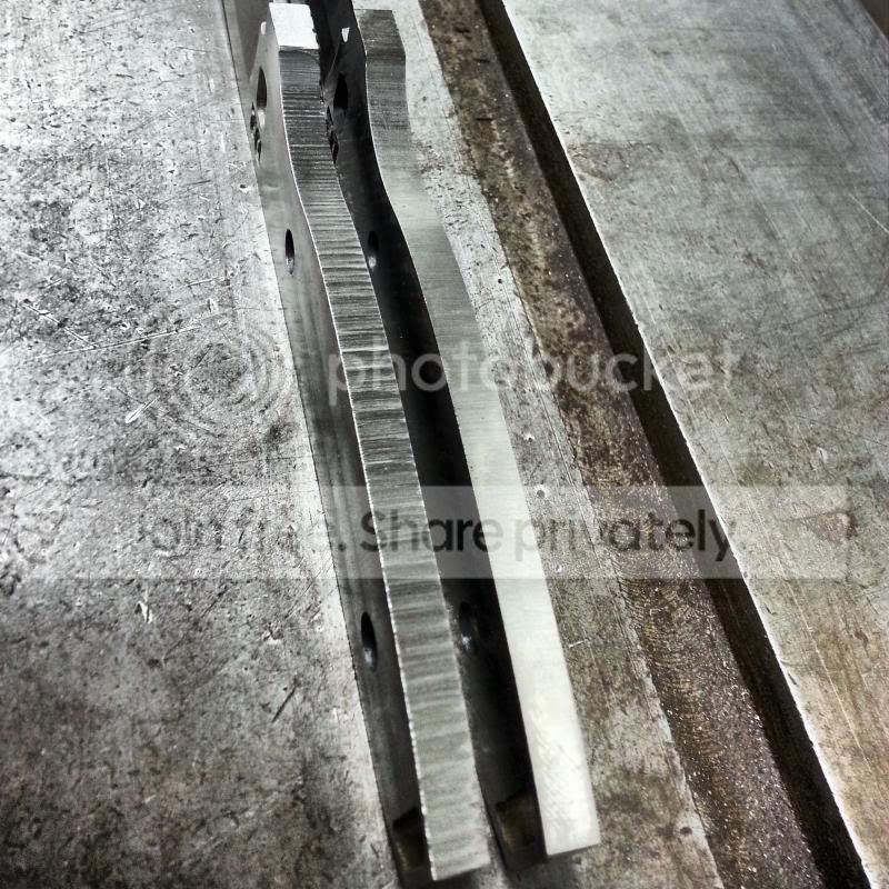

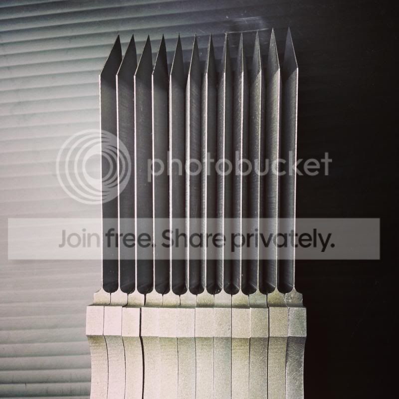

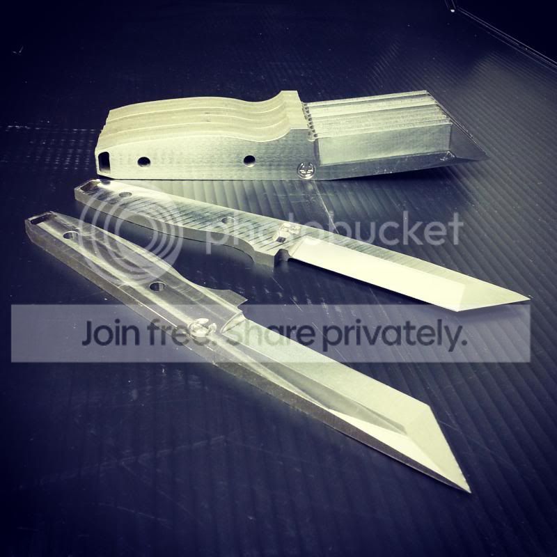

Cutting out .5" D2 blanks. these will be split via wire EDM.
Now on to Wire EDM, machining, heat treat, grinding, etc.

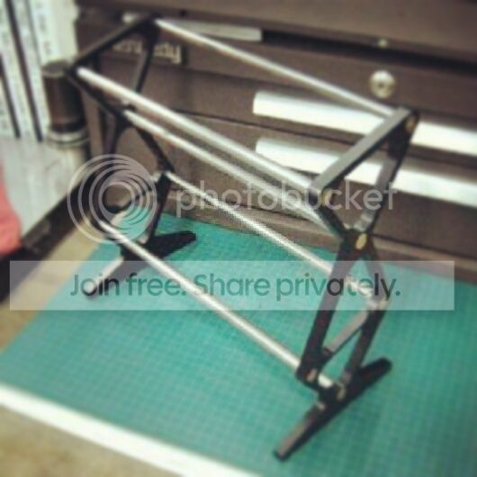

Wine rack

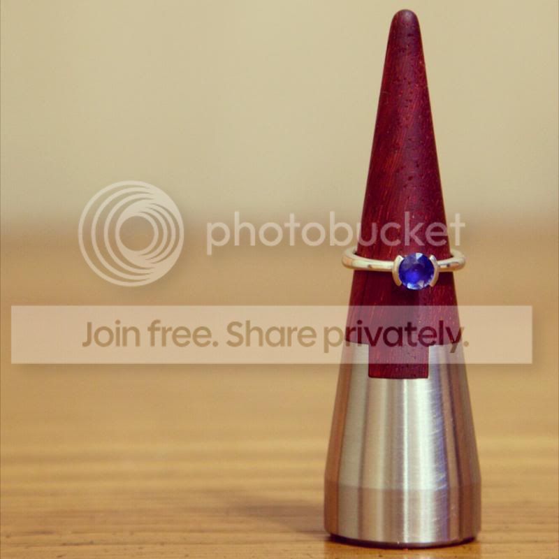

Cufflinks
Ring holder

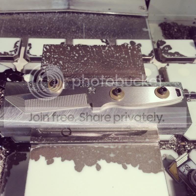

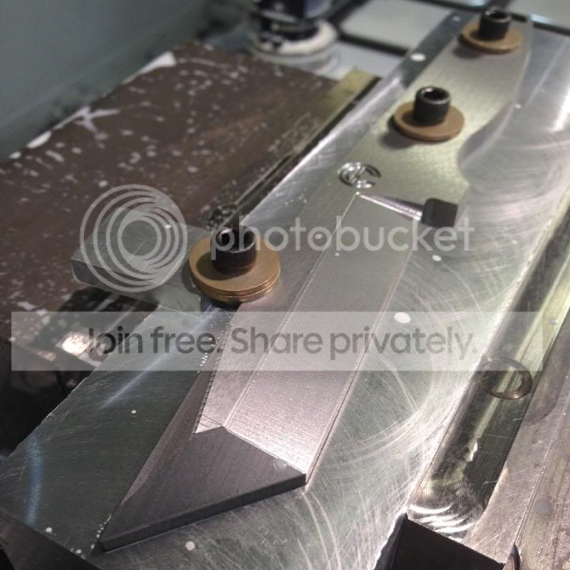

Roughing
Finish pass:

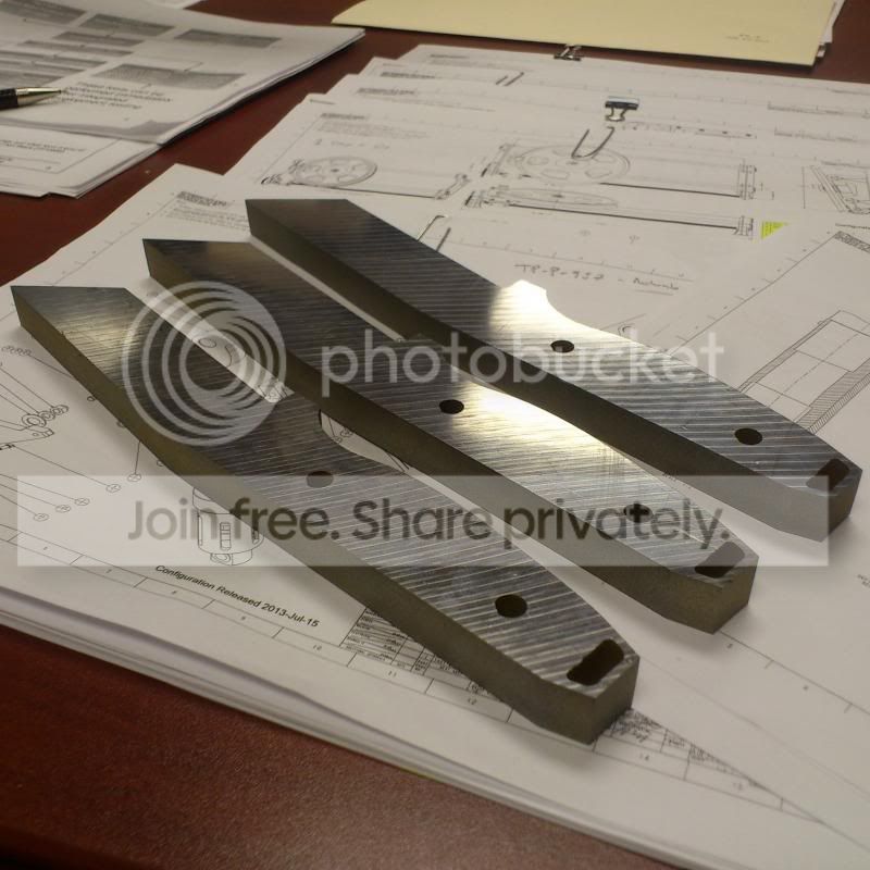

Fresh off the mill
Balance
Profiles. Will CNC these in future runs. I wanted to do half of this knife 'traditionally' for the first batch. New and Old.

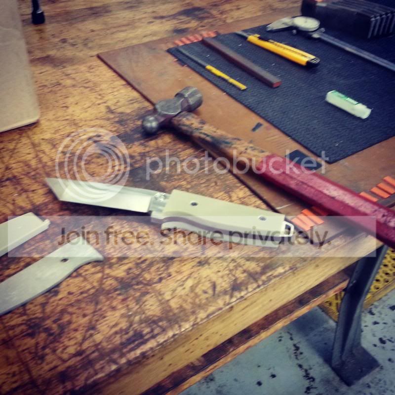

Color COUNTS. Picking handle material for duty knives
Heat treat ready

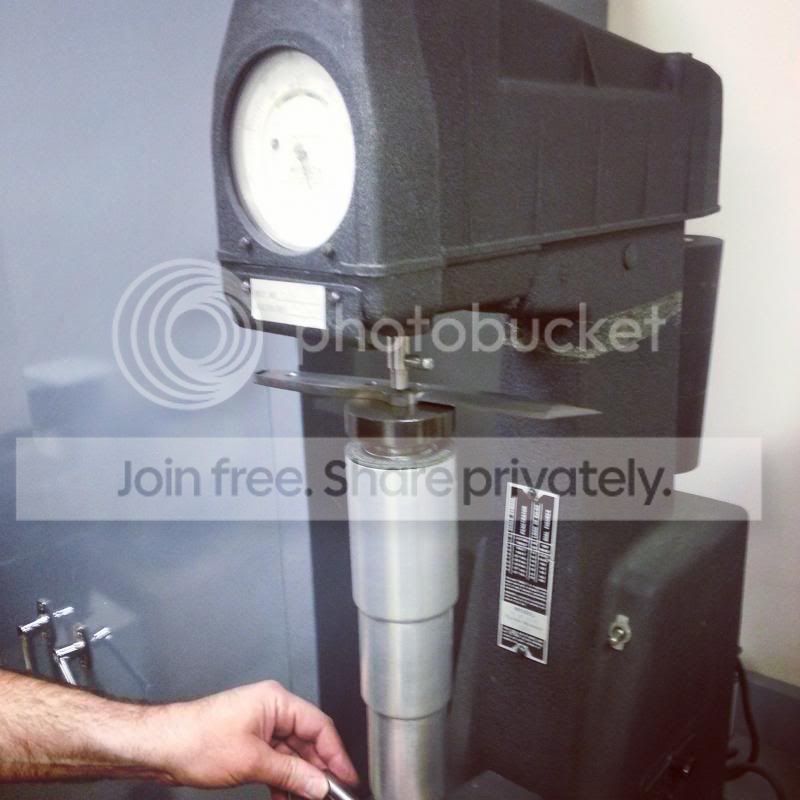

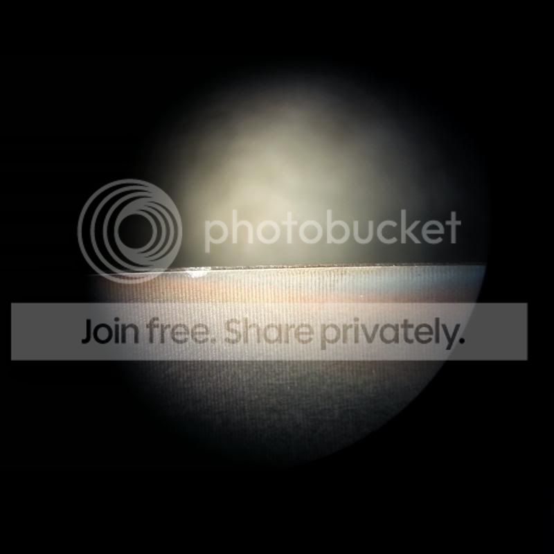

Testing QA. The magnified pic is where I impact tested the edge into 6061T6 to check for deformation or chipping.
60Rc

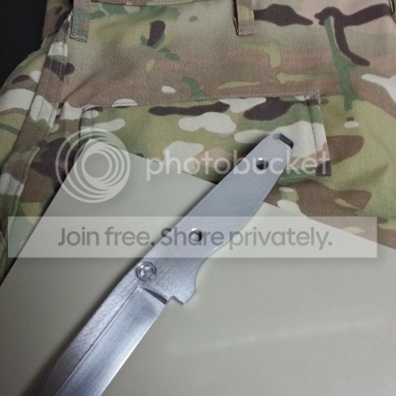

Test fitting WJ scale blanks

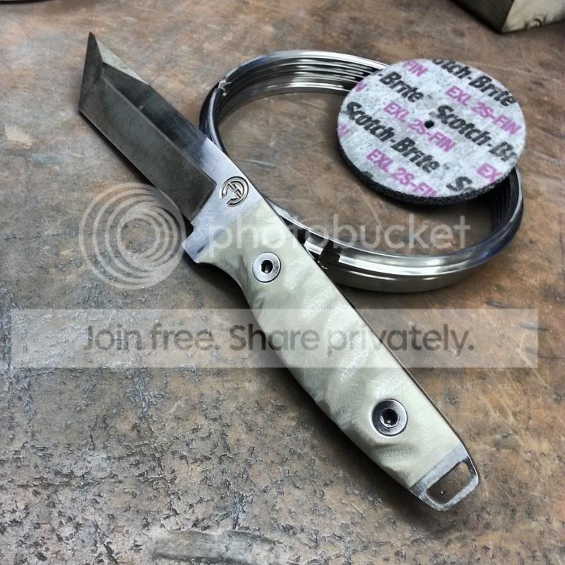

just one scale liner idea. Getting Black G10, this bronze liner, and acid dip blade
On the bench almost finished. Added some 'lines' where the index finger sits to help aid grip
Textured grip, before acid dip, edge, and blackened stainless hardware

Yea, I toyed with some ideas of keeping them .5"to mill bosses for screws and bolsters, but left that out due to heat treatment complications that would arise. Wire EDM is a handy tool.

Scales will be 4 each Ipe wood (google the stuff. very neat wood), linen micarta, and G10. the wood handled ones will be satin or stonewashed, G10 and micarta will be PVD coated. These knives will see action as some will be used in the field by "bearded men" who will return feedback for future iterations.

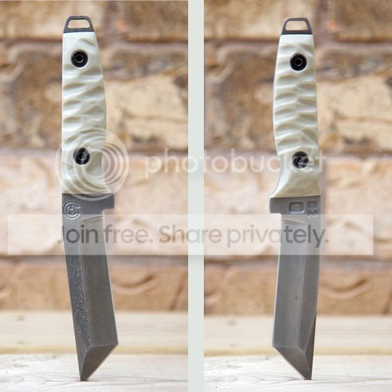

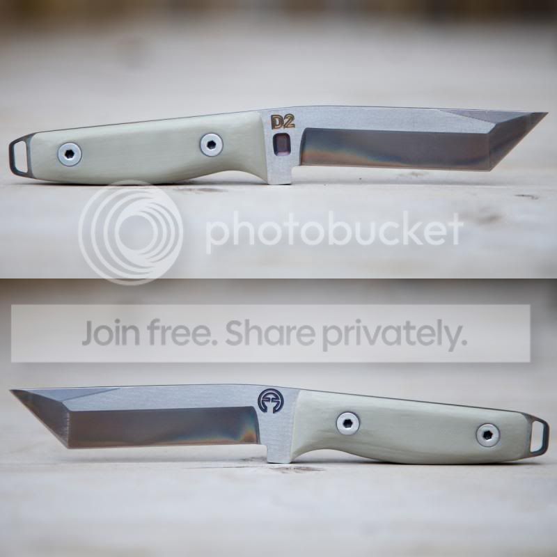

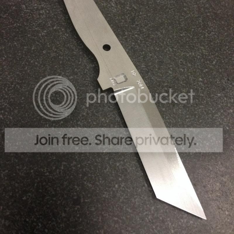

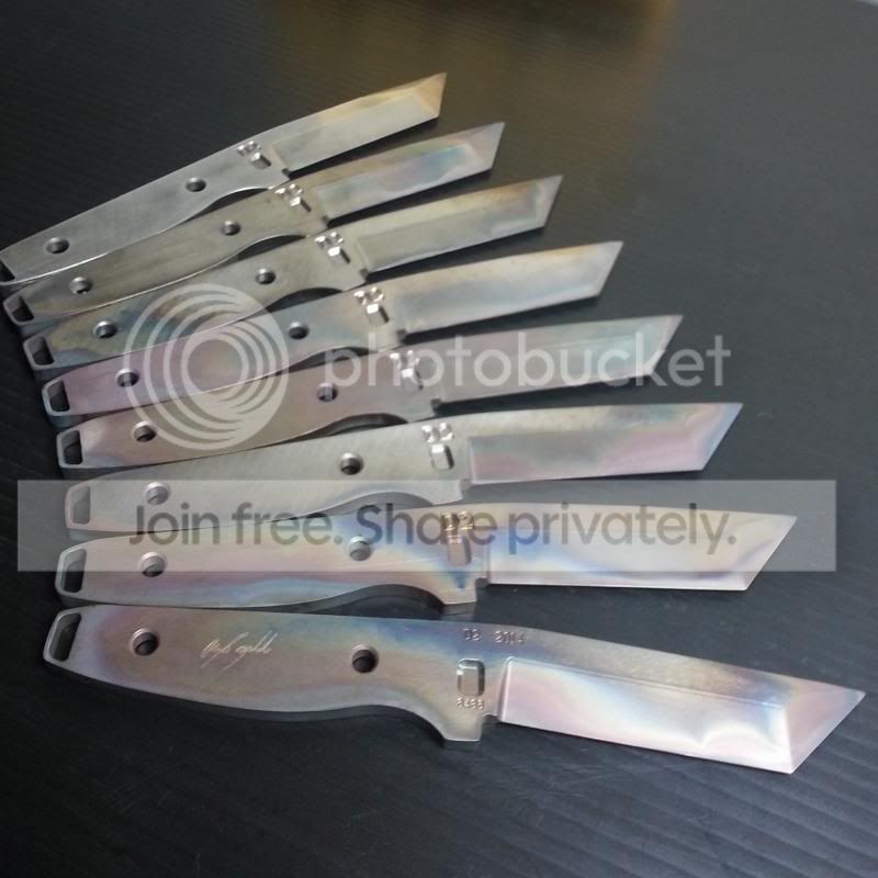

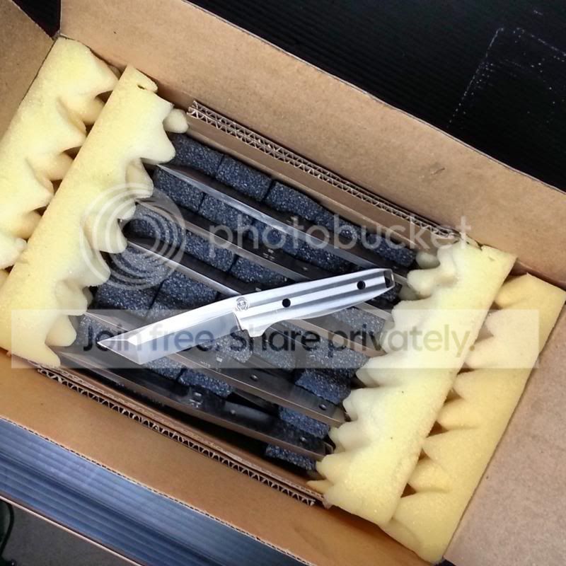

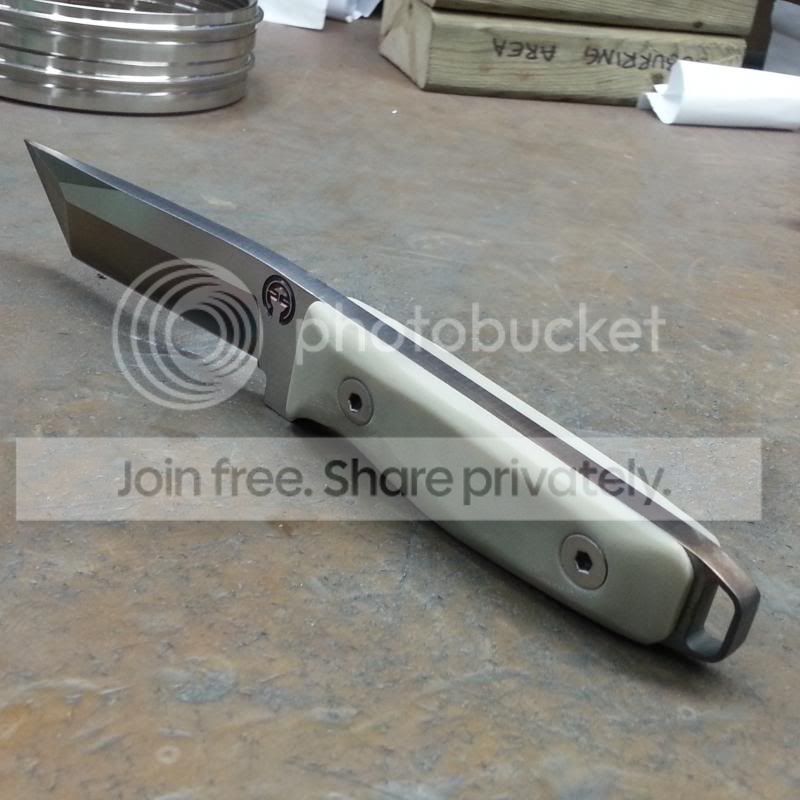

Sorry for the hiatus. I've been working hard on them in my spare time. Tooled up in the meantime, developed all the processes. Fine tuned the heat treat and created relationships with my suppliers. So I'm tooled up and ready to roll. going to be doing batches of 12 from here on out. Here's a few examples of some thus far. 10 more to come, all with different coatings (DLC, cerakote), grips (G10, Canvas Micatra, Ipe wood, etc).

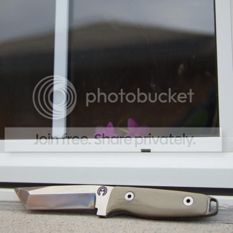

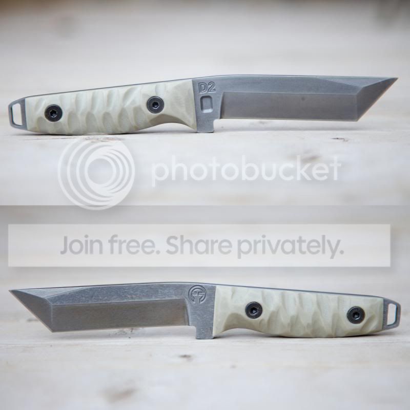

Acid wash, FR4 G10 in tan with random texturing done by hand with a rotary tool. Stainless hardware using standoffs.

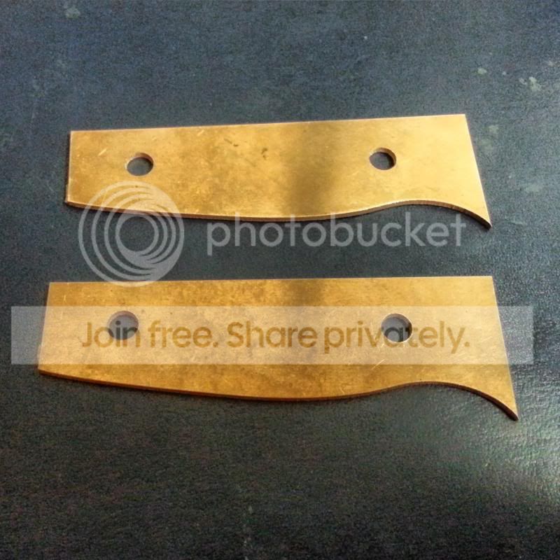

"Two tone". Flat grind and raw HT coloring. Tan FR4 G10 with smooth grip profiled with a few sections added for grip. Rotary tool and hand sanded. Stainless Hardware. I am doing two like this, one with Ipe wood scales and custom bronze hardware, this one for a collector in Chicago.
Hope you guys like them! :D
Those came out very nice. Good looking logo too.

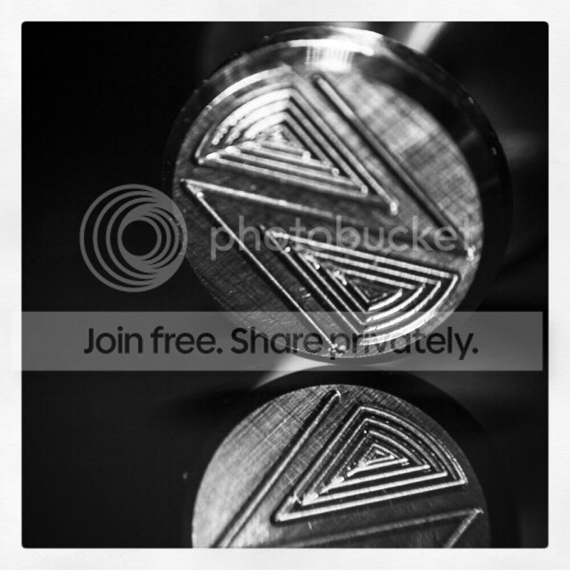

Thanks! Much appreciated. Next batch I may move it down and back about .020". some of the ones going to mil guys will have their zap numbers and year instead of the "D2" logo on the opposite side. The recess is for the kydex sheath to 'lock' into.
