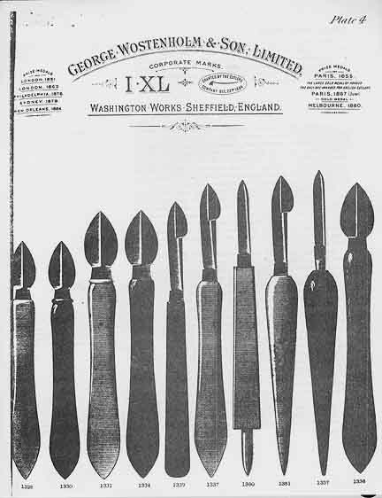

A vintage catalog depiction of some different models by IXL/Wostenholm
