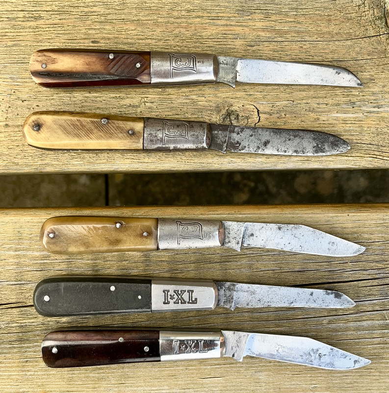

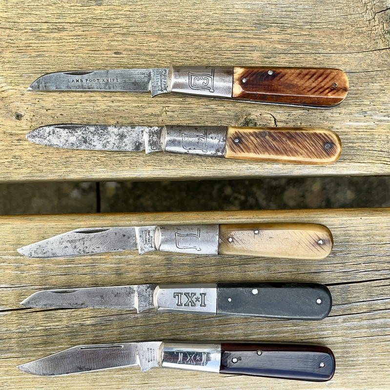

A Full House (Aces and Kings) a Quintet of Old English Barlows.
Johnnythefox
Feb 16, 2017
4,868

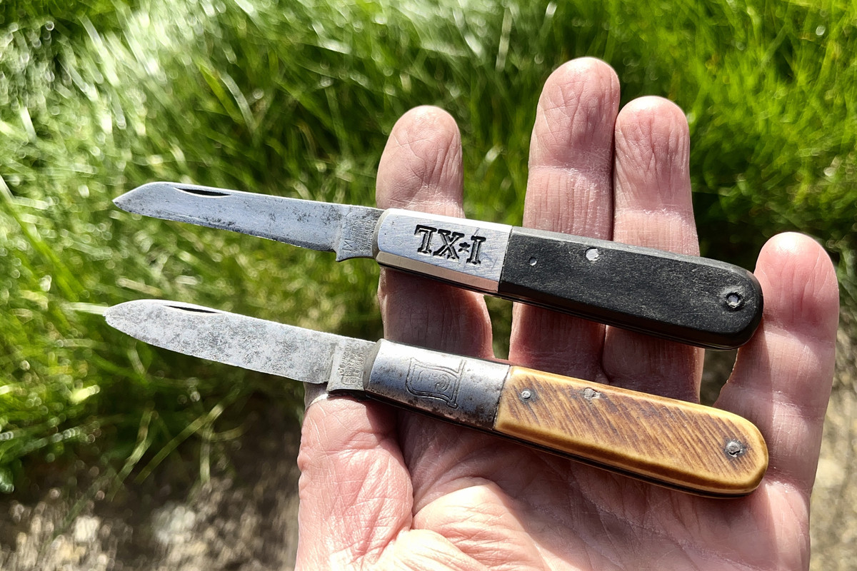

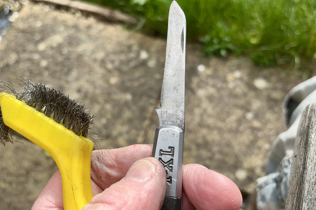

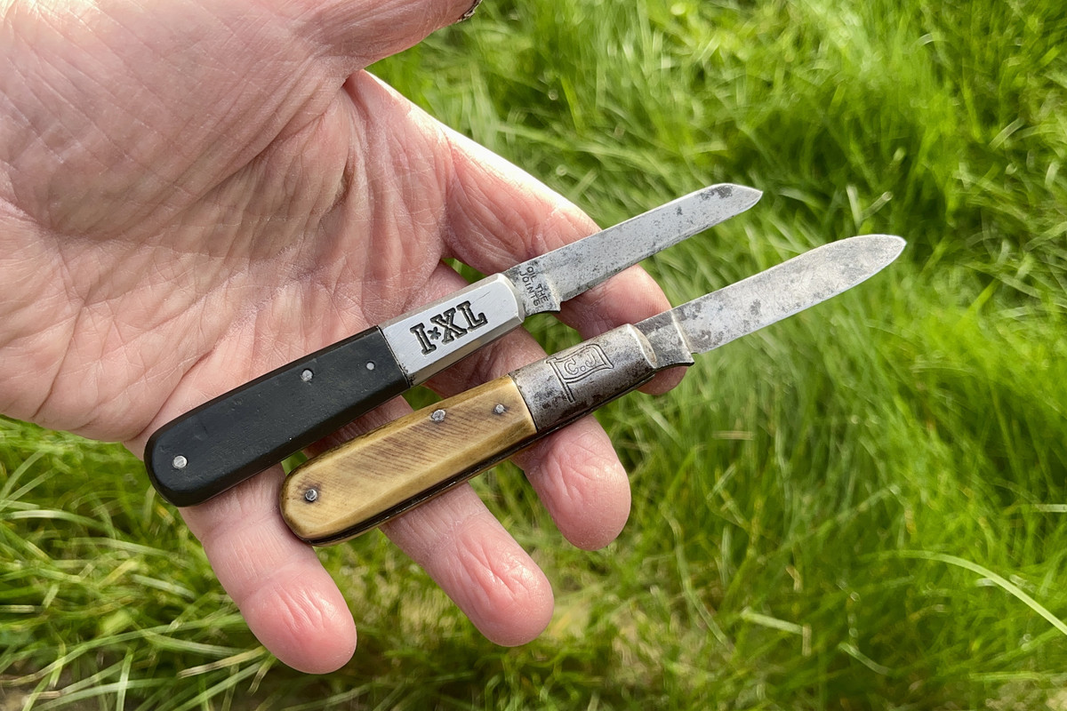

I sat in the very occasional Sun (wind blowing) in my garden today and gave a further clean and tune up of my 2 latest Barlows.
No radio, no distractions just me and my thoughts,as I am empty headed it was very peaceful. 😁

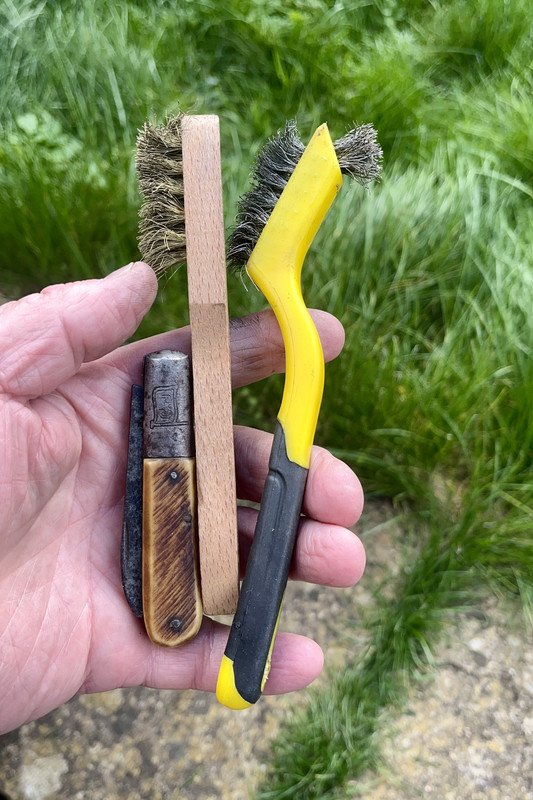

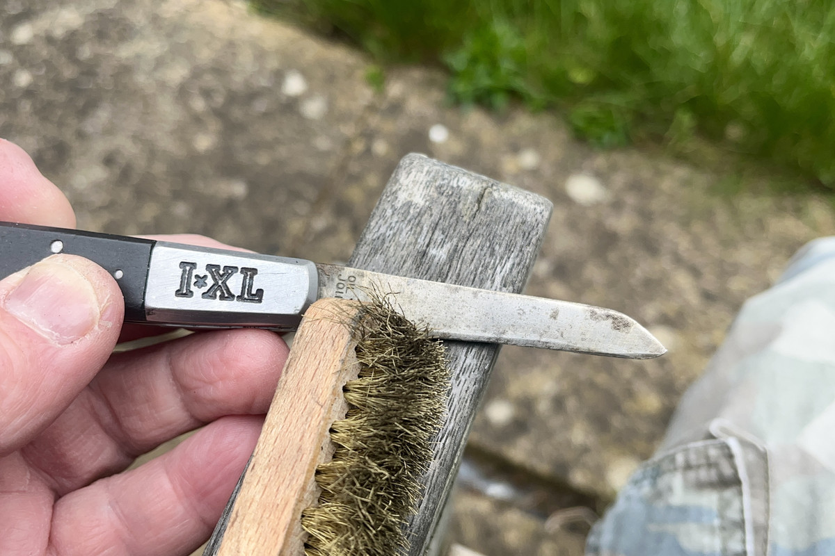

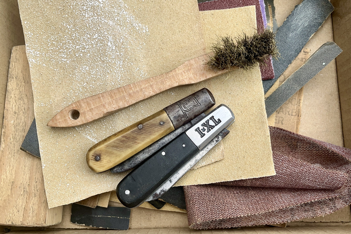

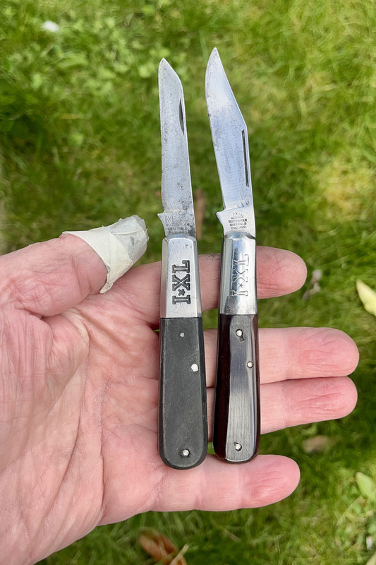

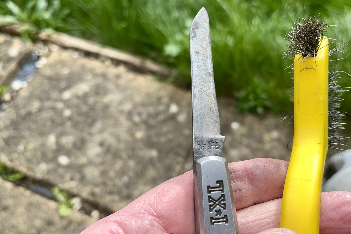

A steel brush seens to work best along with a little careful use of emery paper.

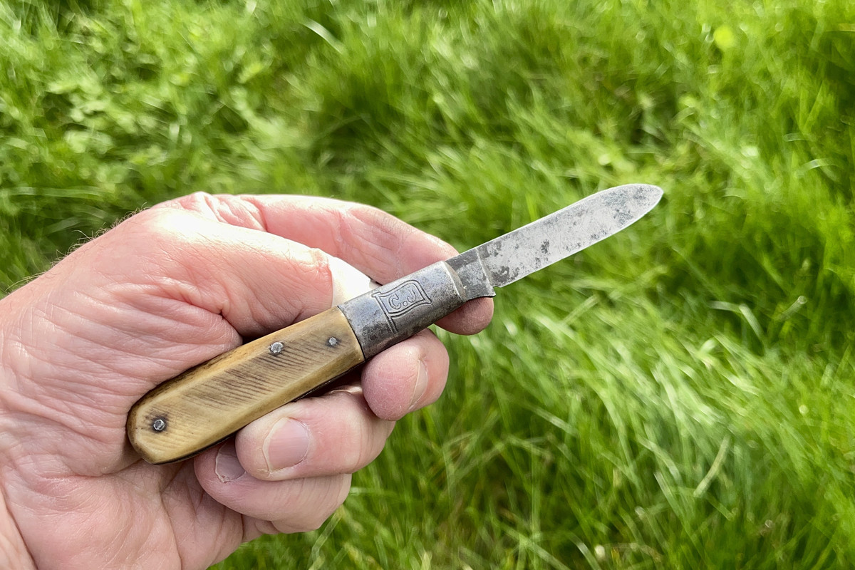

My aim was a smooth mechanism and to be able to read the tangs and improve the appearance but keep the patina.
Then I polish the steel and flush with my garden hose,finally drying with a cloth (plus the sun and wind).

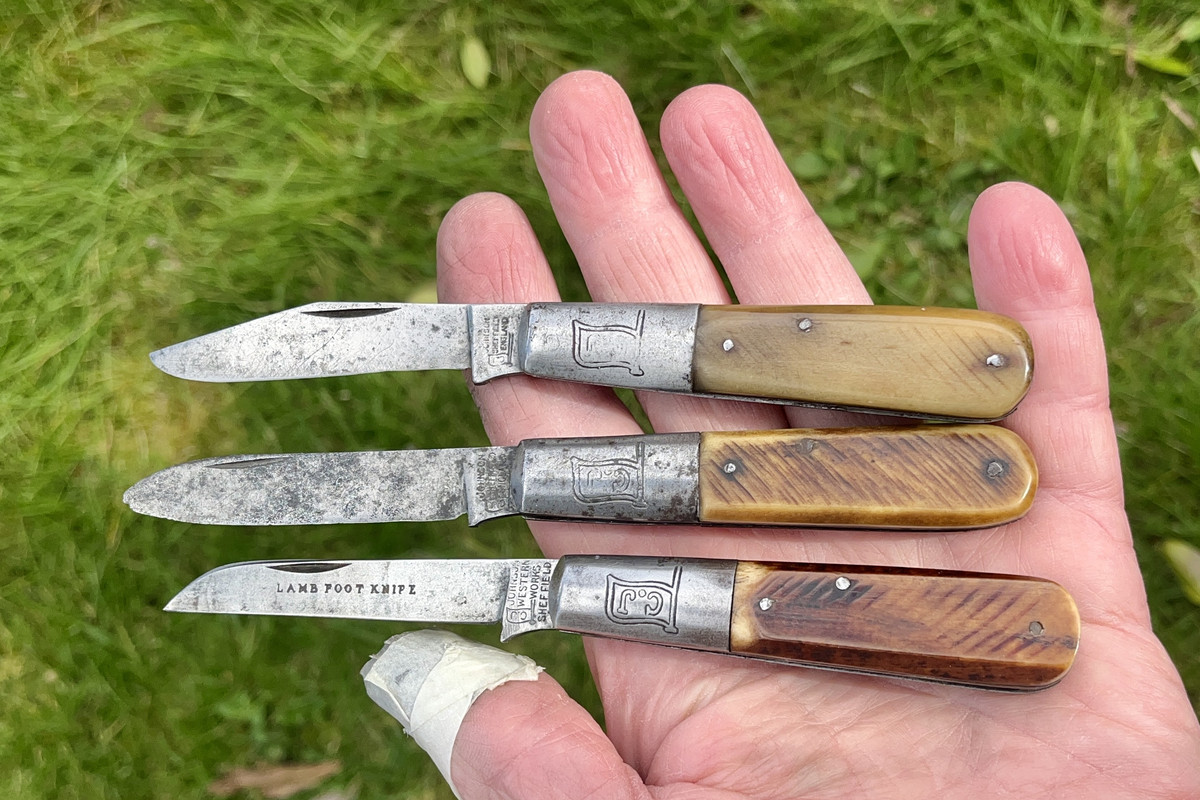

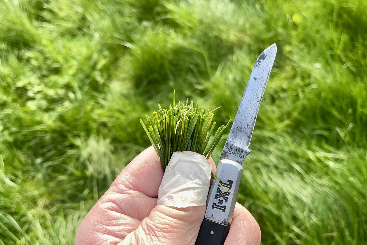

I am not good at sharpening, but these 2 where easy and took no time,yes I know some people could do better.😅

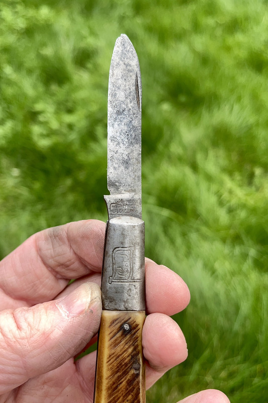

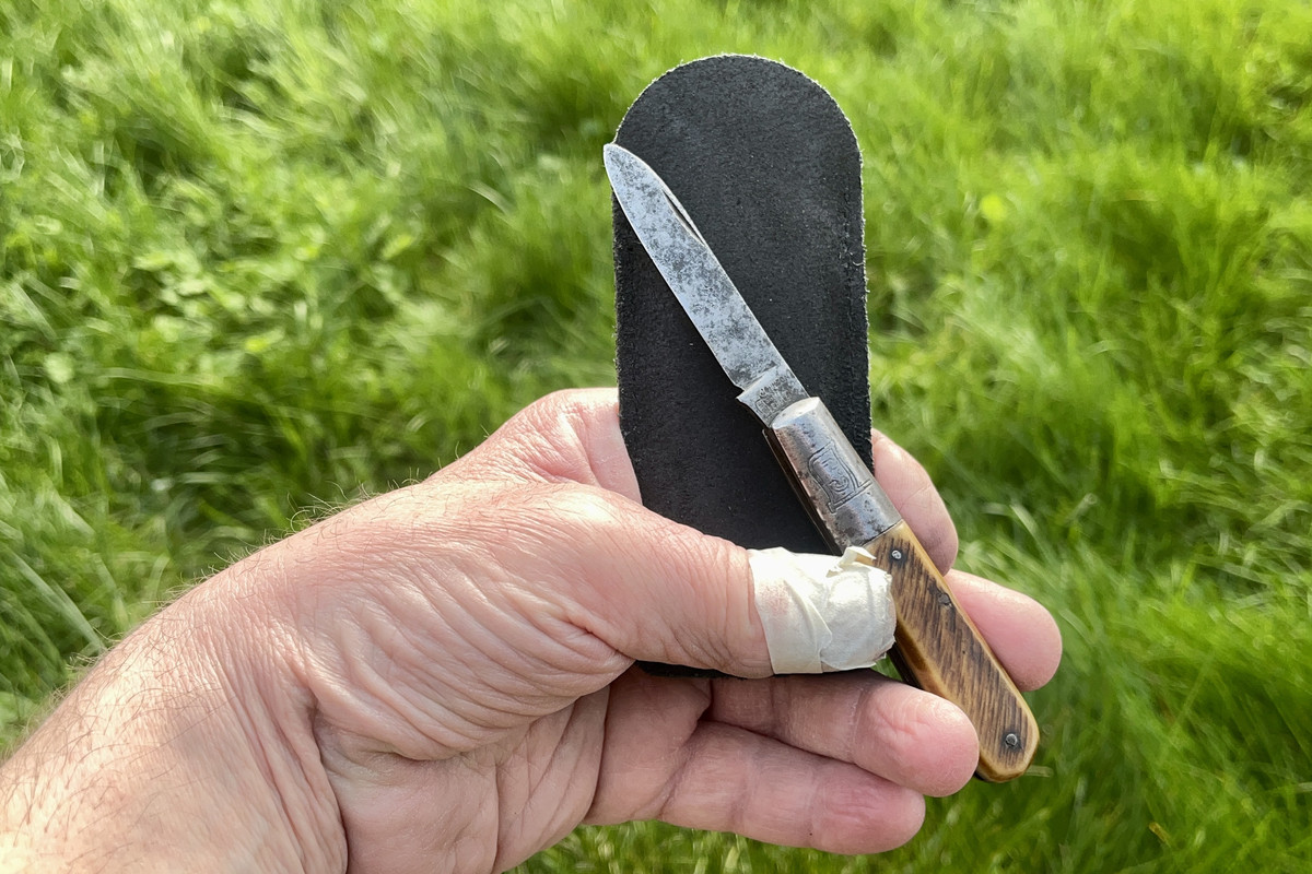

I even managed to profile the tip of the CJ blade to look as it should,It is a litle pround but not enough to cut you or worry about.

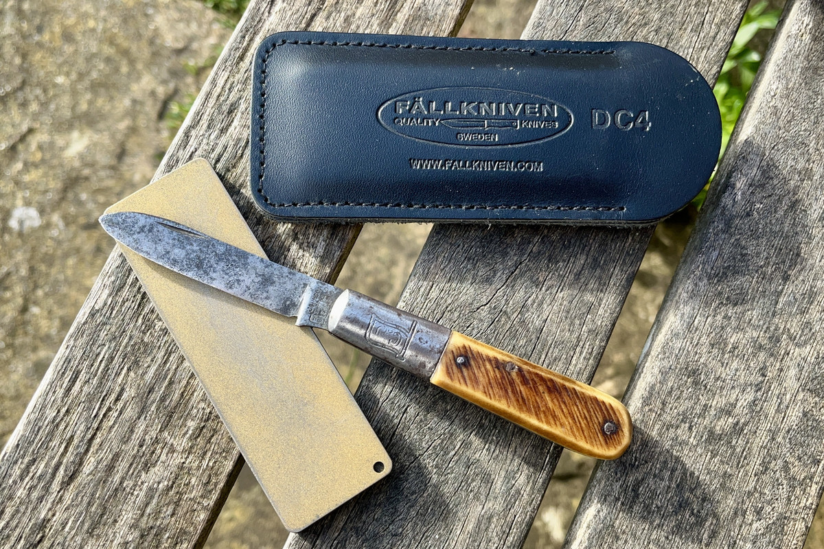

These little double sided stones are brilliant, they even put a strop on the case of the latest batch.

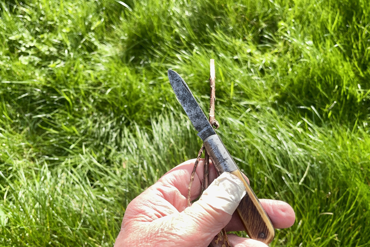

I see these as working knives to do small cutting tasks and as such these 2 though not perfect are well up to the job.
I say not perfect, but to me that makes them perfect as I like old and used that I can carry on using.
It is also interesting to see how a design that on paper is the same has so many variants.
I think I prefer the rounded bolsters, but there is bits of both I like a lot.
Check the last photos of the CJ to see how the tip looks now.

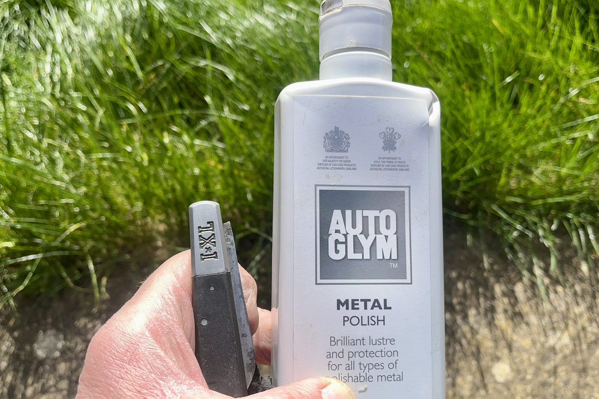

I recently cleaned up this Imperial Barlow out of my grandfather's shop. I did a thorough cleaning with hot soapy water & an old toothbrush to get out all the decades old dirt & grime. Then I took some fine steel wool & oil to brush the metal parts (bolster included) It got the metal smoothed down & kept the patina on the steel without removing it. I did wind up taking some old hotrod chrome & metal polish to the bolsters to shine them up. The final thing was just oiling the joints & putting in some elbow grease opening & closing it repetitively. It's pretty darn smooth now & takes a hair whittling edge.
