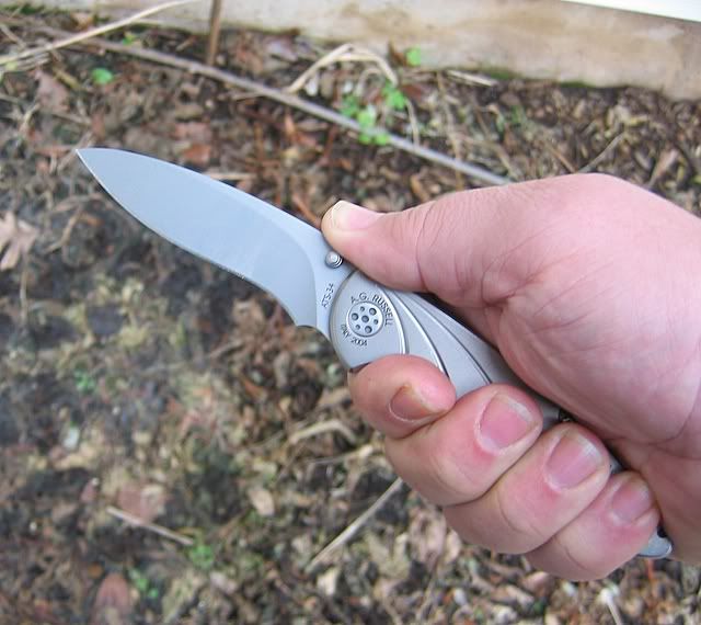

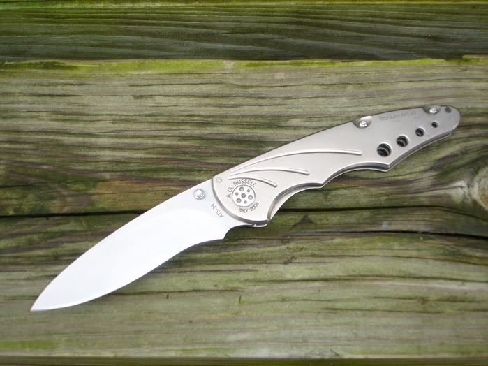

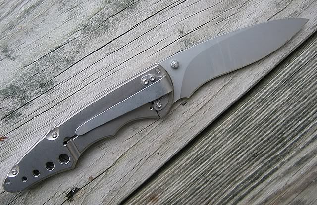

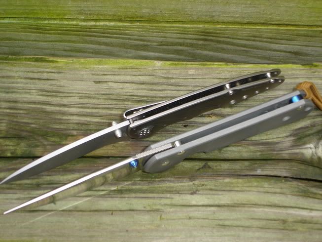

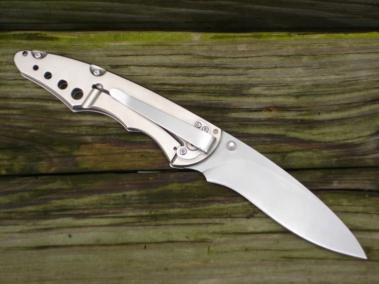

Great knife, liked it allot. It was larger than I imagined it would be but it fit very comfortably in the pocket. The blade profile was very nice and over all the F&F was good. This is my first experience with ATS-34 and I must say I liked it, it took and held an edge nicely. I used it for all the normal daily stuff like boxes, tape, letters also around the kitchen (great slicer) and out in the back yard on some small sticks etc. The handle is a nice balance between feeling good in the hand and not being thick and bulky in the pocket, the finger grooves worked well for me. I like the finish on the handle slabs, it's a nice change from all the bead balsted Ti we usually see. The only things I would like to see different on this would be a satin blade, more secure feeling pocket clip, it was kind of "loose" for lack of a better term, and bp washers. I snapped a bunch of pics by itself and with a large classic Sebenza and Spyderco Para-Military for size camparison.

I notice that your lanyard on your sebenza only goes through one of the lanyard holes. is this for a reason or just personal preference?

So did we ever determine if that's an actual finger choil or if it's just blade decor?
Looks a little dangerous to be a finger choil...could slip right off....but then again, never handled it. If it's a finger choil, I'm going to let this framelock rejoin the competition with the buck tnt and mini skirmish.

Mostly due to the length of the lanyard and I also feel it's too bulky whan passed through both sides.

I wouldn't say it's an actual choil, it's just a little too close to the edge to really be considered a finger choil IMO. I did use it as a finger choil when I had it, but it is a bit risky to do.
