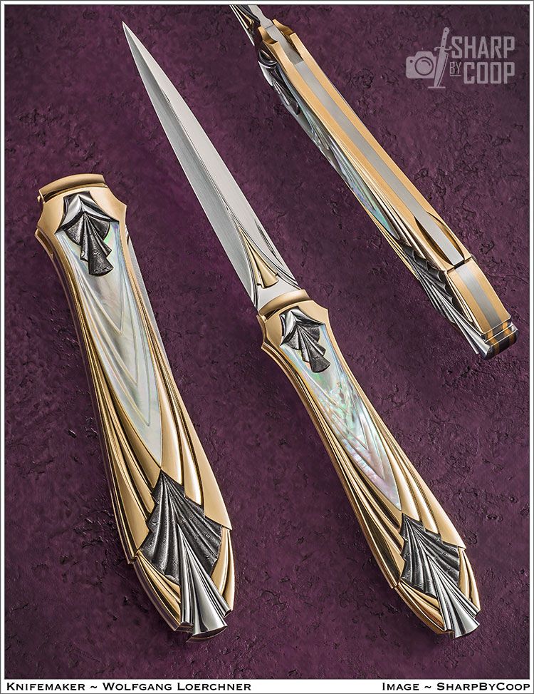

A Gold Frame Lockback WIP
Wolfe,
Really enjoy seeing some of the steps in the making of your beautiful knives. Thanks for posting this.:thumbup:

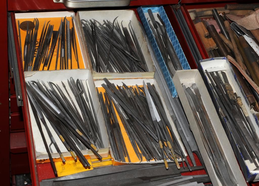

Where do you get the special shaped files to do all that intricate work if I might ask?
Thanks,
Darcy:)
The files are die sinkers rifflers. Some of these I use as purchased, but most are custom ground to fit my working method. They are getting harder to find because most of the die work is now done by CNC machines. Some of the jewelry suppliers still have them available. I pick mine up in Europe during my trips there, they are easier to find in Germany and Switzerland.

I thought I had a pretty good collection of files! Then you posted that pic. I see now what a fool I was!:D

Inspirational Wolfe. Could I ask how the inlays are secured in their pockets ? Internal screws , pushed in bezels , solder for the metal bits ?
On a scale of 1-10 defining handmade, this would be a nine. (Only if you ground out the metal with your teeth could it get any higher.) ;) LOL!.
If he had made the steel as if in a Wootz process, it would be a 10.
That said - this is very inspirational. Thanks for allowing us to come along. :thumbup::thumbup:
The inlay pockets are formed by first drilling out with a series of closely spaced holes, using a depth stop on a drill press. The holes are then connected with a carbide burr. Then files are used to work the pocket to final outline. I will try to document the process with the gold handled knife to follow the current project.
