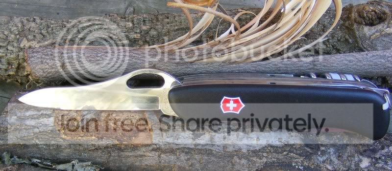

So, I was talking to Cliff N over on another forum, and he mentioned taking the serrations off the fireman model, and I got to thinking how much I would like to do the same. And well, I did it and here are some pictures.

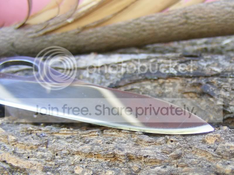

So, first off what I used first to get the rough shape in place, a Dremel with a fine'ish stone and then a 250 grit paper sander.

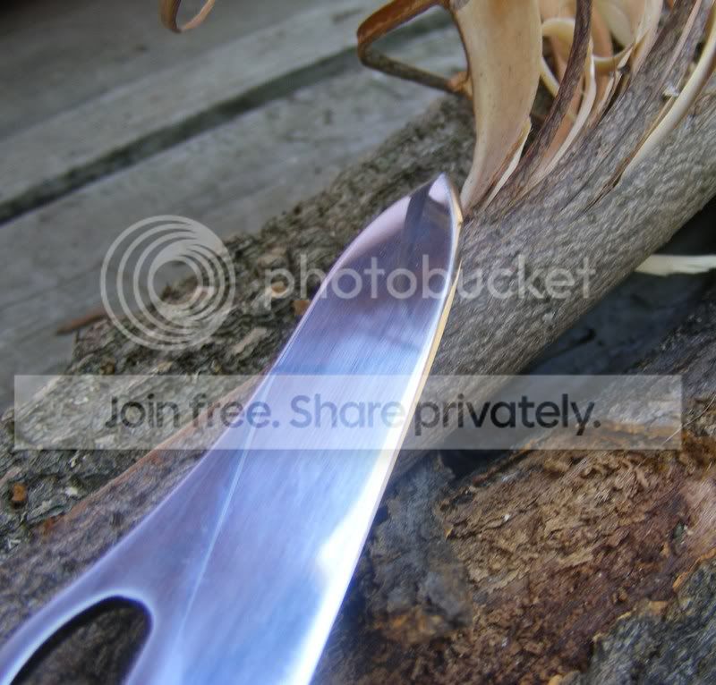

Ok, now I've gone over with the dremel and Now I go over with the drill press and a disk sander with a 500 grit paper. this gives its a nice polish and really (after a bit more work it will look nicer) dresses it up, plus this is how I get my convex edge, which it now has.
Now the glory shot, I think I've got a fine EDC going now.:thumbup::cool:
Now I'll just give it a little more work and I'll have a nice looking knife.

:o I JB welded a clip from a broken leek.
And it makes it much more convenient, I highly recommend putting one on, I did have it installed with screws, but I was worried about it wearing the plastic around the screw's and falling out.

Nicely done--I don't really like serrations. How did you prevent the Dremel from heating the blade while grinding it?

Kept it on real low, and went very slow on it.

Looks like they kept the chisel grind, or is it just the picture that doesn't show a bevel?
-RB
Its got a nice small convexed edge on both sides. wicked cutter.:thumbup:

I just used a belt sander & then cleaned it up with a leather strop.
