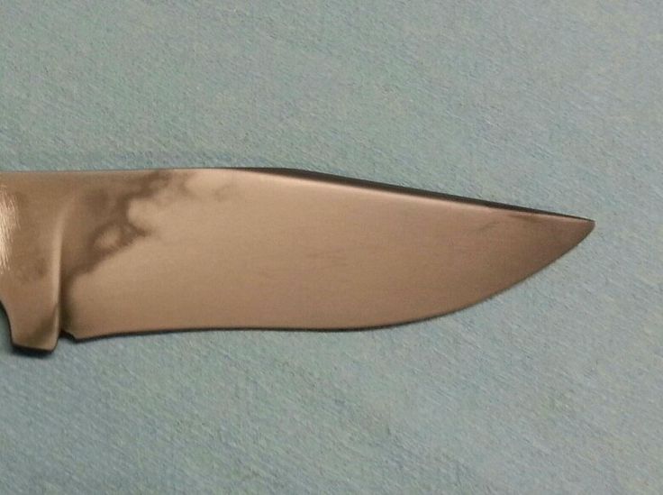

I have been using Aldo's 1095 and I love it. You can get a wide range of looks depending on how you polish and etch it also. For instance, here are two different knives in the 1095. They were heat treated exactly the same (aside from tempering temps) but they were polished and etched differently.
Low grit sanding (800 grit)with heavy etch:

Aldo's 1095. The request on this knife was a full hard blade. Blade was simply finished to 1000 and etched then wiped with 0000 steel wool. I can see that It would look really good polished up to get all the wispy action going on.
Im not a big hamon guy, but leave it like this sometimes to show how the blade is HT'd.
1095 needs precise temp control and a fast quench though. I work it almost exclusively, and am comfortable with it, but its not a beginner steel in my book.
Thank you . That is a nice looking blade and shows the heat treat action well.
