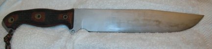

I was doing a little knife testing with a green coconut and my Busse BushWacker Battle Mistress CF got all grey!
I washed it off with soap and water and oiled it, but to no avail.
Please help!!!!

It just was surprising. I mean I was on my back porch, not in the bush, and I only cut the coconut with the blade twice.
INFI isn't stainless by any stretch, but it is surprisingly stain resistant to most things. You can do a couple things here:
1- Send it back to Busse and have them buff it out. WHen you get it back, apply some Ren Wax to the blade and it should seal it.
2- Grab some Mothers polish and go to town on it yourself.
3- Keep using the knife as it was intended, don;t sweat the patina. It's not going to ruin the blade.
Good Luck.
#'s 2 and 3, I was coming to the same conclusions.
